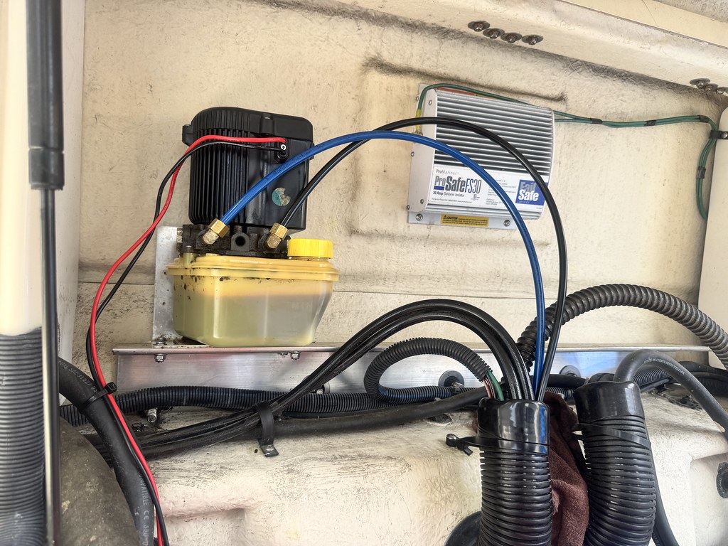

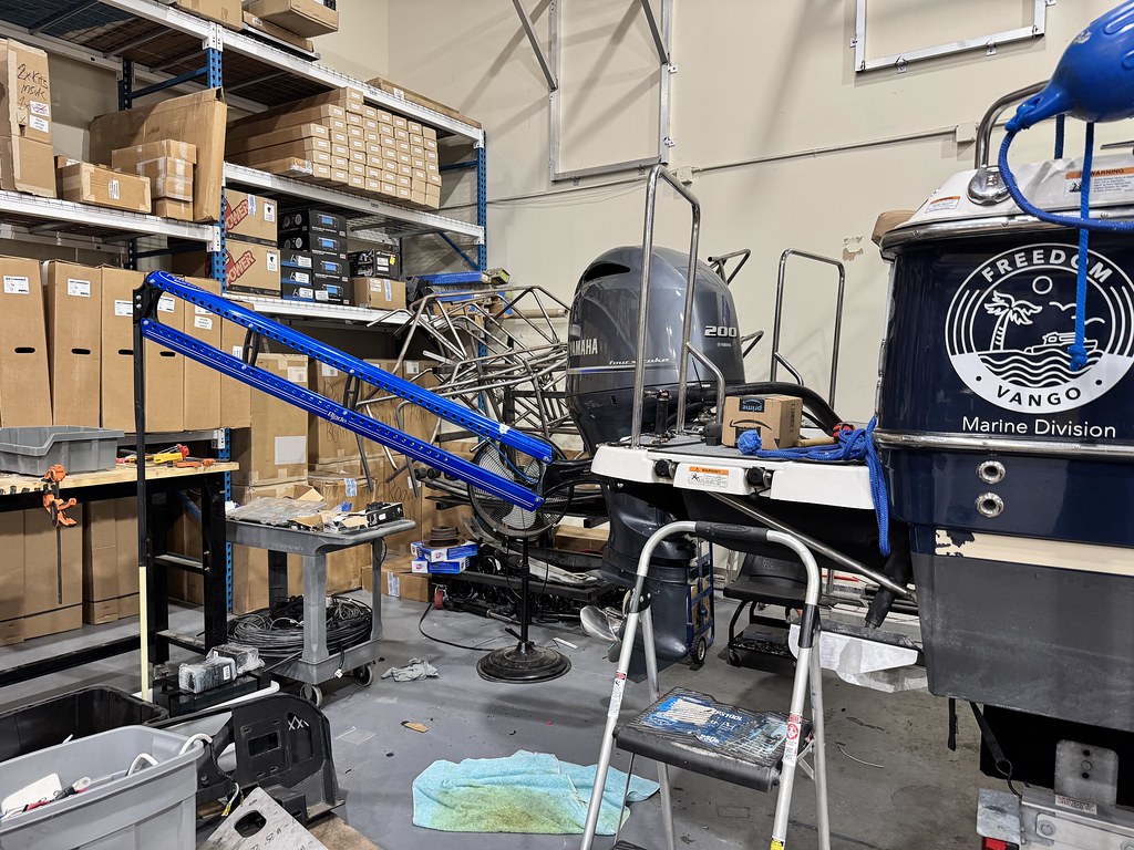

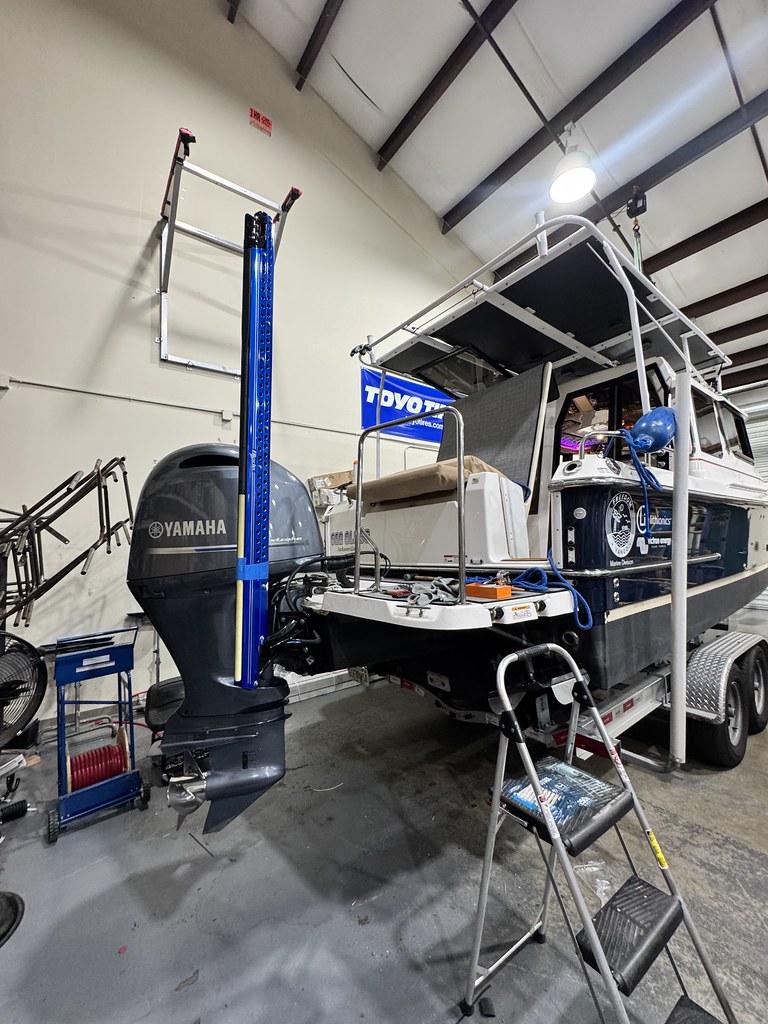

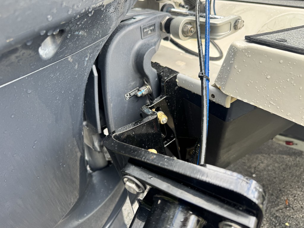

Pretty easy install overall. Had to get a new pair of hoses (got it used for 800 bucks), and order the adapter brackets.
Remove motor, install brackets, install motor, install power pole, then install pump, done!
