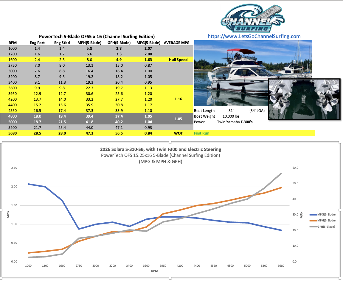

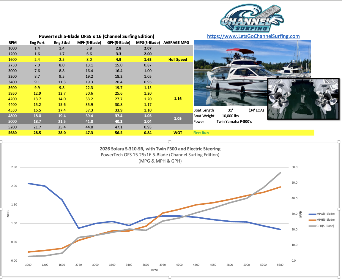

PowerTech OFS5, 16 pitch, Channel Surfing Edition on a Solara S-310-SB with twin F300's.

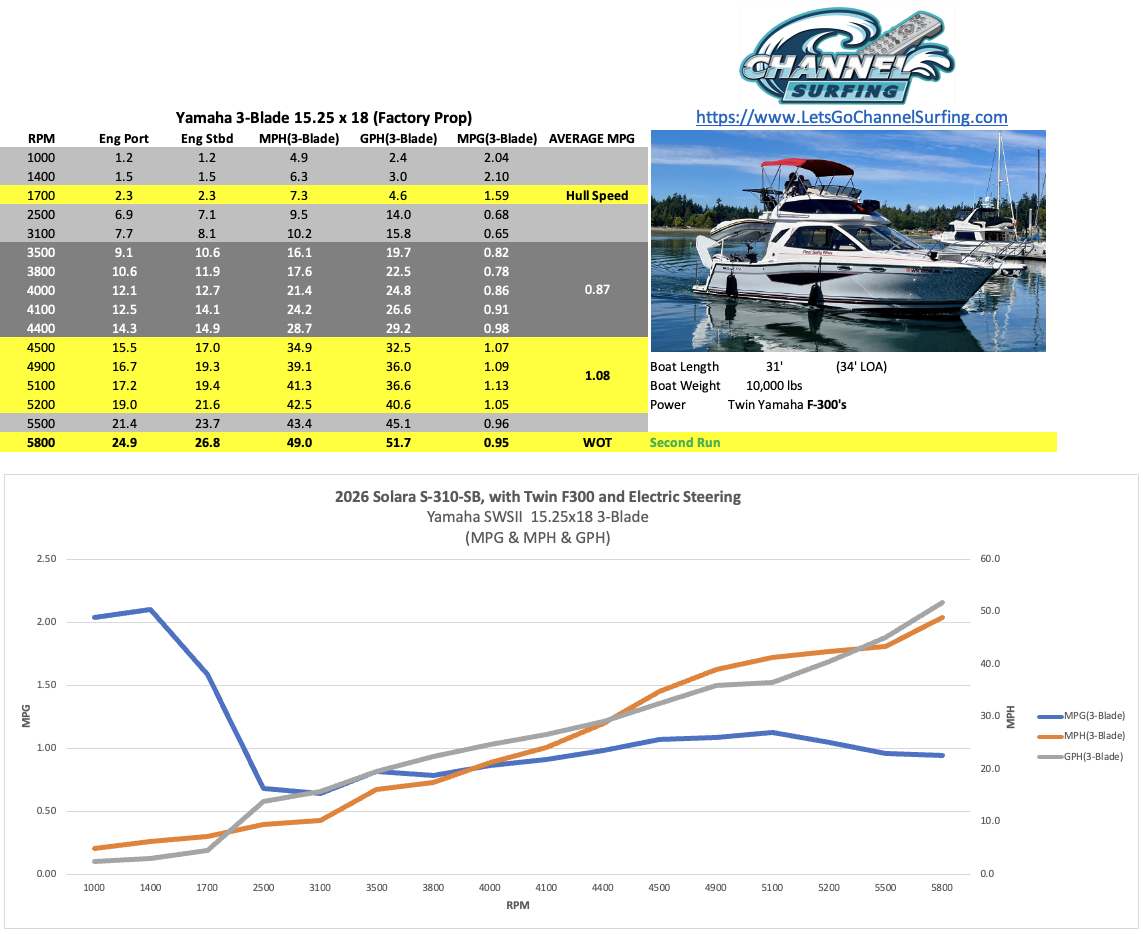

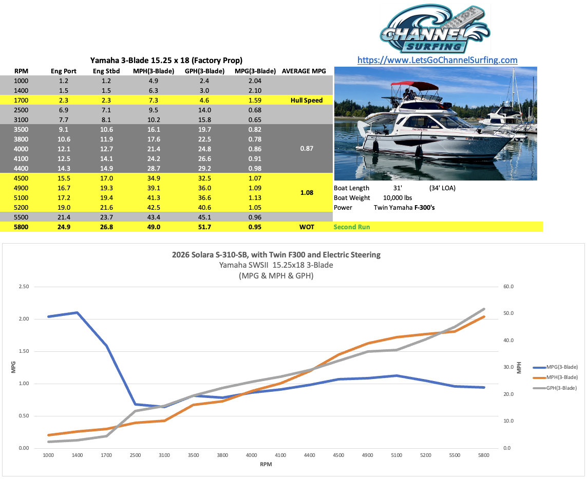

Yamaha Saltwater Series II, 15.25", 18 pitch, factory prop on a Solara S-310-SB with twin F300's.

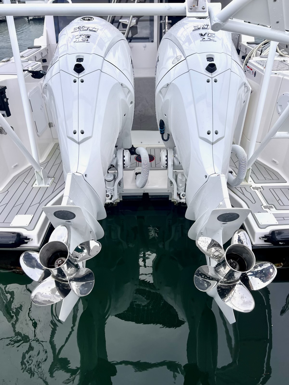

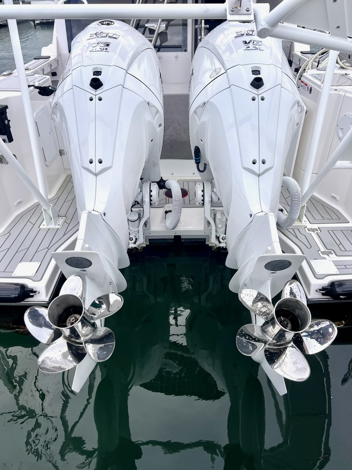

This has got to be one of the best pic's I've seen all year!! (Twin F300's, with OFS5-16 Channel Surfing Edition prop's installed).

Your graph on the 5blade is 100% accurate. We took out our C-302 with twin Yam 300's. We got the same results. I can't say how happy I am with these props. However I wished I could have tried a 14 degree prop just to see the comparison. Overall, the boat performs like a whole new boat. Out of the hole is so much faster and not having to use the trim tabs was a big surprise. Thank you to those on the forum that helped us make the decision to get these. Total game changer!
