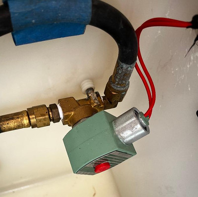

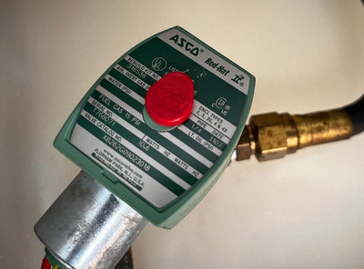

I'm building a spare parts locker or a Bahamas (Abacos) trip in May. I can't find the OEM solenoid and was wondering if anyone has found a suitable replacement that fits the mounting location in the factory provided propane locker on a 2011 R29.
CaptT":3393y2ik said:
Have you tried reaching out to these people? They are very helpful and may be able to give you a newer part number or possibly a rebuild kit.
https://valvesandinstruments.com/solenoids/asco.html
Hope this helps!!
Terry
Thanks for chiming in Terry. I have considered calling them. They seem to carry all but the 12V version of the solenoid.
You might want to try AMAZON, they carry the ASCO Red Hot 12volt normally closed solenoid. The US SOLID solenoid is a lot less expensive, not sure about the difference. You my also try BAGHOUSE AMERICA, they are a distributor for ASCO valves, phone # 1 (888) 930-6230 or Sales@BaghouseAmerica.com
Good luck. Bob
