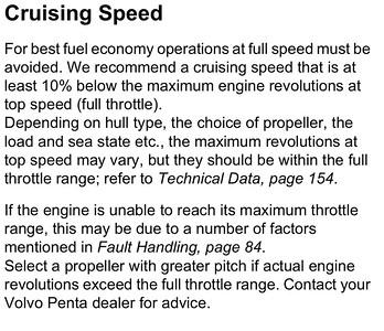

Your good question did cause me to go back to the Owners Manual....this is all one finds and I am sure that is because the propeller has a lot to do with RPM as does the condition of the bottom of the boat as pointed out.
