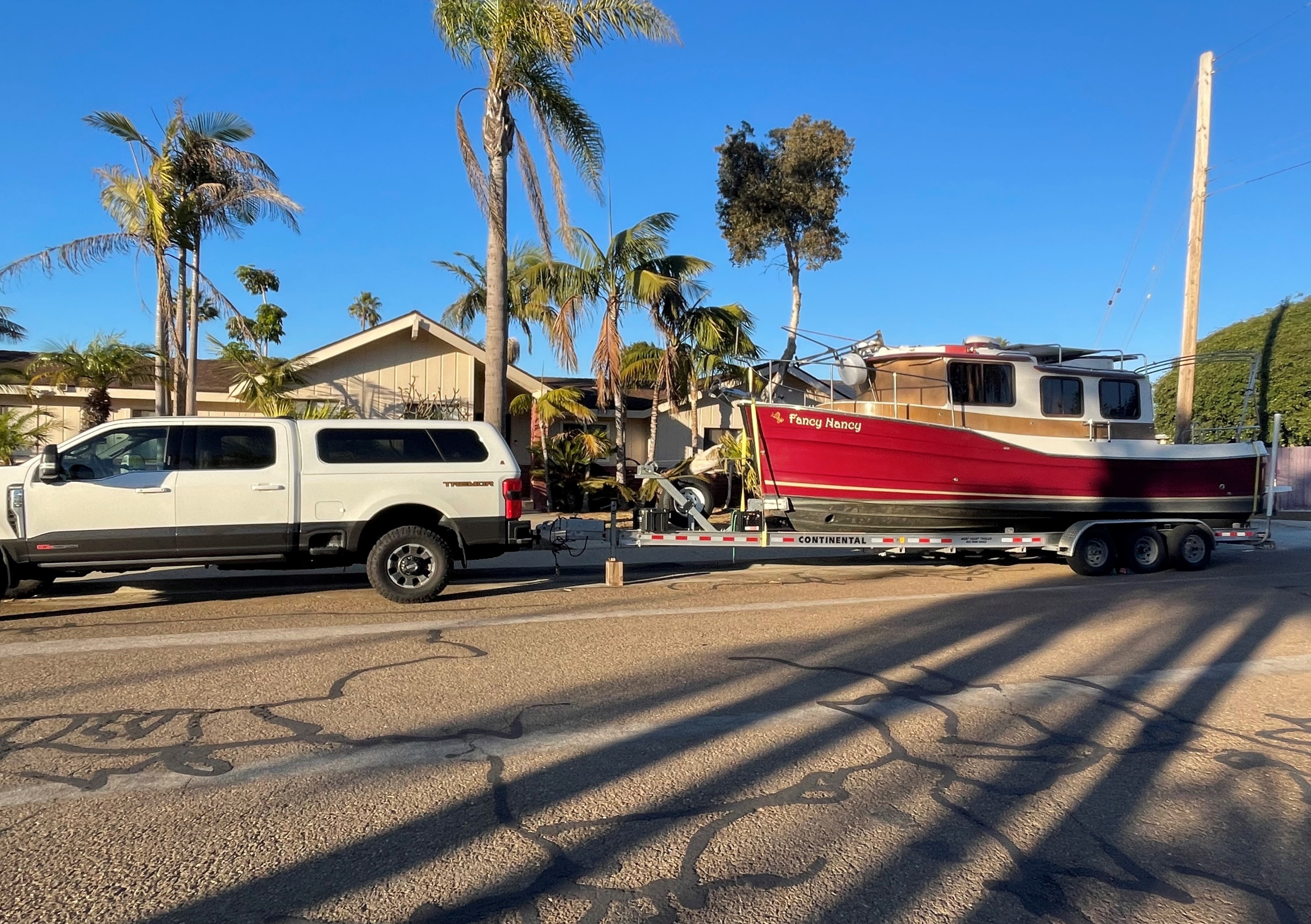

What is your typical boat preparation for a long trip? We are new to tug world but long-time blue-water sailors. Different world for us...
2011 R27 with Yanmar 4BY2-180. I lighten the load as much as possible. 1/2 or less fuel tank and 1/2 water tank. Empty black tank. The two solar panels on the boat roof maintain the house batteries so the fridge stays cold. Lower the mast/radar, I even add a small lashing to the mast between the handrails for side to side motion. Remove the bimini and secure the frame. Carry a 6 ft ladder on the swim step for access to the boat when stopped. If the truck stop or rest area is comfortable, I'll overnight on the boat. There are several favorites along the I-10 corridor. I put an insulation (bubble wrap) blanket over the windshield; under the canvas cover as protection from rocks. To secure the boat to the trailer, two 3 inch ratchet straps (Husky brand) are used; one across the stern over the cleats and one over the bow (over the anchor). So far, I have about 5k miles on the boat trailer (triple axle) towing with a 3/4 ton diesel truck from Ca to Mississippi, Virginia back to Miss, the home to Ca. I did a 1/4 of the loop. I have since upgraded the brake system on the trailer from surge brakes to electric over hydraulic so I can use the trailer brake controller in the truck, gives a bit more piece of mind when backing down a ramp. Next project is to wire the boat trailering lights into the trailer light wiring. Maybe add a camera system to the stern of the boat to see behind the trailer. It's also a good idea to clean the bilge and bottom of the boat so the watchdogs for invasive species don't get excited. Along I 10 there are no marine inspection stations, but I have seen several on different ( non boat) trips up in Northwest states.

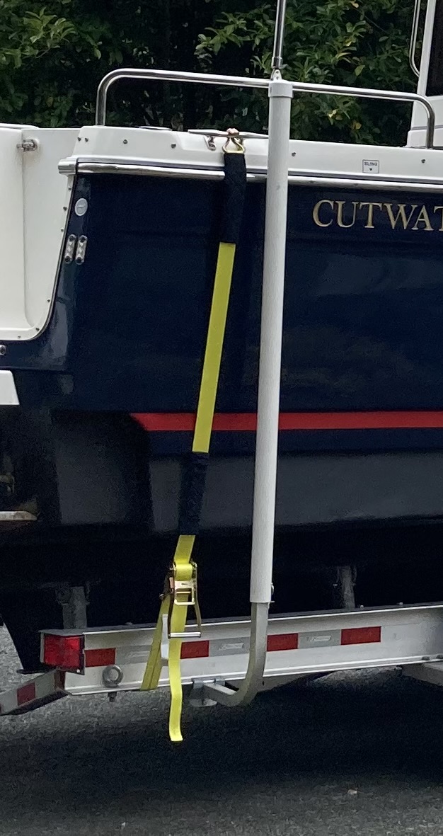

What Brian said with a few more tips.
1. Strap the stern of the boat to the trailer. We have used either strapped the aft side cleats to the trailer frame
or we the use one long strap going side to side to the trailer frame. I use cut out wash mits to protect the boat gel coat from any strap rub.
2. Secure everything inside the cockpit and cabin. You won’t believe how much the contents can get thrown around on rough roads.
3. Obvious but make sure all vents and side windows are closed and locked.
4. Lock refrigerator closed.

1. Strap the stern of the boat to the trailer. We have used either strapped the aft side cleats to the trailer frame View attachment 28175or we the use one long strap going side to side to the trailer frame. I use cut out wash mits to protect the boat gel coat from any strap rub.
