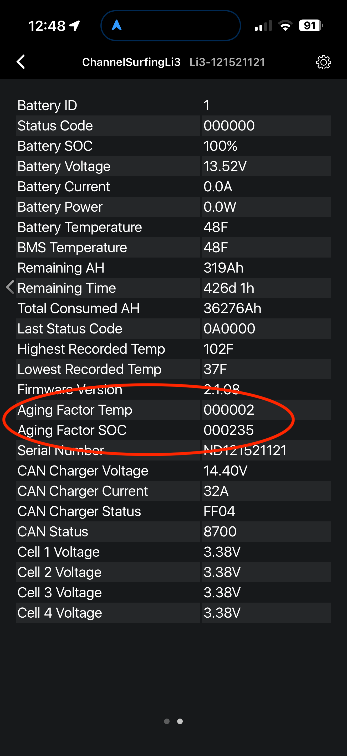

The bigger risk most people don't think about is leaving LFP on a battery charger continuously. That will reduce capacity over time, I've read up to 20% reduction with enough exposure. My Lithionics battery has two BMS aging counters that directly (negatively) affect warranty replacement value. One tracks heat exposure, close to zero for me since I run an outboard in the PNW. The other tracks Aging Factor SOC, which increments the longer the battery stays plugged into shore power near full charge. Getting it off the charger stops that counter.

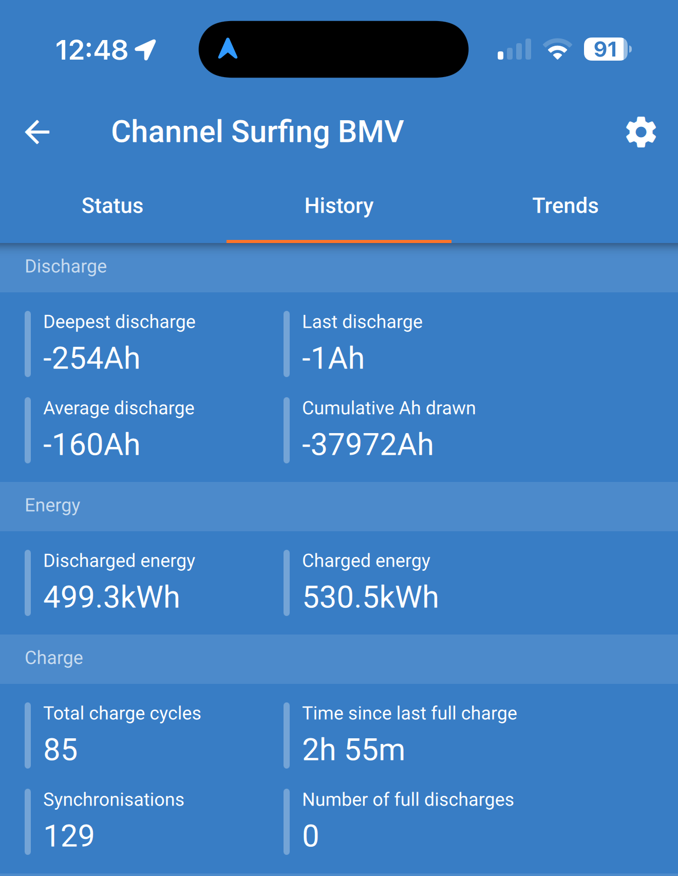

Four years in, my BMV shows 85 cycles. Average discharge is 160Ah out of 320. Deepest discharge was 254Ah. AGM gets 300-500 cycles. LFP is rated for 2,000+. I'm a long way from worrying about either number.
