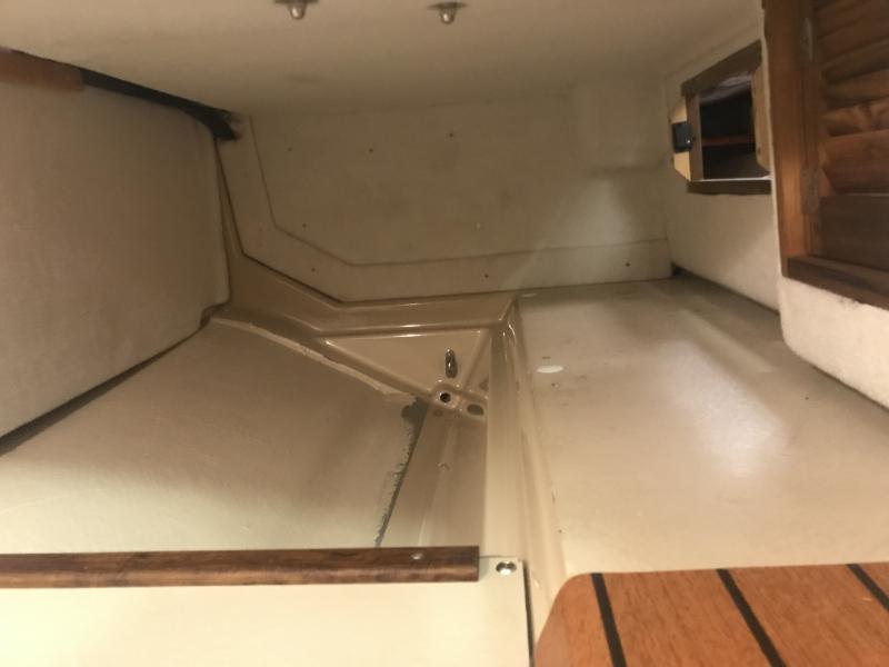

I had the same problem in my R29, 2012. A leaking water line to the shower put 80 gallons of water in the forward compartment that would not run aft to the bilge pump because of blocked limber holes. It is dangerous. The picture shows the limber holes, I got a similar picture from Ranger. Getting to the limber holes and clearing it out is a whole different problem. I still haven’t cleared my forward to aft holes because the holes are underneath the engine in the bilge trough. Driving it out is not the way to go, potential for damage.

Despite what looks like limber holes in the stringers along the keel, water sequestered in our forward bilge area (near the shower pump) has never made its way to the rear bilge in our boat. We suspect that the keel limber holes are clogged due to our discovery of limber holes in the port stringers (below the Cave/Pullman berth) and the starboard stringers (below helm/galley) that were clogged from factory construction debris. See attached photos. We cleaned the limber holes in these locations and know they function.
It is a regretful design that you cannot access the center-line bilge in the R23. We've considered cutting access but will only execute if it is required (due to tank leaks, plumbing issues, etc.). If we ever do access the center section, we intend to install limber chains through the center limber holes giving us a way to keep them clean routinely. Some day we will figure out how to access the center section and report back
