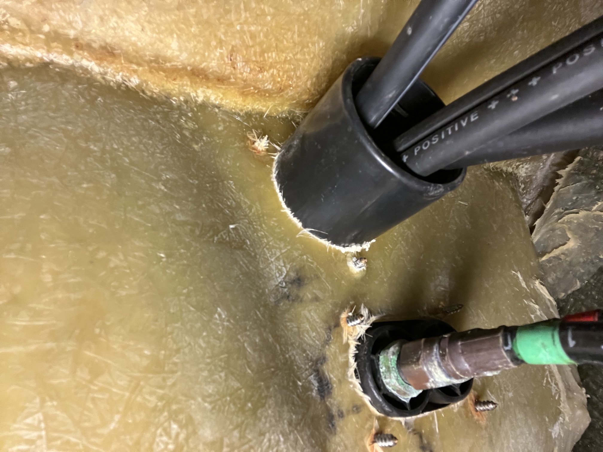

As we all know, the pod is a critical component of watertight integrity. Any component failure allows direct access for water to inside the hull. In our opinion, any fitting or penetration in the pod should be considered "below-the-waterline". With this in mind, we're focusing on our pod. Leak sources now obvious and more questionable FM construction:
1. Factory plastic access cover assembly is weak and flange held in place with #10-1/4" screws. The sealant under the flange was thin (non-existent in some places) and points of obvious leaking was noted around the flange and screw holes.

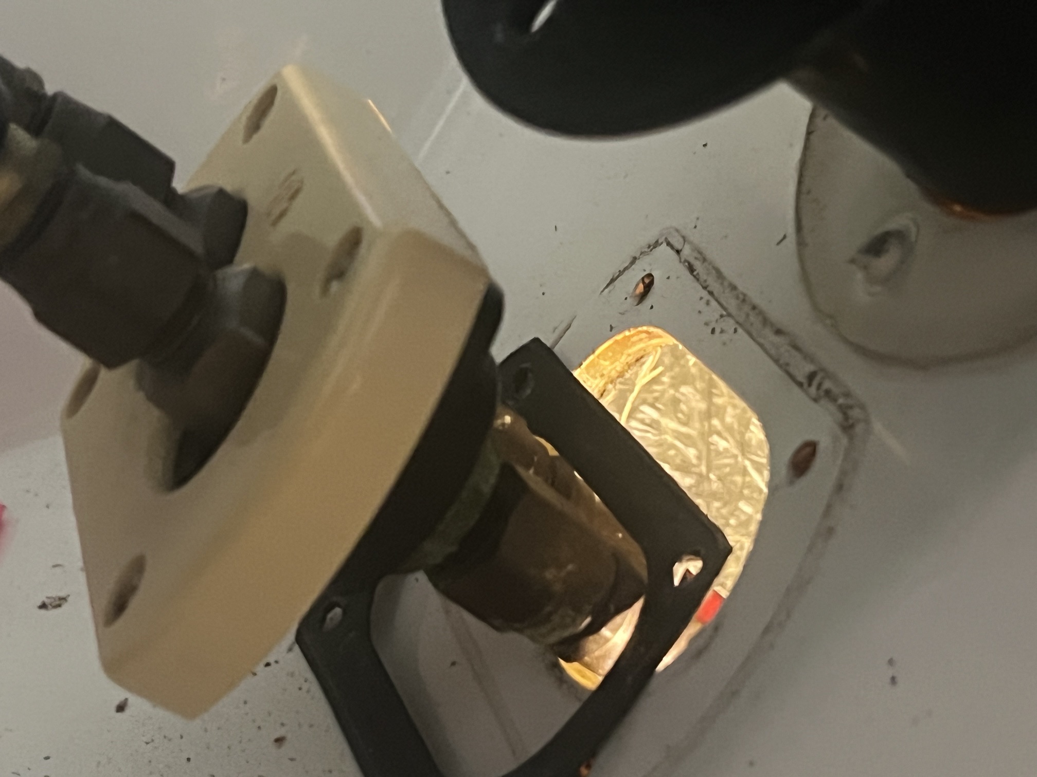

2. Hydraulic steering hose "bulkhead" fitting clearly leaks with no sealant present, only a thin rubber gasket. Assembly held in place with screws with obvious water intrusion into the fiberglass around each screw.
3. Engine "bulkhead" flange fitting seemed to be bedded correctly but held in place with screws and obvious intrusion into the fiberglass is noted.

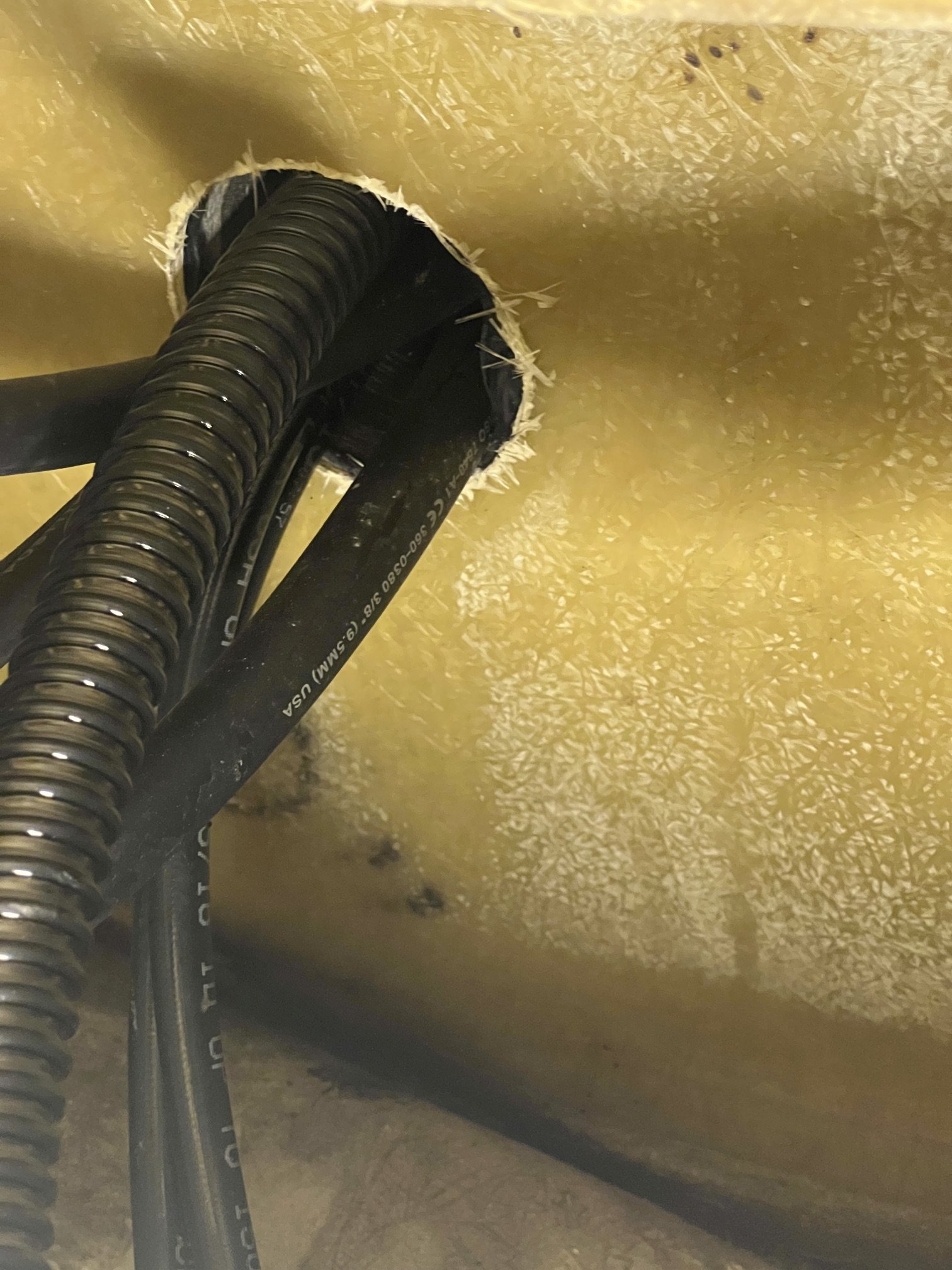

4. No chafe protection for hydraulic steering hoses, electrical line, or fuel lines through the transom.
