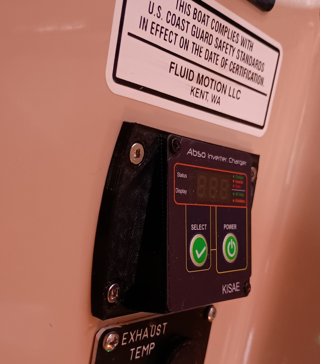

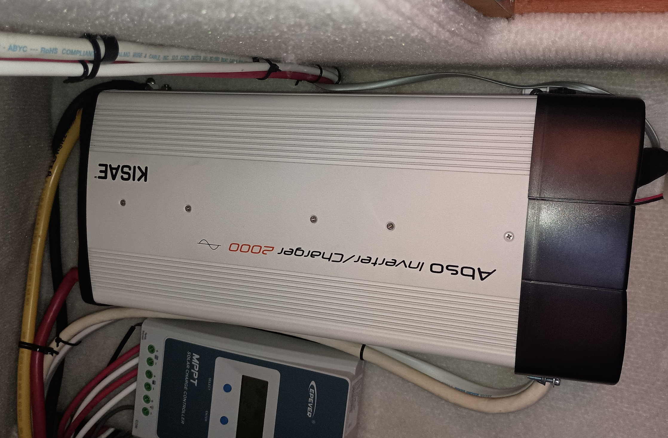

Your install looks good. Your original unit did not fair well in its previous location. I agree with Knotflying the factory installed location is not the best for electrical equipment. The below deck area is great for storage but the elements are all there to decrease the longevity of electrical equipment. The ventilation is really non-existent if the engine is not running. We have a full enclosure so it stays dry but it actually increases the temperature. This can be a problem for all electrical devises including engine components. Your new location should eliminate all the elements. The...
Rather than hijack the solar panel thread, I figured I would continue this here.
I think the location of the unit is in a precarious spot and I have always had a concern with this. IMO a better location would be somewhere in the interior cabin. On my R-27 there is so much room behind the stove that may be a good spot. The unit really requires no maintenance and even if it did the stove moves out rather easily for access.
In lieu of moving the unit I think that the biggest culprit is water running over the gutter and into the top grill opening of the unit. Perhaps a deflective shield...
