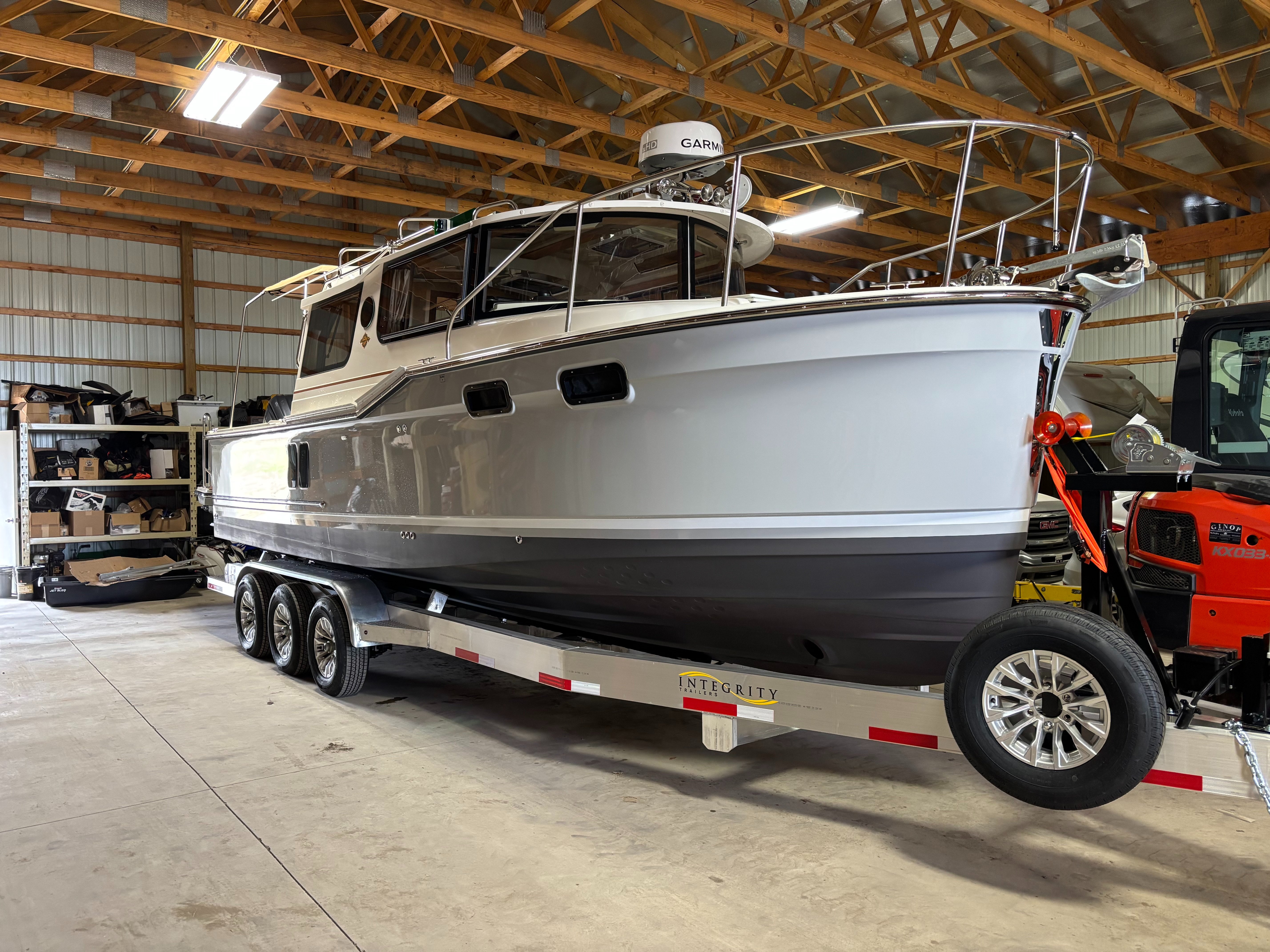

We finally picked up our new to us R27 and the custom built Integrity trailer. Most went well with orientation and test ride. Now waiting for decent weather to launch and put in slip for the summer. However, after spending time on her "on land", I do have a couple questions. How can you get lithium batteries out of port storage area? The person who did our orientation said they were on a sliding tray. That is not true. Come fall, I will want to store them in a warm garage. Also, is the solar expandable? Their resident expert could not answer that for me. I have a Ecoflow portable 200 watt panel that I would like to use at times. Finally, what system or brackets has anyone used to mount a standard Starlink receiver on the roof rails? Thanks

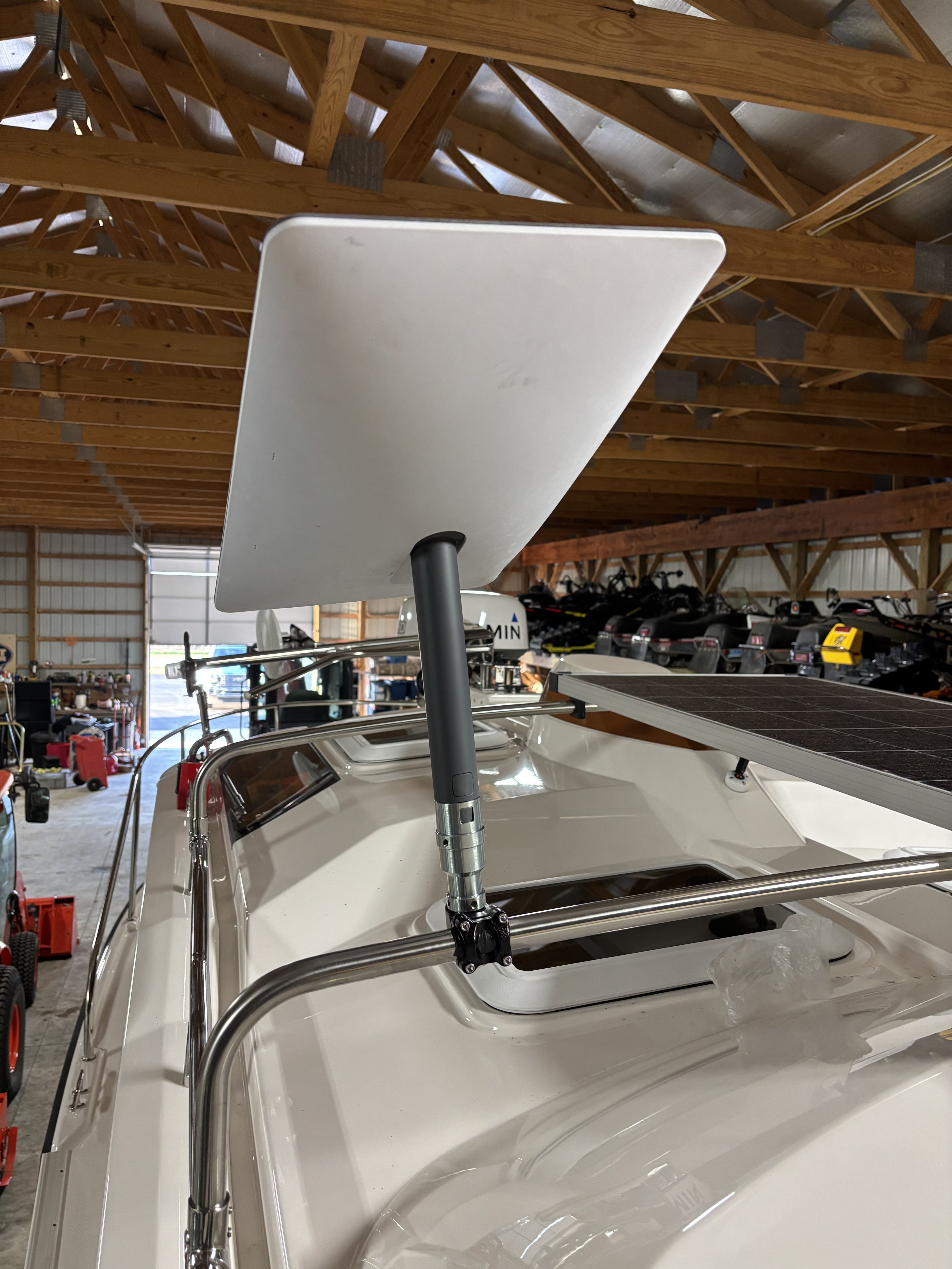

I do have the older actuated model. But, no salt here in Great Lakes. I won't "permanently" mount it to the boat. As I use it in our RV as well. I am looking for a bar mount that will attach to the 1" roof rack. Then all I would have to do is drop the post into and it would lock in place, like the OEM stand does. There are a couple I have found, wondering if anyone has had experience with those. Putting it into the rod holder would be easier, but we plan on using the sun shade often. The 12 volt is a great idea, but a project for later. Not too concerned about power consumption just yet. I will most likely bring my solar generator and plug it into that.

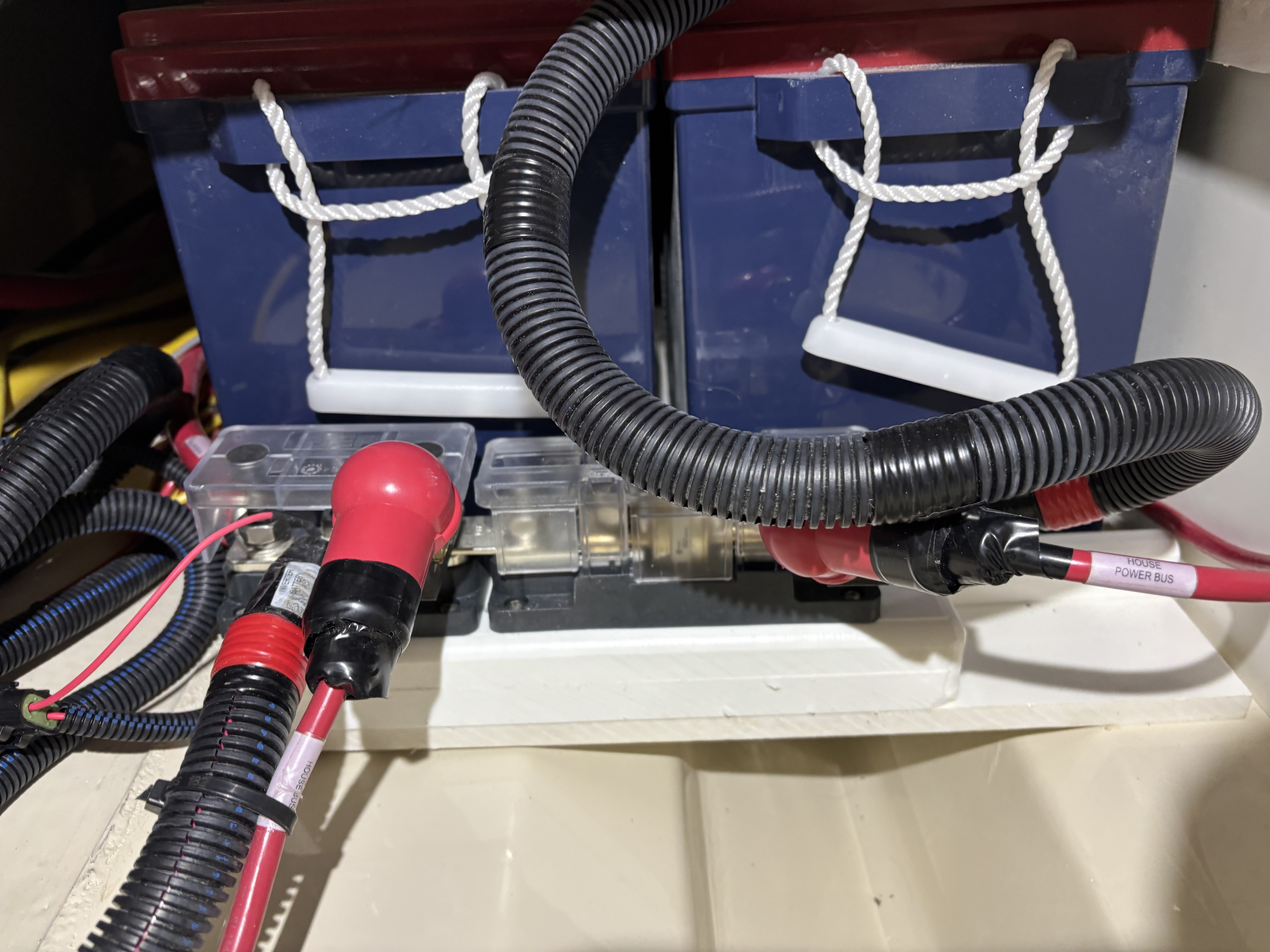

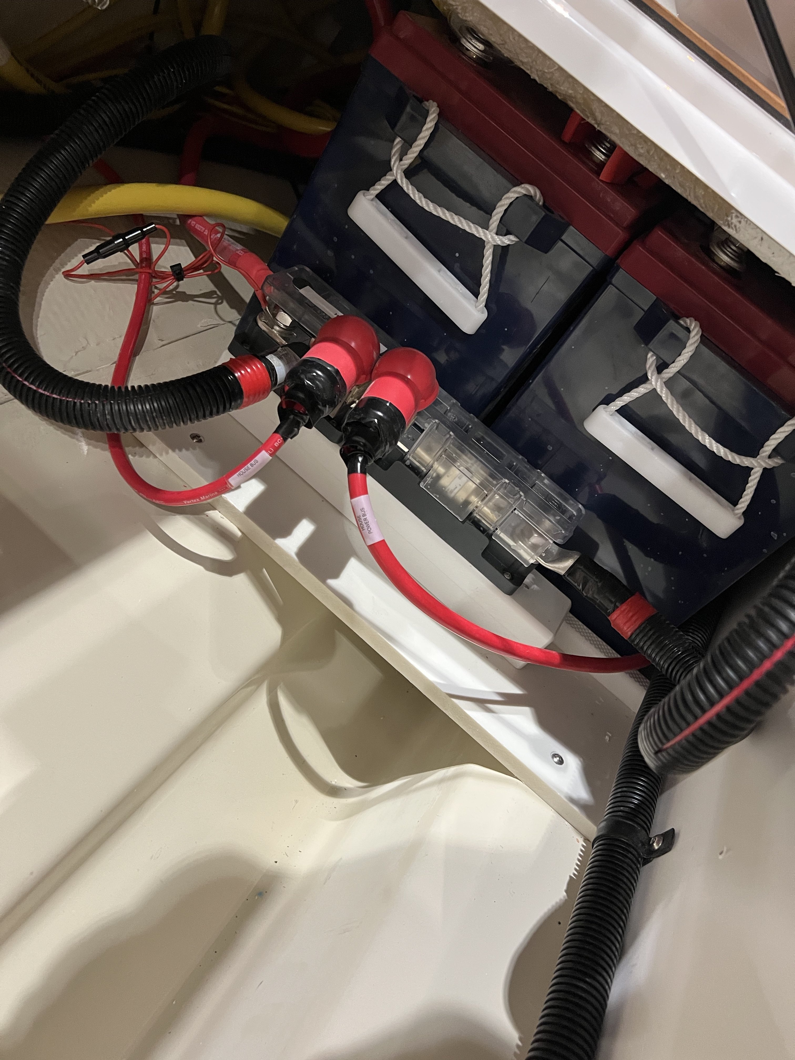

This is a pic of our house batteries tray. No screws. I was able to move it a bit , but it didn’t feel like it was meant to.

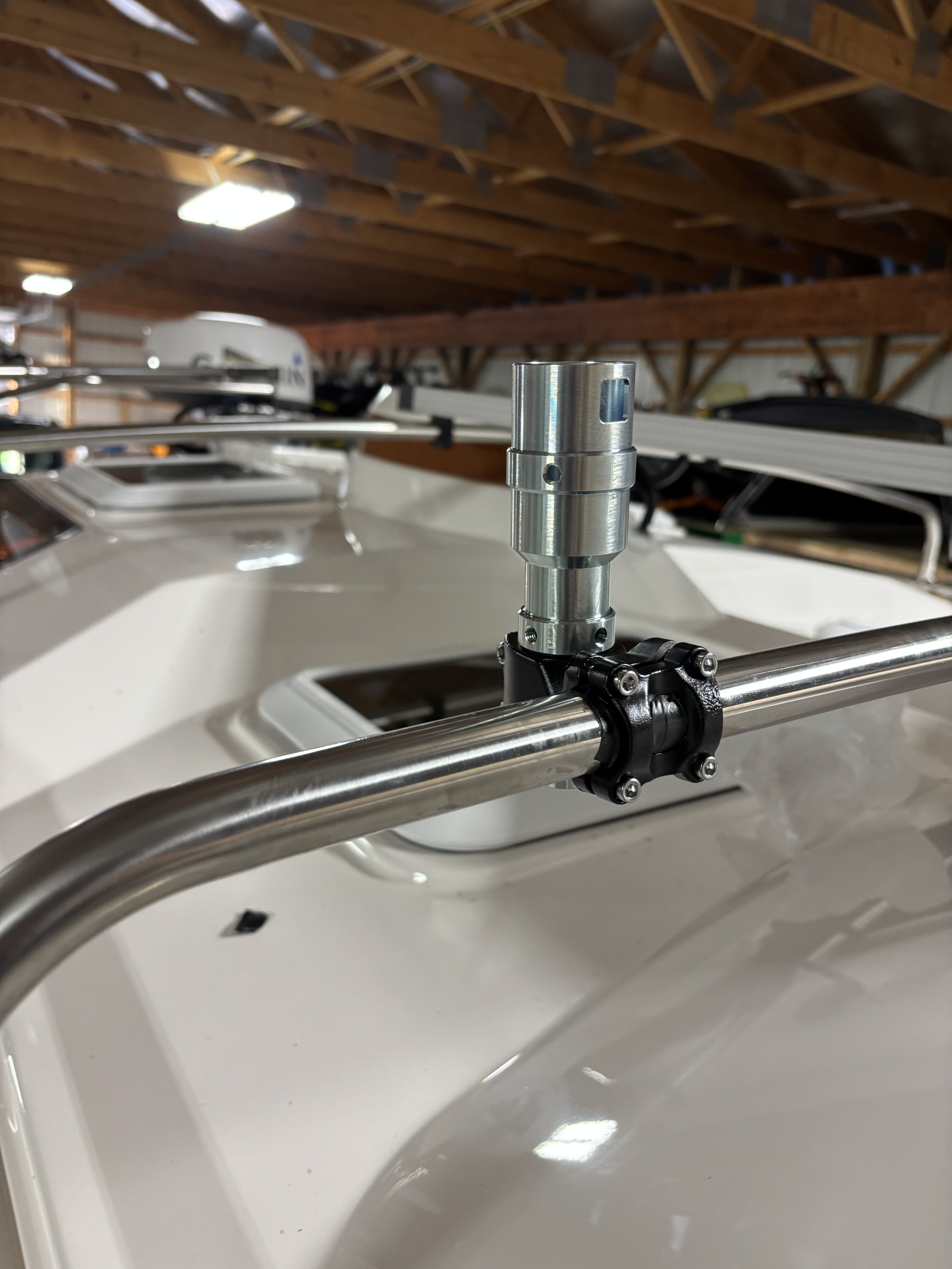

Found this mount on Amazon, it was a 2 minute install. Seems very sturdy and well built. The stock Starlink post locks right in. I will not leave it up at high speeds or rough seas. For now I will run the cable through the side window.

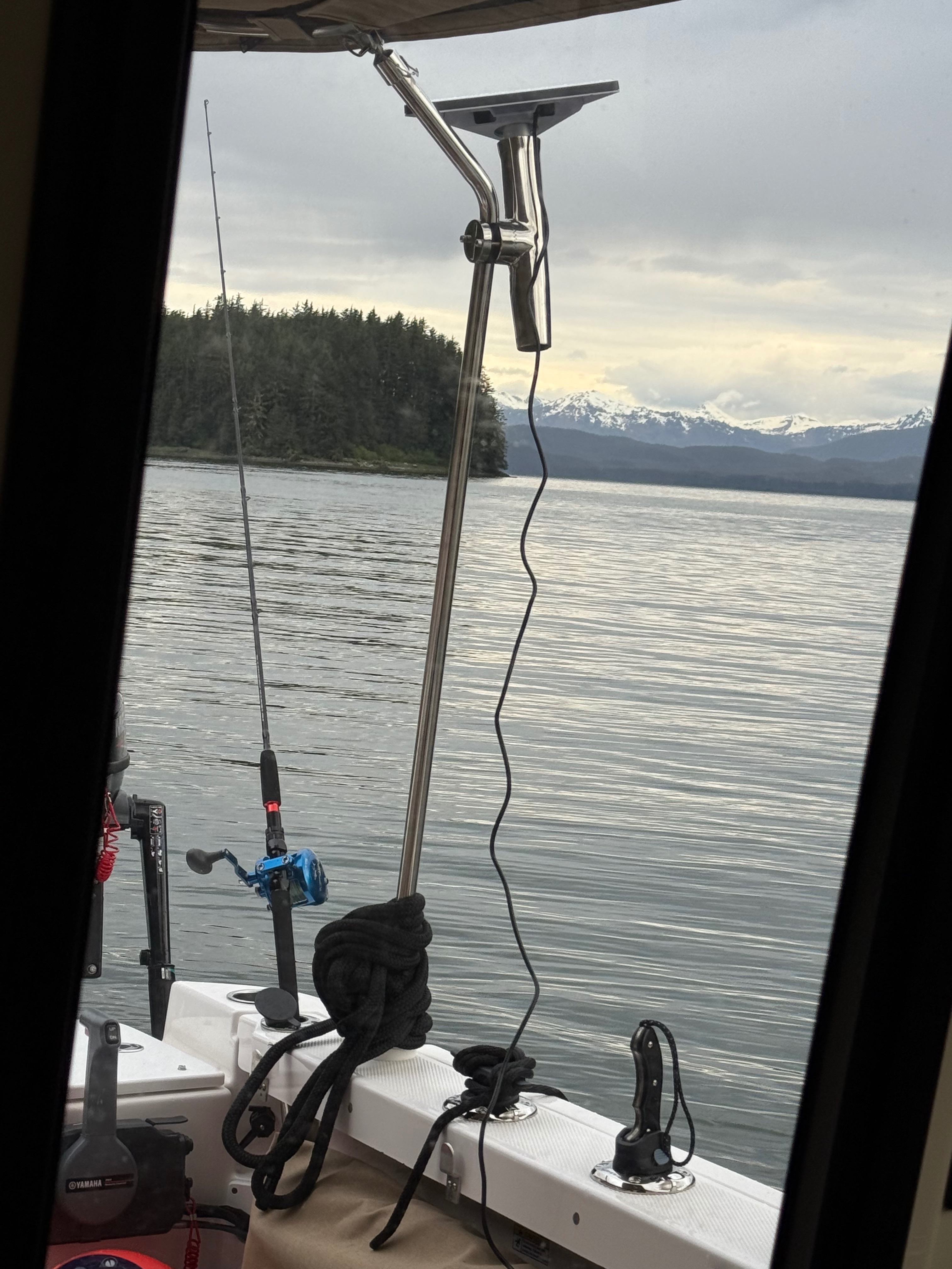

We used rocket launcher and bought this waterproof cable from Amazon which I wired to a Scotty down rigger male plug. Fits in the down rigger outlet and has on off switch. You can use a piece of pvc as a post mount for dish. It works great.

The tray does slide but it slides like you would expect a board with 300 or whatever pounds of batteries on a shelf would slide. There are no wheels or bearings or anything - tons of friction.
I installed a battery monitor on mine last year and pulled it out just far enough to deal with the house batteries. It was extremely difficult to push the tray back in and line the holes up perfectly again. Of course my boat was wired different than the schematics and based upon the results from the battery monitor it looks like my solar positive is on the thruster and the negative went to the house….I am not looking forward to investigating further as that will take a whole day of hard labour in the lazerette moving the tray.
The tray does slide but it requires heroic efforts if the batteries are on it.
