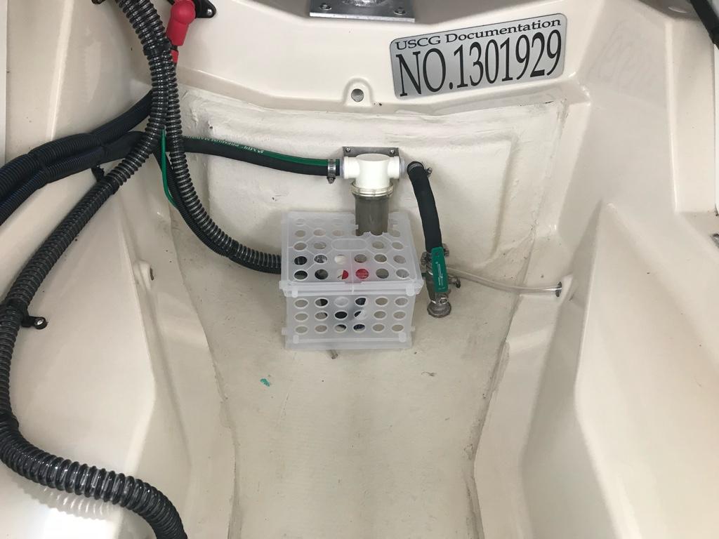

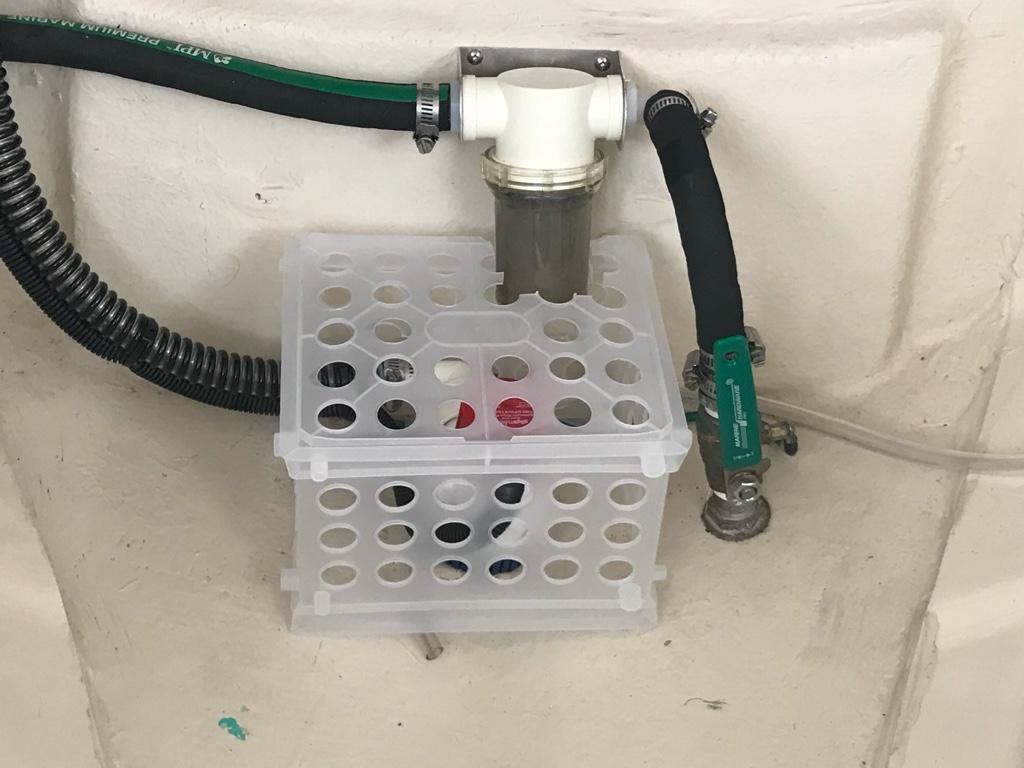

Years ago... I saw a post where someone fabricated a structure to provide to protection to the exposed seacock in the center bay of the R27-OB.
For the life of me, I can't fine the post anymore.
Does anyone remember this?
It was me. Phil
Search under R27ob safety project.

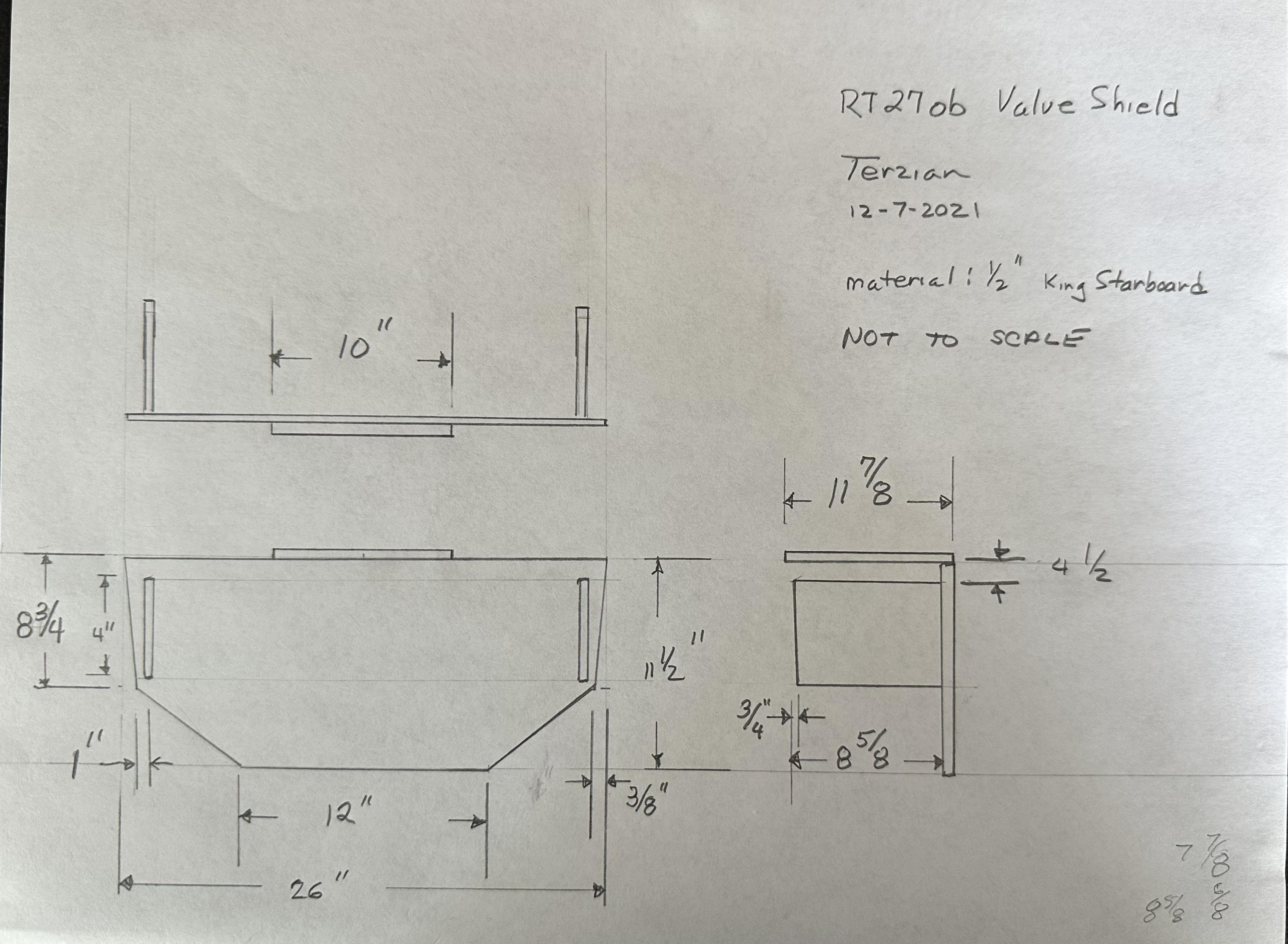

If anyone would be so gracious as to send me measurements and rough plans, I'd be happy to draft it up in Fusion 360 and post the plans here for all to share in.
I have this…
