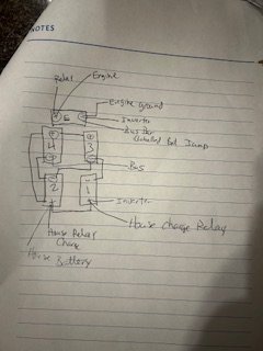

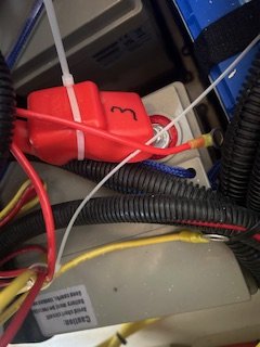

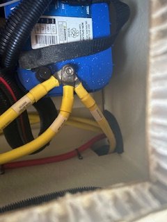

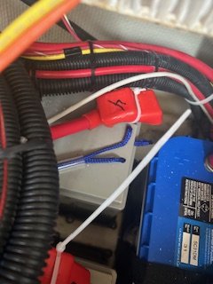

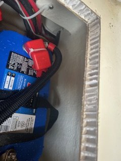

Here's my diagram and some pics of the forward batteries. The blue is the start battery. This turned out to be the same wiring as the manual has.
