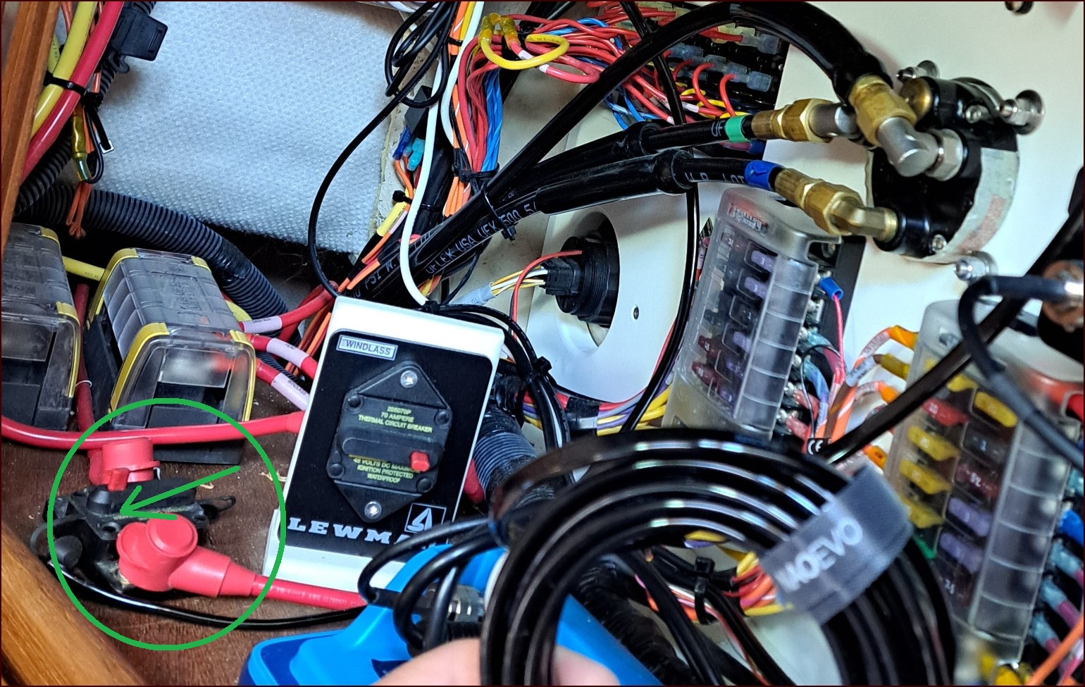

Our toilet in the V berth stopped working. No lights on the panel. I'm wondering if the fuse has popped...or is it a breaker...and where is that located?
Can you think of any other reason the unit would fail?
It is a fuse, it should be under the sink in the cockpit.
I just had a fuse blow that was in there. I replaced it and everything is still working fine, it was a smaller 1amp one for the propane sensor, but it looked very corroded. I suspect they are exposed to the elements a bit more than something that would be inside a dry(er) spot inside the salon, and the tiny wires of the fuses just corrode.
I had the same problem just a week ago on my 2019 R31. It was the breaker under the helm, which I accidentally turned off while working in the area.
Thanks VERY much. I did find it, reset it and it hasn't popped yet.
