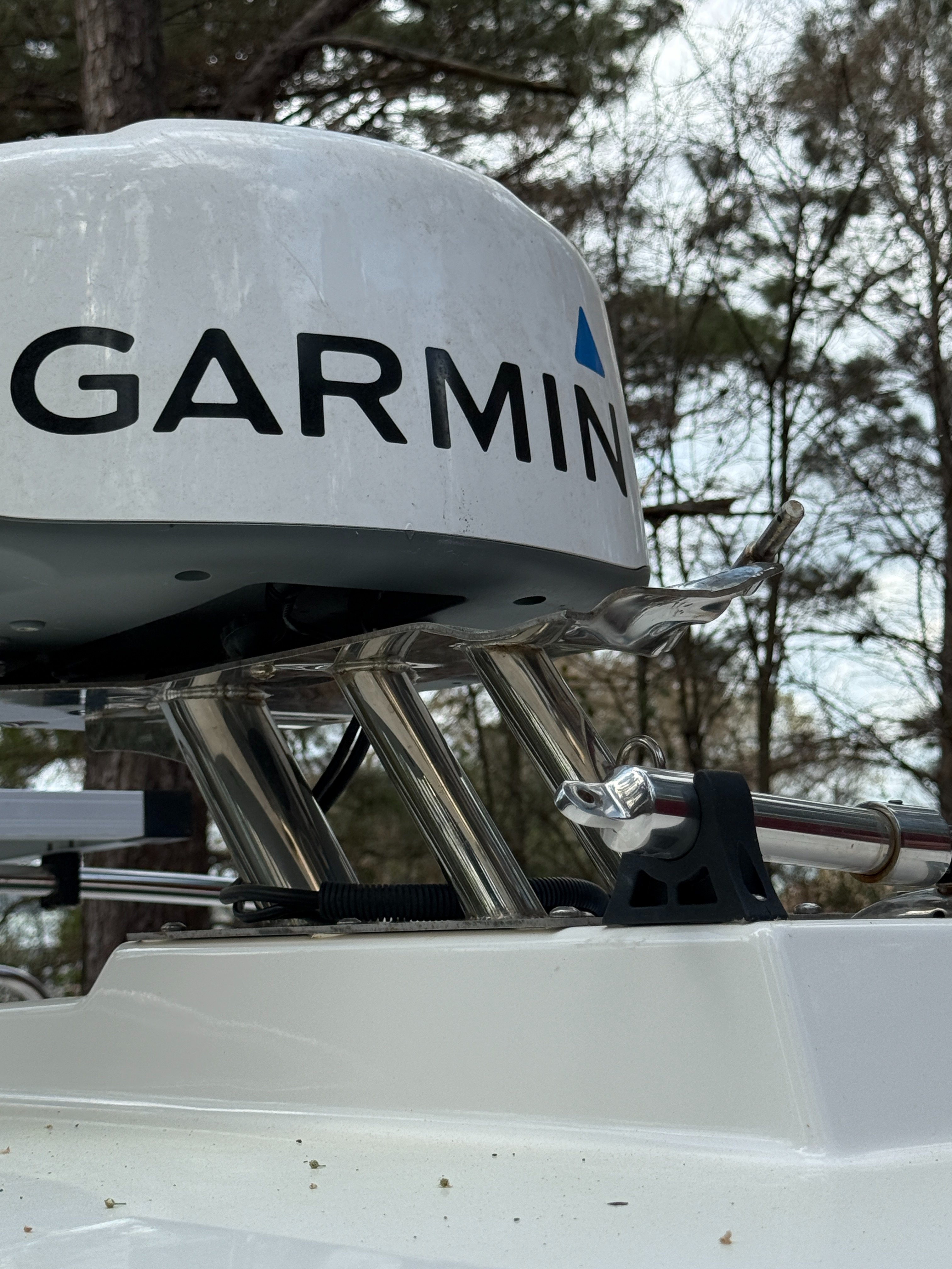

This is from an R27-OB, but it sounds like your mast is put together the same way. There are bolts on the back side of the base of the mast.
Here's a photo to illustrate.
