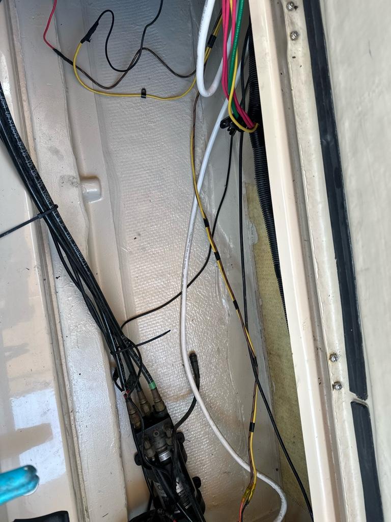

But there was always a lingering smell at foot level in the cabin every time I went down low to take out pans and such and open the other cabinets I detected a type of poop tank smell.
Well, what I discovered when I was tearing out the rotted plywood in the starboard aft locker, pause for effect, when I pulled up the rotten plywood to reveal the primordial, sewer sludge pudding, soup underneath that rotten floorboard it almost made me vomit!
It turns out when the hatches aren’t ceiling water goes in to the gelcoat covered plywood and rots it from the outside and at the same time when the shower sump does not drain or if it overflows the water drains out and gets into an under that floorboard.
I am attaching a photo of the cleaned up bottom solid, fiberglass, and gel coat that will stop the process.of Alsofixing the shower sump and installing a manual pump out switch.
All food for thought!

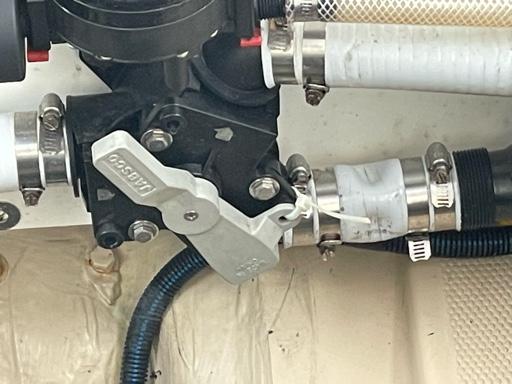

Also - the collapsed hose was caused by me running the macerator pump without opening the valve!
