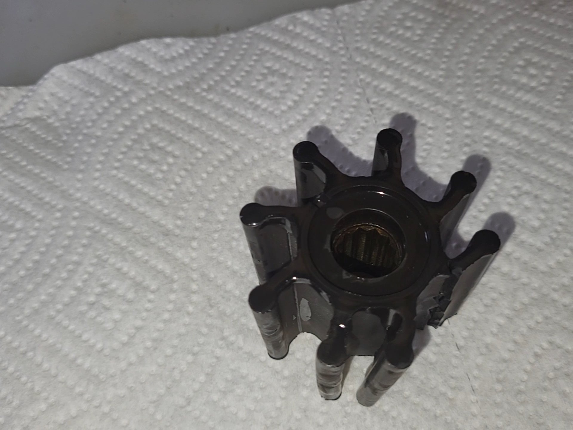

Raw Water pump impeller

What type of age/hours on that thing? Thanks for the post, this is on my list (including FF's) for my d4 260 in the upcoming weeks.
Sorry for the messed up post. RT-27 2011 Yanmar 4BY-180 total 2243 hrs Last changed at 1917 hrs. Book says 200 hrs, 326 hrs is too long.
