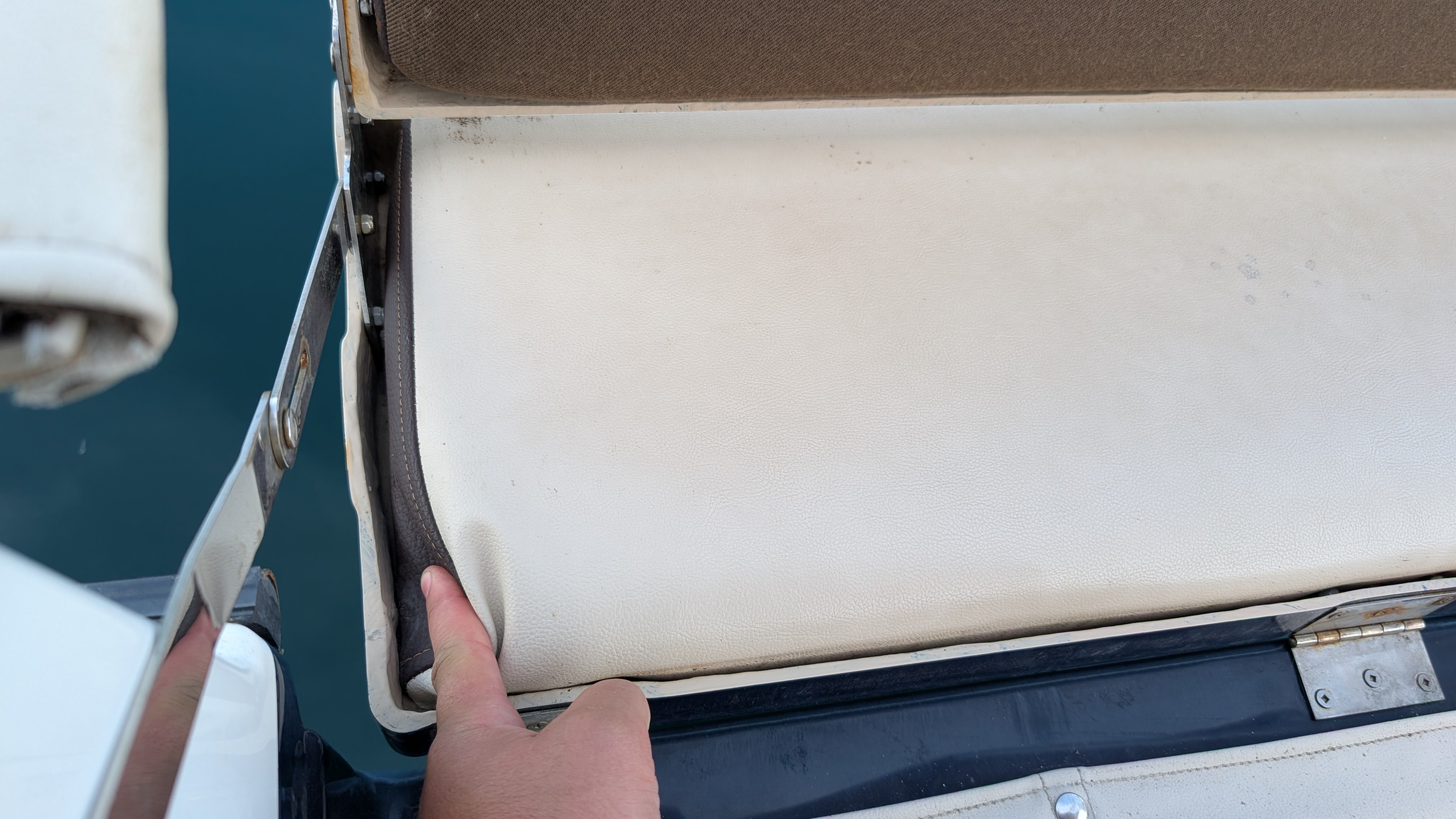

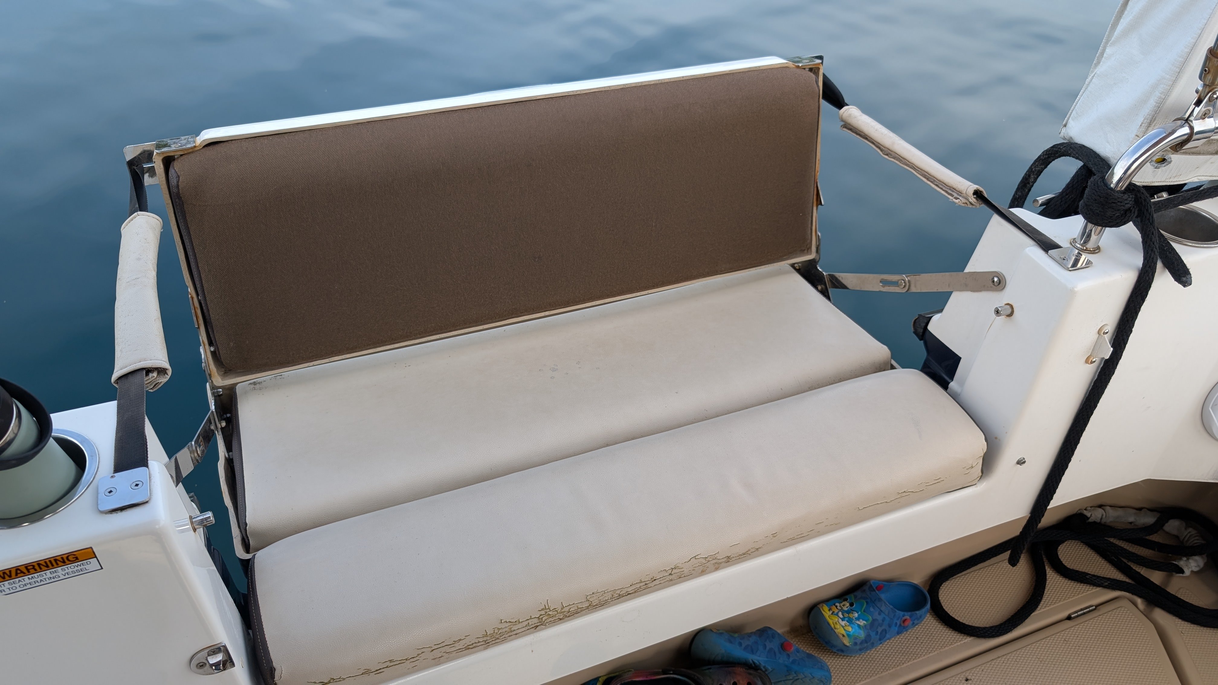

Does anyone know how the cushions on the side seats of a R31 come out? I don't see any fasteners, but they are secured very well. They bottom portion just has buttons and is easy, but the big part of the seat we can't figure out. My wife is going to make new ones since ours are cracked, but we need to figure out how to take them out first.

Mine has screws on the each side of the back pieces.
If you haven’t gotten to removing them, we removed and had them redone 2014 R31CB . We had to remove Crome on rub rail , rub rail and screws were under rub rail.hope this helps
