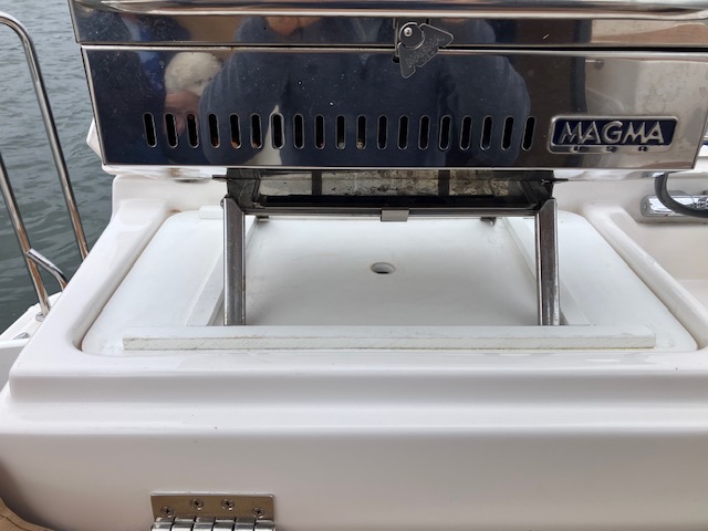

We made a starboard lid for the space occupied by the Kenyon grill. This cover flips over to provide a spot for a Magma grill: there are fiddles that keep the Magma from sliding.

We store both the Magma and Kenyon in the center cockpit locker of our 2023 R27. Some marinade we have visited do not allow propane grills. We use the “fish well” to store trash bags while cruising, as we don’t fish.

Here’s a pic of our grill in action. The starboard platform flips over to cover the well. While cruising we use the well to contain our trash bags.
Serendipity- what model magma ? Exactly what I am looking to do. The kettle works ok, but it's a tough fit into the fishwell. I also have a 6' hose from the propane locker to the kettle. It could back up in the locker when not in use.
It’s the Catalina infrared model. Ours is about 12 years old, but I believe the Catalina 2 model replaced it. Most Catalina style models have fold out legs.
