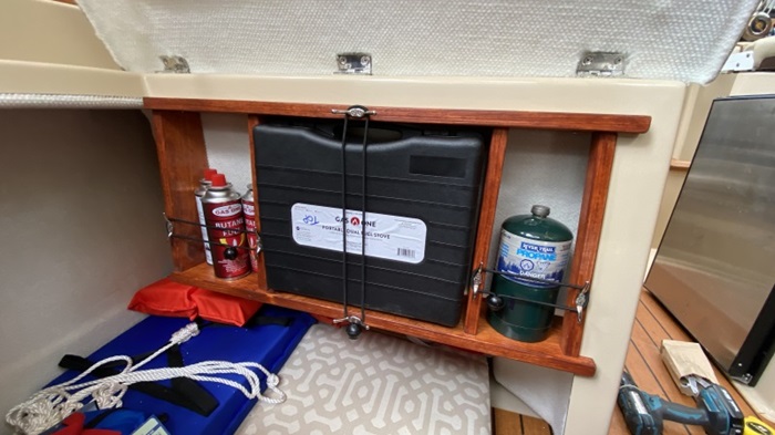

Like others, I just got a small butane stove and it works great. I considered removing the electric/alcohol stove and mounting the butane stove instead (and still might, someday) but so far it is easier just to get it out when needed. I copied @Hamster and built a shelf in the cave where I store the stove when not in use: https://briandunnington.com/ranger_tug_r23_cave_shelf
(And yes, I know about the dangers of storing propane in an enclosed space - this is just a test)
Looks familiar! The two things I’d add is that keeping the existing stove provides a backup to your butane stove in the event it fails or you run out of fuel. Second, the butane stove fits perfectly on top of the glass cooktop that comes with the boat. I can find no reason to remove the original stove but do use my butane stove exclusively now.

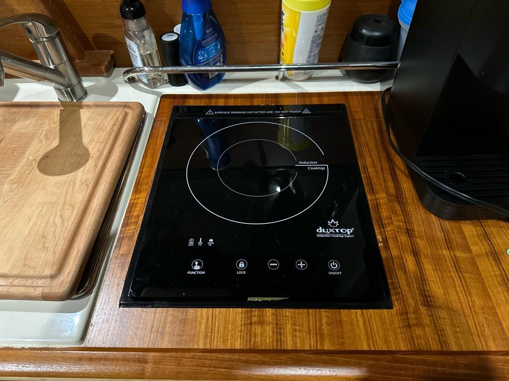

I removed our alcohol/electric stovetop and replaced with an induction cooktop. Pretty straightforward.
I replaced mine with an induction stovetop. The unit I had fit in the existing hole without modification and some slight grinding on the plastic housing of the induction unit. I set it in a polished stainless steel frame that matches the sink.
We cook a lot on our boat and the induction stovetop works well, including larger pots.
Exile, can you share a pic and/or the details on the induction unit that 'fit' so nicely? Boy, if my wife hears about that option....
Dave, you taptalk seems to be preventing the posting of your pics, including your induction stovetop pic. Perhaps you could resend 'manually'.

The induction cooktops take up to 1800 watts of power and many need 110 volt 15 amp service. That’s fine if you are on shore power. I’m unsure if the factory installed generators could keep up with that power demand. And if you don’t have a generator, using an inverter would quickly drain the house battery bank. So yes, this might be a solution for when you are on shore power at a marina. For us being on shore power is only about 20% of our cruising venues. The butane cooktop alternative doesn’t care where you are moored.
"The induction cooktops take up to 1800 watts of power...."
Yup, using an induction burner, just like using the microwave, requires some thoughtfulness about energy management and may not be suitable for some. But cooking times are shorter - boiling 6 cups of water for coffee will take about 90 seconds - and the watts needed may be well below 1800 (unlike the microwave, which always demands the same power level). One of the benefits I'm thinking of is because we live and boat in Florida. Cabin heat build-up due to cooking will be less...and that's a benefit that applies at the dock as well as on the hook.

My R-23 came with a 2000W inverter for A/C underway, and I now have 400Ah of capacity.
