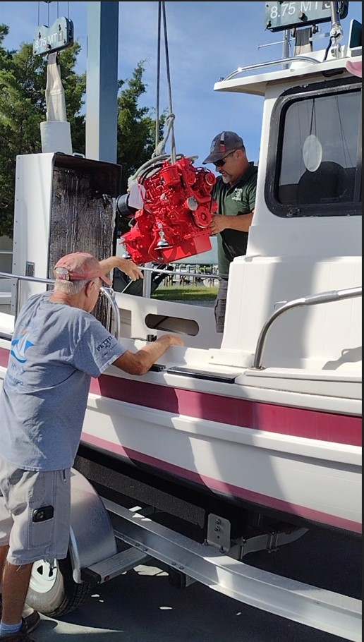

We just completed repowering our 2005 R21 with a new Beta Marine 25 HP engine. The install took 2 days and required modifications to the engine mounts, prop shaft and prop pitch, but overall, it was a pretty easy swap. Will be conducting sea trials within the next few days.
