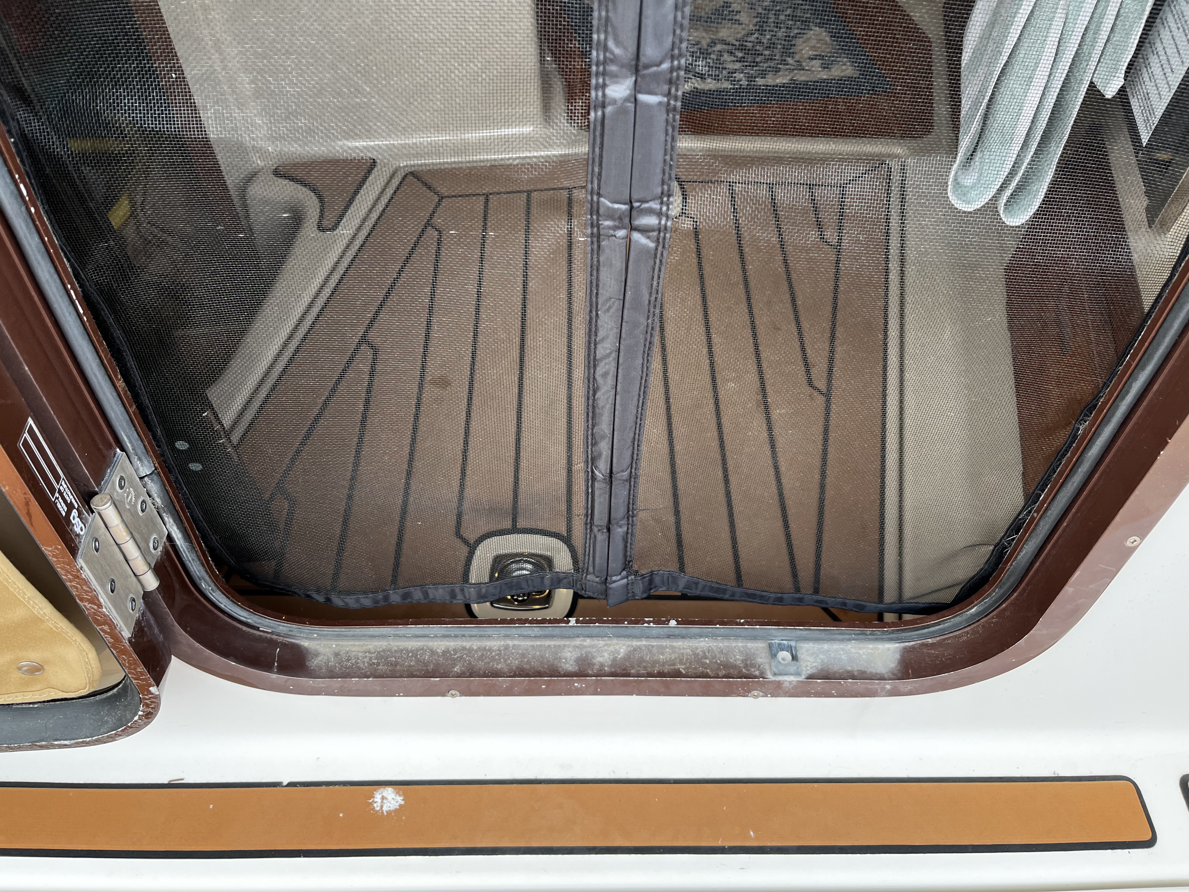

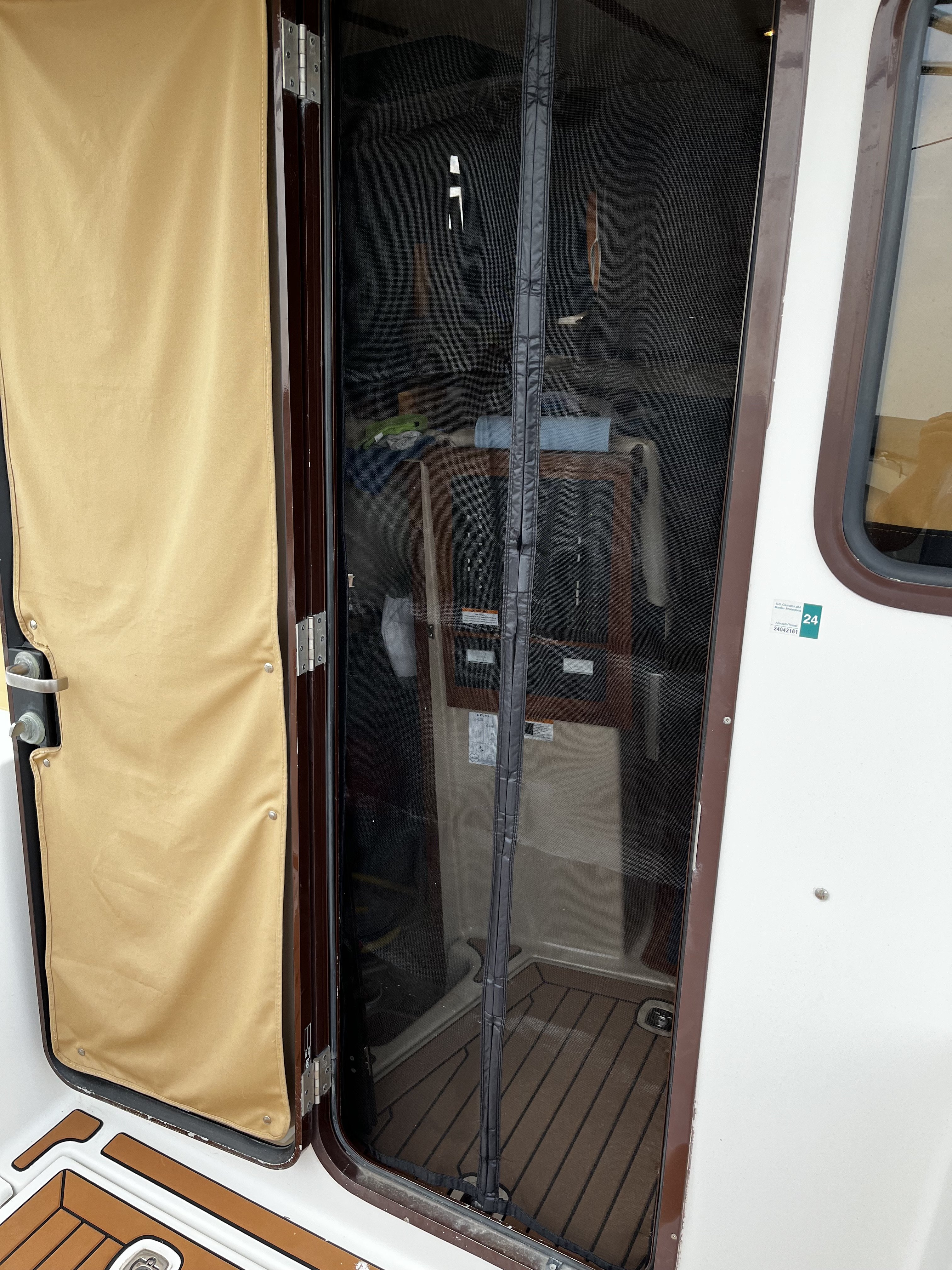

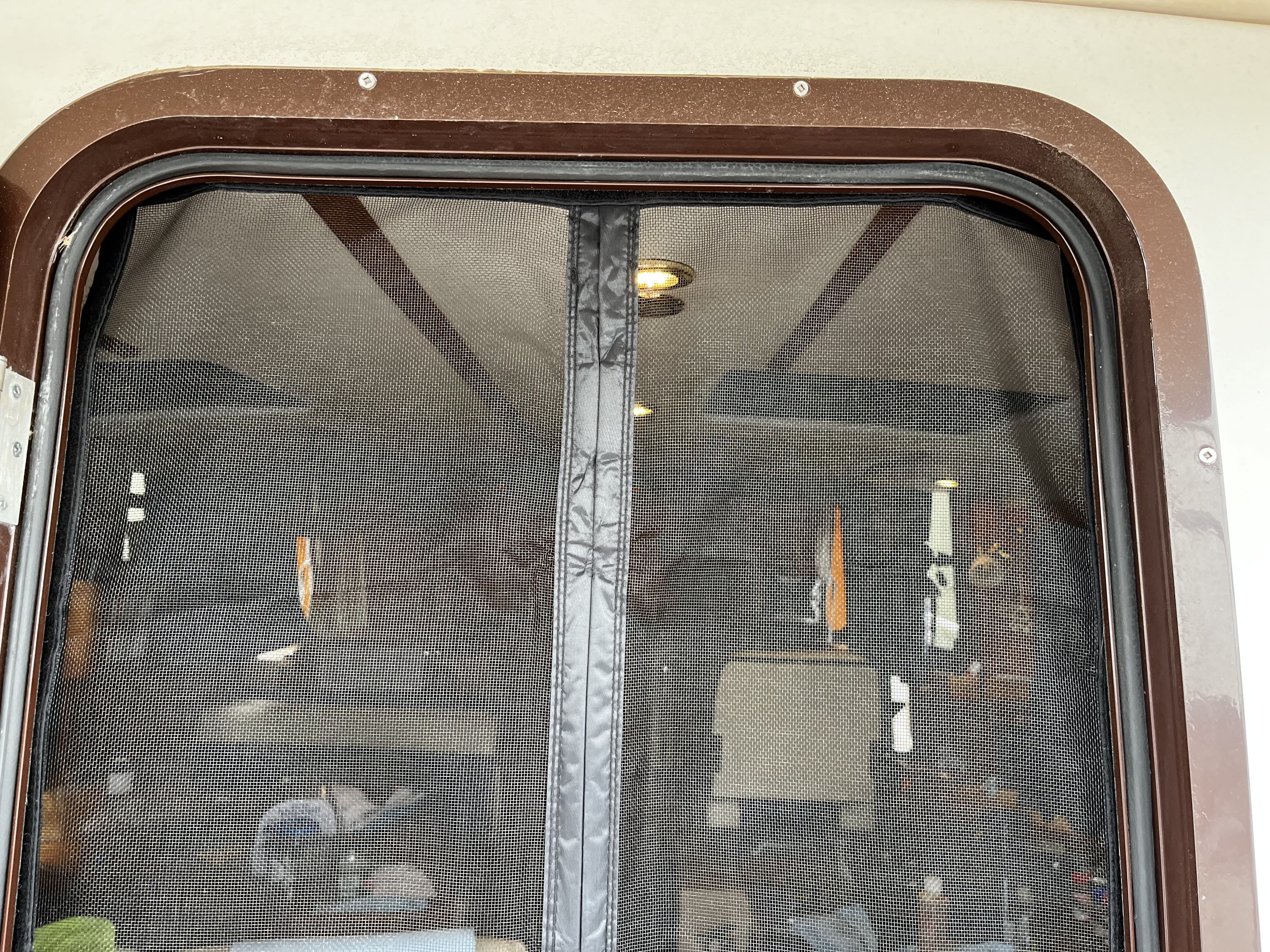

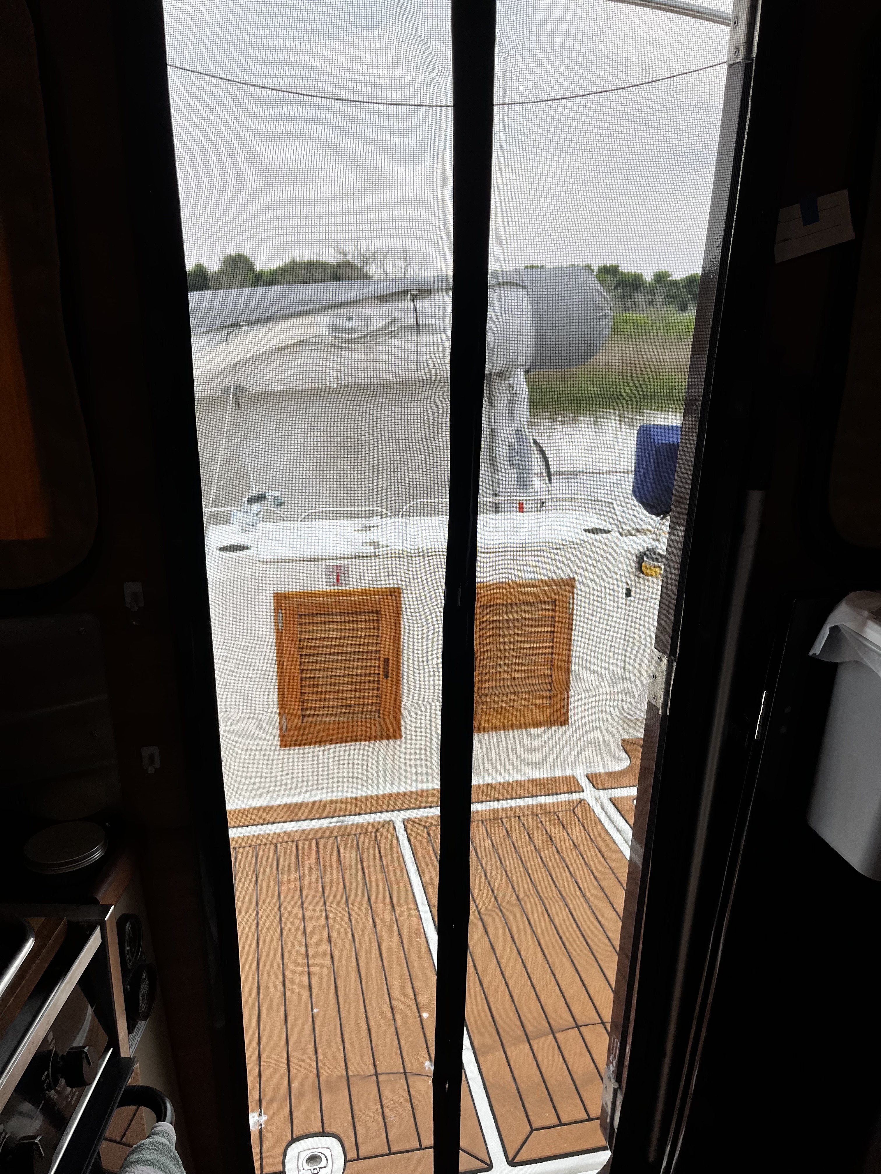

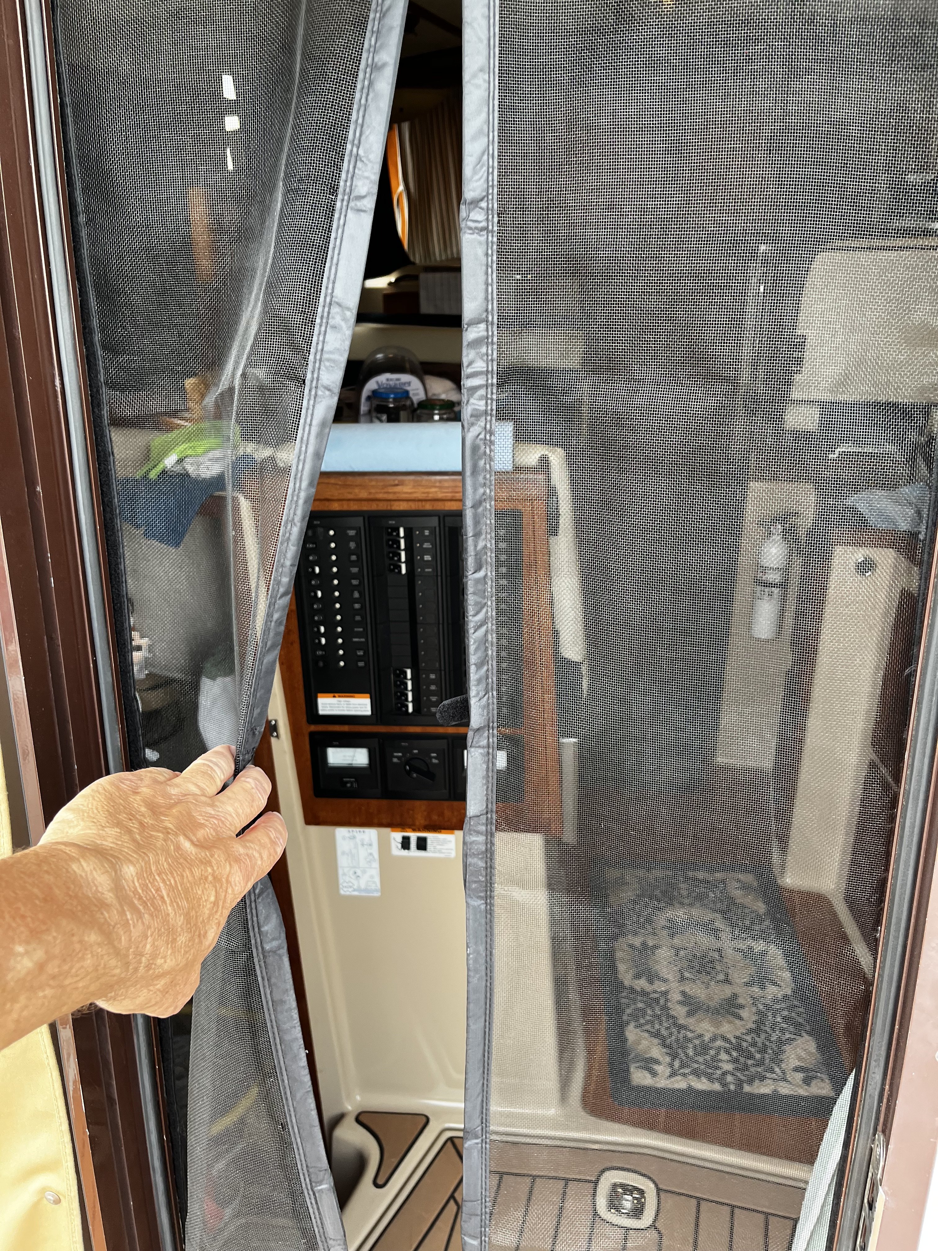

Not retractable, but we use this on our cockpit door and it works pretty nicely.
I had ours made to 24.75” x 73.25”
I'll take some tomorrow and post them here.
I ended up back at the boat today so here are some pictures. The screen mounts very nicely to the hatch frame. adhesive backed hook and pile system. Pile side is stuck to the hatch frame. We're 3 years into the product and no tears or rips. Center is held together by magnets sewed into the fabric.
