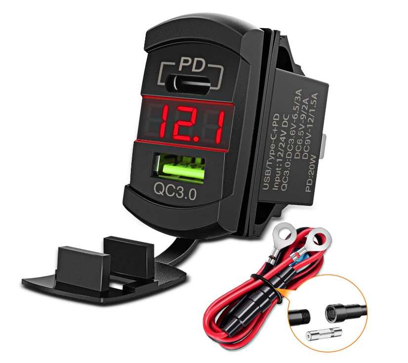

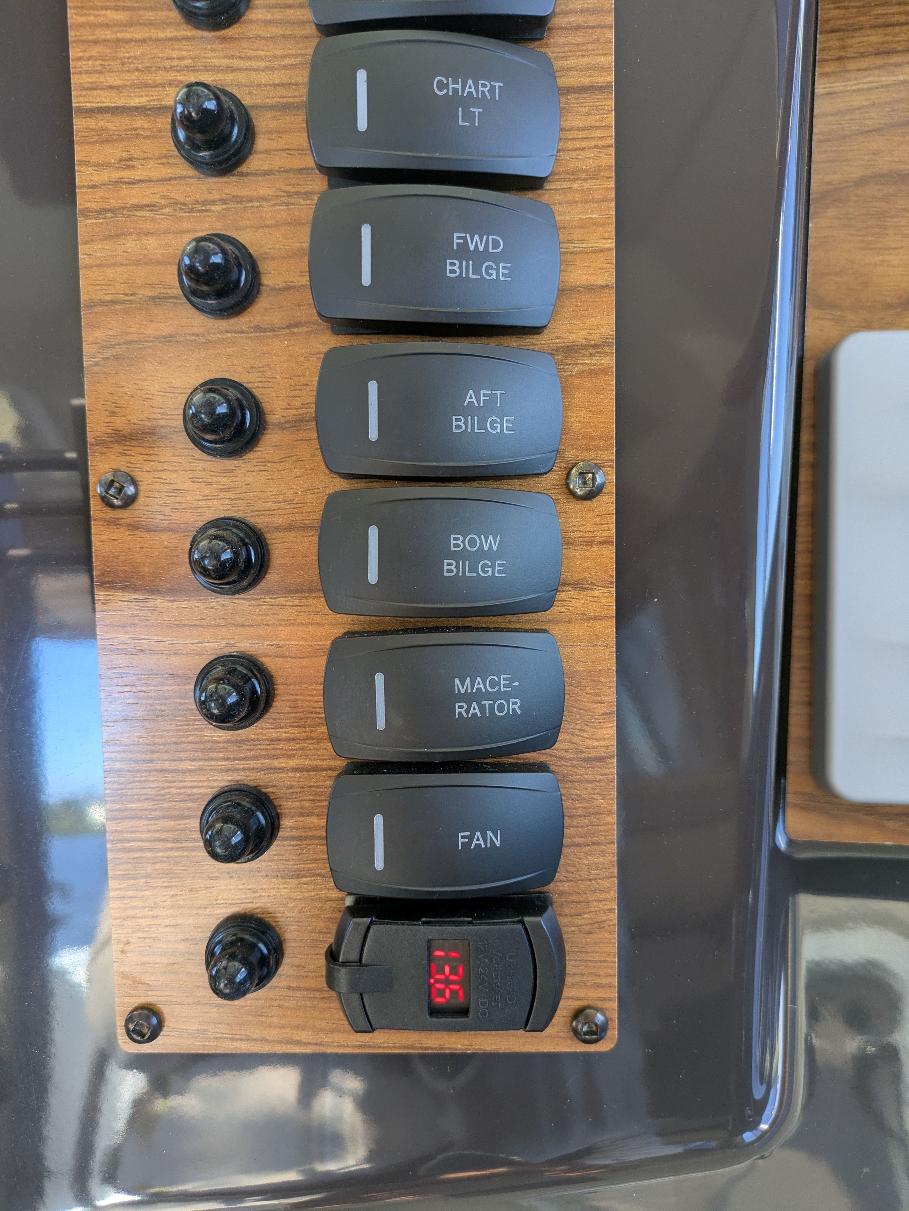

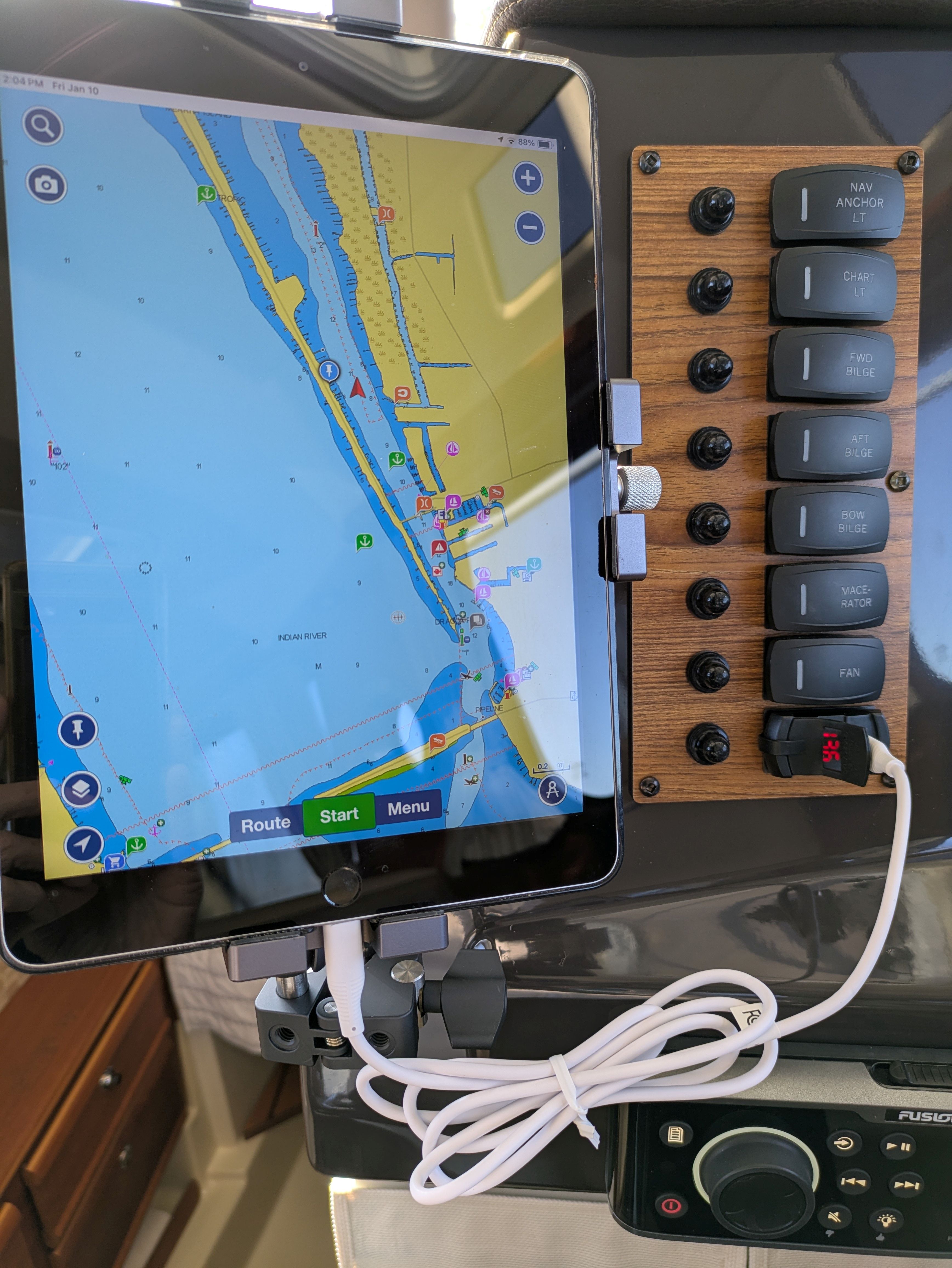

Found that we needed a PD (power delivery - 20W) charging port for Ipad to keep up with the power draw running Navionics. Fortunately there are 2 unused rocker switches on our 2021 R27. We replaced the lower rocker switch with this unit from Amazon. The swap out was easy and Ipad now stays charged.
