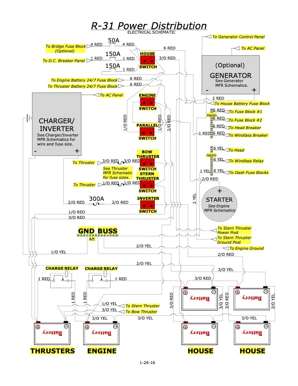

Ok, I installed the shunt as I understood from the manual and comment above but not getting the shore power input from the charger. The negative out of the battery bank is connected to the battery side of the shunt and the load side of the shunt is using the lead to the busbar. The positive wire of the shunt is connected to the positive of the battery bank.

Did you disconnect ALL negative leads from the battery bank and run them through the shunt? My bank had 2 large negative cables (C30).
No but will have a look at it, from the R-31 Power Distribution diagram, it looks like one of the negatives exits the house bank to the engine battery. Thanks for the suggestion.

Let me know where you land because I have the same wiring in my R-29 and plan to install the battery monitor with shunt. If I stick with the 4 AGMs (I am contemplating going lithium), I figured I would need to install a negative bus bar near the batteries because there are 3 different negative lines to capture (inverter/charger, engine battery, and house loads - to ground bus bar).

Shontm, you were correct and all worked fine once I gathered the negatives together on the load side of the shunt. I'll get a busbar to tidy up.
