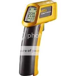

Using an inexpensive infrared temp gun like this
start keeping track of engine temps in your boat's log book. The Active Captain people describe using a system whereby they put a little dot of red paint at several locations in their engine room...like the oil filter, exhaust elbow, muffler, etc. Then they record the temps in their log book. After a few years, they say, they quit recording the temps because they KNEW the normal range for each location (it's a KEY principle that they measure the temps at the SAME locations, hence the dot of paint to mark the spot). Anyway, start noting the temps of 2 or 3 spots on your engine/exhaust sytem. The IR Temp guns are cheap (like $25 or less; Harbor Freight or similar is fine - of course you can spend more if you wish - FLUKE is top of line) and they make great cat or dog toys (chase the red laser dot) of you get bored.
