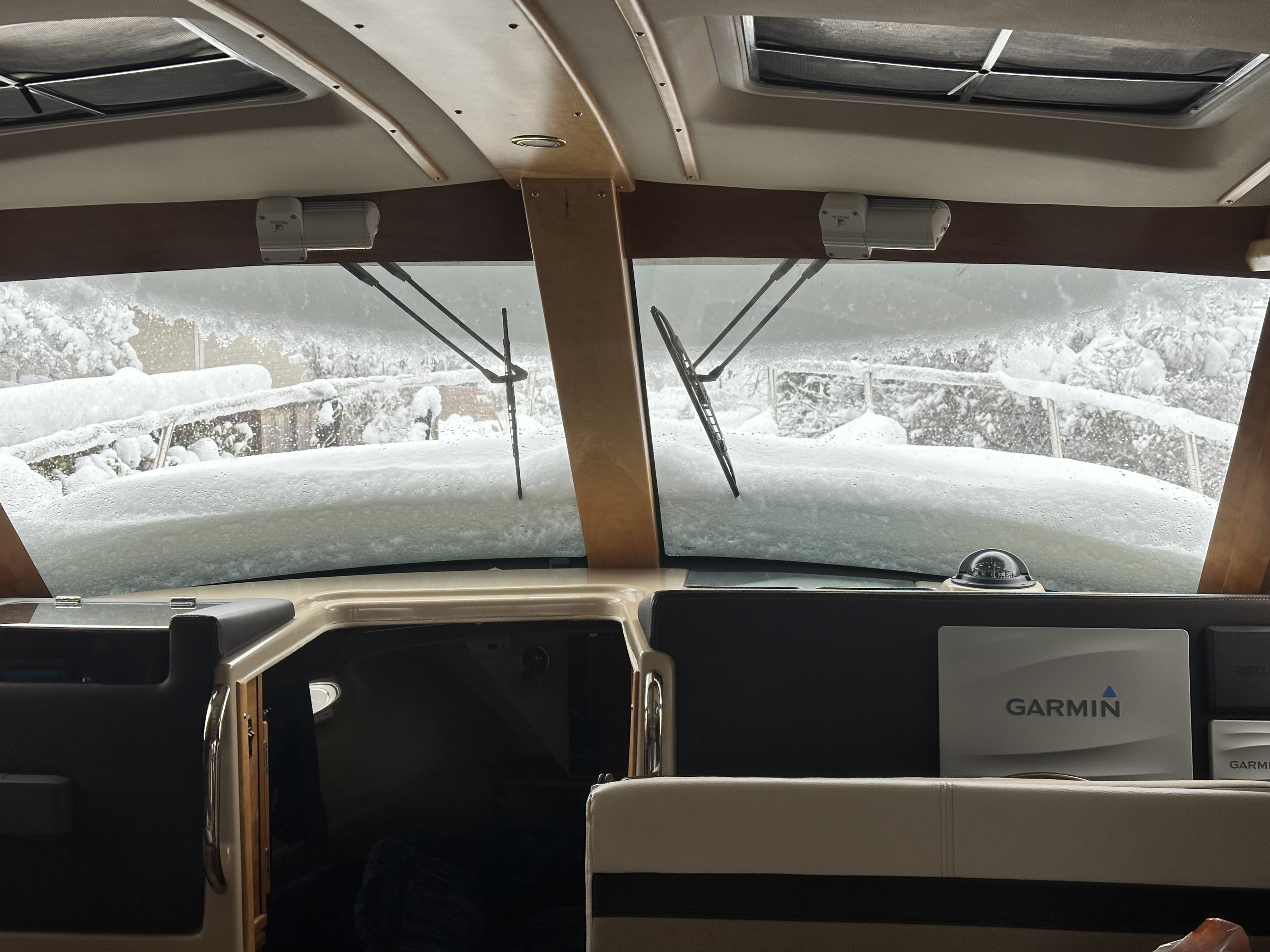

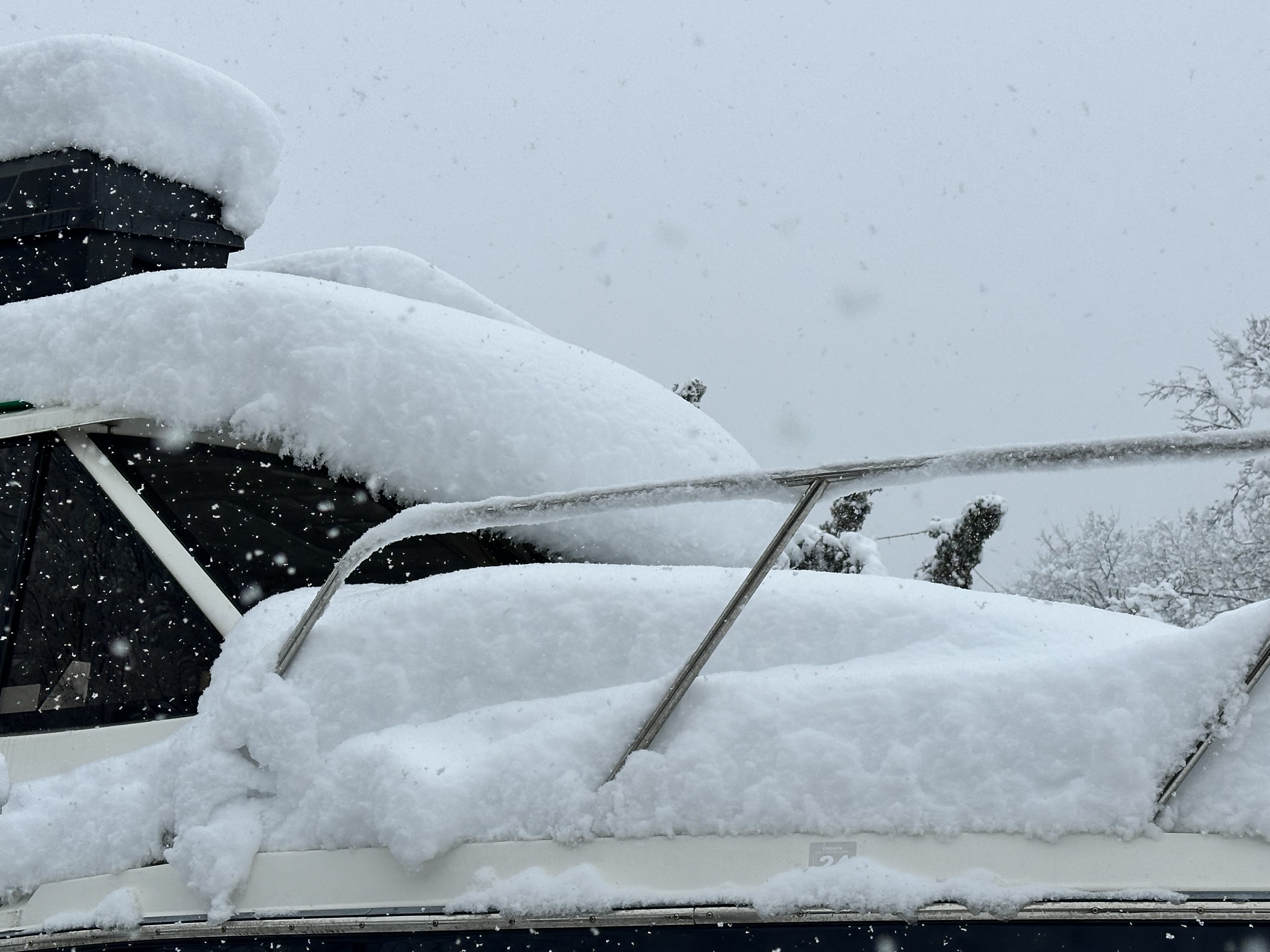

I must be pretty darn close. Ten inches so far and still snowing!
Was worried about that Jan 2022, 10" snow on a C26. Survived.
Wild guesstimate: (25cm = 0.25 M) x (~20 M^2 surface area) = 5.0 M^3 of snow!
Density fresh/wet is 200 kg/m^3 = 1000 Kg. "5-man equivalent". Not too worried.
(Density melting/wet is up to 800 kg/m^3 = 4000 Kg. "20-man equivalent". Getting pretty iffy.)
