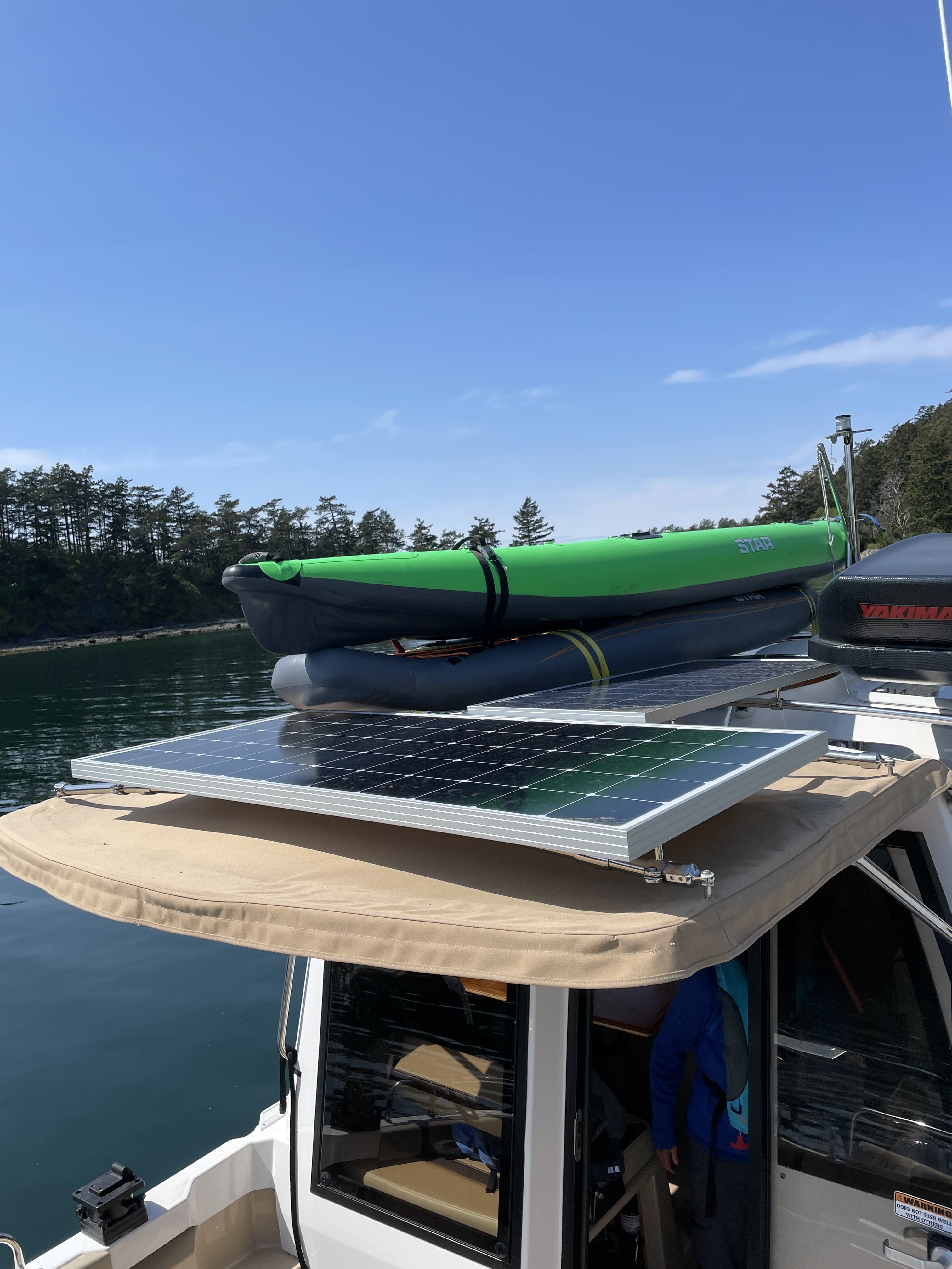

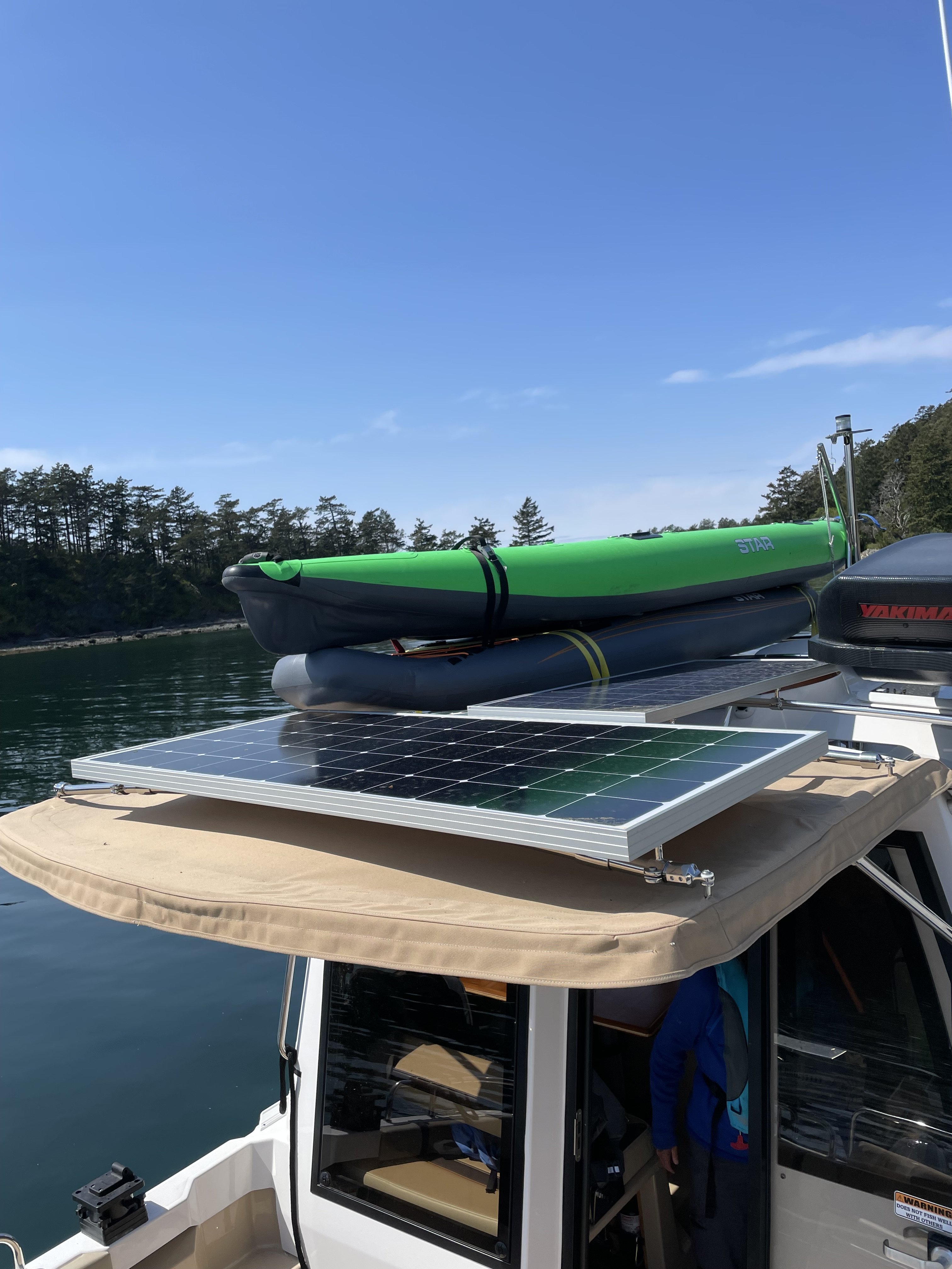

One of my winter projects is to replace all 6 batteries, and add 2 200 Renogy Flex panels on top of my Command Bridge Bimini, run the 10AWG down to the Port side lazarrette where the house bank is, install a Rover 40 Amp MPPT with Bluetooth. This will be seperate from the factory 135 panel that is basically useless, and will be run from the MPPT to the AGM House bank. We also have a Cummins generator, so that will take care of the start and thrust banks while we are making hot water. Our use is primarily on our mooring in Avalon, so solar power is key. Had the same set up on my Mainship Pilot 30, house bank was full by 10am every AM! Flex panels degrade after 5 years, but so does the Bimini/Stratoglass, so it all gets changed out at the same time.
Very nice. Where, If I can ask, did you get your fittings and frame parts?
