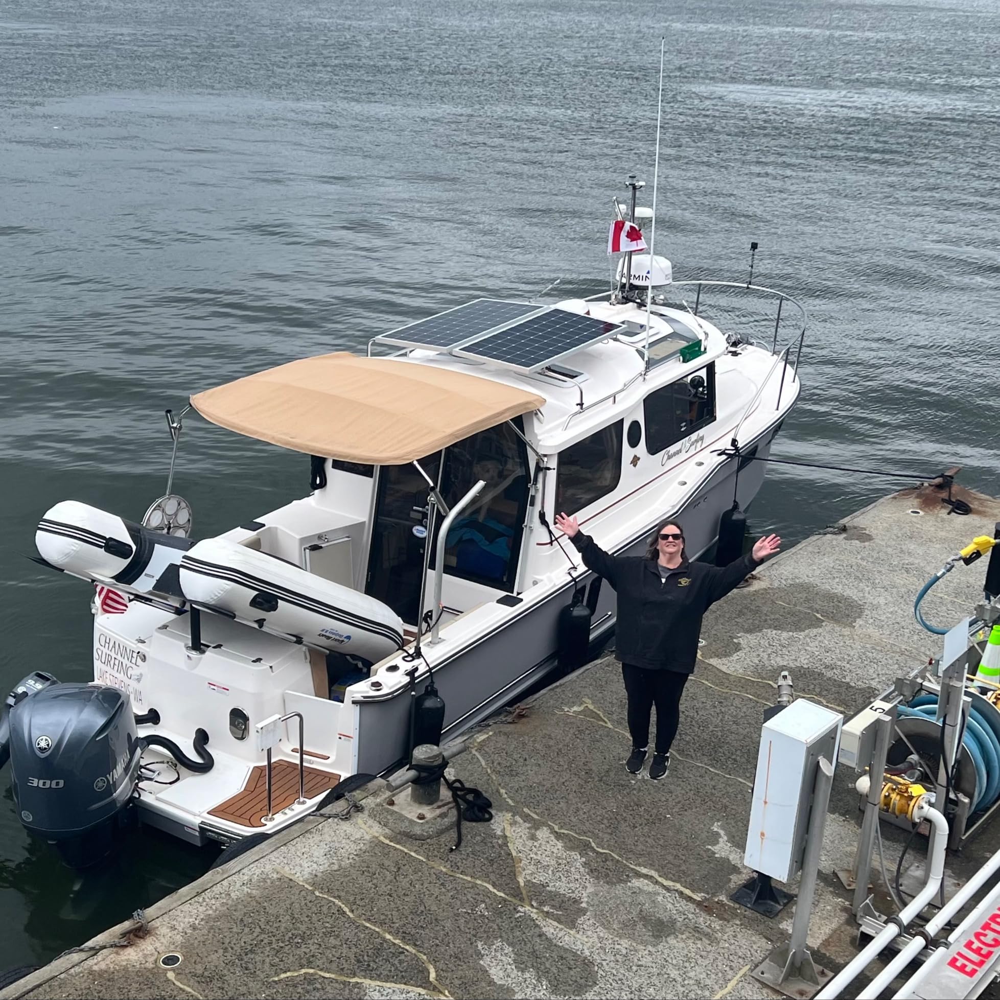

504 watt-hours is small. You don't mention whether you're getting a NW edition or Luxury Edition (which would have LFP). I'm assuming based on your post that it's a NW edition with AGM batteries. Two 110ah AGM batteries (which are standard on a NW edition R27-OB) offers 1200 watt-hours (usable). (99 amp-hours usable).
Most folks go with something around 1200-1600 watt-hours in a Bluetti or Anker and just plug it into their shorepower connection. The boat then operates 120volt AC as if it were on shorepower. To run the hot water heater for 45 minutes (which is plenty of time to make enough hot water for showers and such) is 600 watt-hours. If you ran the water heater until it heats up 6.5 gallons of water to 167 degrees, it'll consume about 1,600 watt-hours.
I always recommend a solar upgrade on the boat. The refrigerator is one of the largest load on the boat and will consume about 45 amp-hours a day from the 99 usable amp hours available. A solar upgrade to somewhere between 270 and 400 watts makes a world of difference. Then use a Blueti or Anker 1200 watt-hour LFP bank, plugged into the shorepower connection for running the microwave, coffee machine and water heater. It'll give you a few extra days away from the dock. Then just recharge the LFP bank on the dock. I am not a fan of the solar panels that plugs into these portable LFP banks. It creates two solar systems on the boat, one for the boat, one for the LFP battery. If you're going on a longer cruise, I'd recommend using the 120 watt car charger accessory to trickle charge it, which lets solar on the boat help charge the LFP battery. A battery monitor on the boat will give you the info you need (battery SOC) so you know when you have a surplus of sunshine to use.

in 8 years of boat ownership I have never used the inverter. we anchor out for days. we cruise for weeks at a time. we move anchorages and marinas either every other day or every day. That gives us all the hot water we need. Or I can pop the hot water heater on before we leave the dock. it stays hot for 18 hours.
we have diesel heat. we use propane on the stove and BBQ. we have 340Ws of solar. we run starlink during the day. I charge devices during the day when solar is putting out the juice. we have LED lightbulbs everywhere including the anchor light.
If its sunny we can be fully charged after the night by lunchtime. If I was to use the microwave I would run the engine and then use the microwave as its use is so low.

Great illustration of how folks with similar boats boat differently. When someone's getting a new boat I always recommend they go out and use the boat before dropping large amounts of money into upgrades. A battery monitor and solar upgrade are both no brainers. Figure out how you and your family are going to use the boat, then focus on upgrading what's important to you.
When we purchased Channel Surfing, standing in the showroom at the boat show, I stated repeatedly that we would use it for day trips mostly, with an occasional overnight weekend trip, and maybe a 10 day cruise once a year. Oh how wrong I was.

As several have mentioned, adding a bigger solar panel (350-450 watt) with a good Victron Energy solar controller would be the best bang for your buck.
I assume your boat has lithium batteries on all banks. If not, converting to lithium is expensive but effective.
Finally, once you are lithium add more batteries to the house bank. Two or even three more if you can get them to fit. Not a huge weight penalty.
