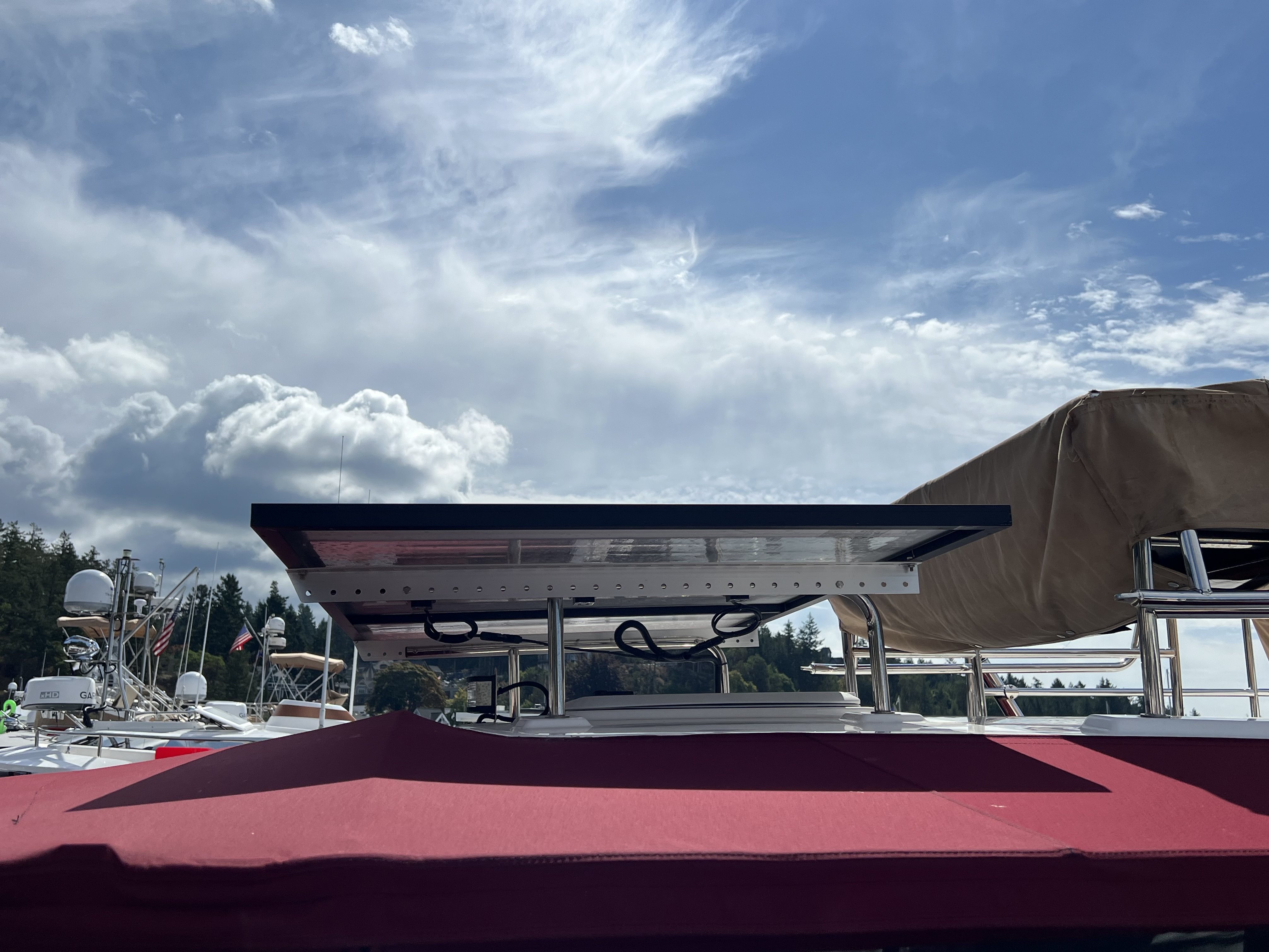

Requires some work with the 1" bars, but turn the panels 90 degrees. I know of at least one boat running a pair of 160 watt panels for 320 watts total. (they're running my original 160 watt panel that I upgraded to 2x210 watt).

When I upgraded to a larger panel, I needed longer rails but also wanted to move the panel higher and further aft to avoid shading from the aft bench seat on the CB. I created a second level attached to the existing rails and the bench frame. This allowed me to move the solar panel out of the shadow. I installed a 220w panel because anything larger would have blocked the rocket launchers, but if you're not worried about rod storage, it could handle more panels.

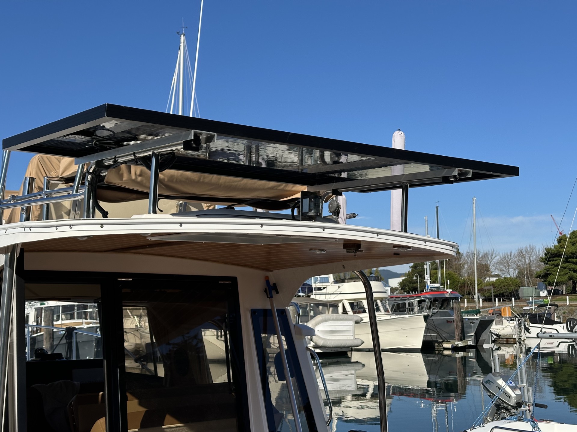

This is a 400 watt panel on an R29-CB.

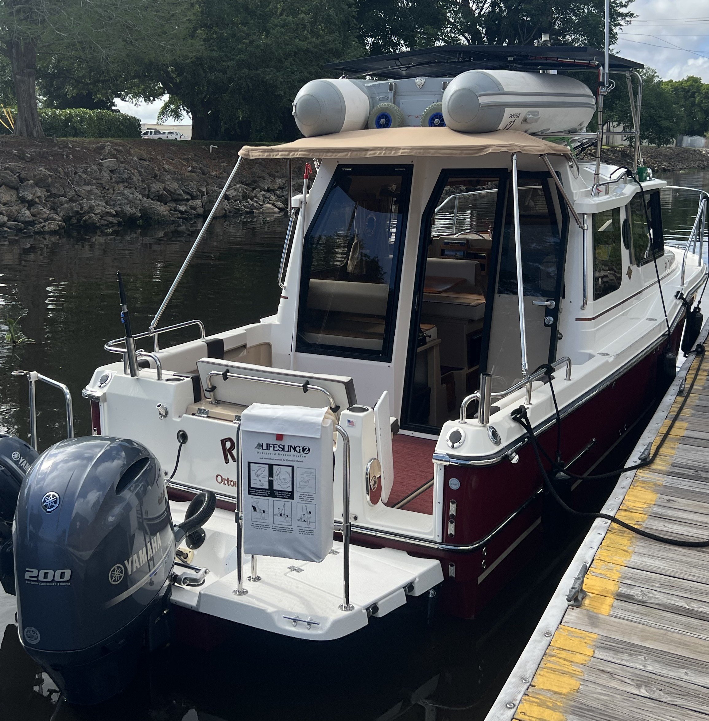

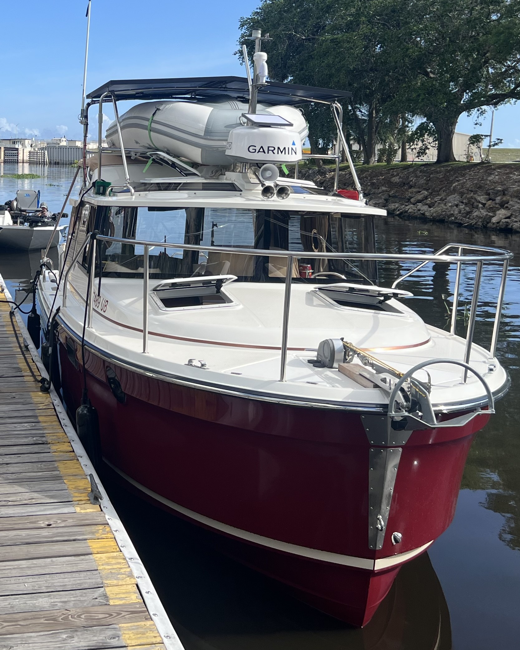

We installed two 300W BougeRv bifacial in series. Since we lifted the rack 20.5" to accommodate our inflatable, we have clear sun producing over 65V and a boatload of Watts...

Nice setup az9133bm. A great example of maximizing the capabilities (solar and dinghy storage in particular) of our relatively small but capable boats. Do you stow/remove the dinghy forward or aft?
Aft. You'll notice that we added 4' stainless tubing to the bimini structure to support the extra weight. We slide the Zodiac aft, the transom of the Zodiac lands on the swim platform (boat is vertical pointing up), we cartwheel it to port side of Ruby and straight into the water. To recover, we reverse the process.

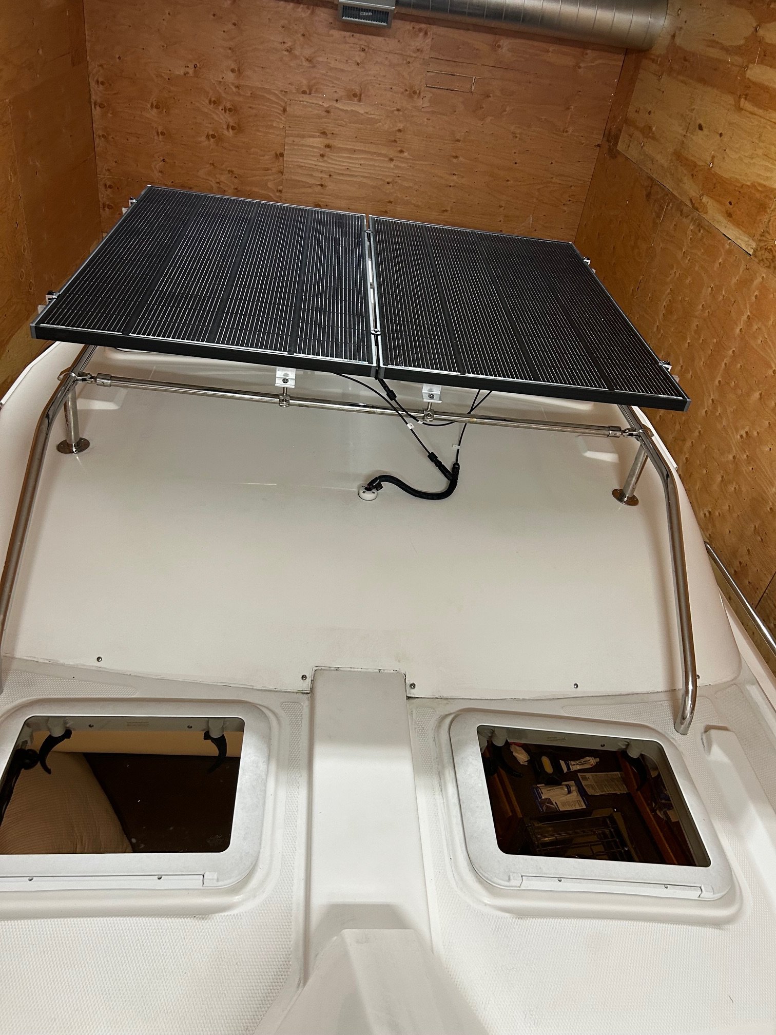

I'm in the process of installing two 200W Renogy Shadowflux panels on my R29S. I used Gemini hinged split side rail mounts and IronRidge Solar Racking and Mounts for the installation. The IronRidge parts included the XR100 Rail, UFO Universal Mid Clamp for XR Rails, EFO Universal End Clamps for XR Rails, and the Slotted L Foot. I'll be adding two more Gemini mounts and a Slotted L Foot. The result so far has been a very stout installation. All materials are aluminum, except the Gemini rail mounts, which are SS.

As you can see from the photo, the Gemini mounts attach to the 1" SS horizontal rail. The IronRidge Slotted L-Foot is attached to the Gemini mount. The Slotted L-Foot is connected to the XR100 Rail. Then the end clamps and mid clamps attach to the XR100 rail. I purchased all the IronRidge parts at a local solar panel dealer in Anchorage. You can check out the IronRidge components at https://www.ironridge.com/ Although the solar panels extend over the SS handrail, the IronRidge components help raise the panels about six inches over the guardrail. I don't have any additional photos at this time. I will be at the boat next week and will take more photos. I've also installed a Victron 100/30 controller to replace the factory installed controller, and wired the panels in series. The boat is in storage at the moment, so I have not tested the system outdoors.

I have a R-29CB and opted for a smaller BougeRV 300 watt panel which fit better in the existing space. 400 watts would still fit but overhang more. You do get occasional shading from the seat if the sun is lower coming over the bow. I don’t see a problem with mounting higher — mostly an aesthetic choice. The BougeRV panels have two zones which helps some with shading. Replacing with an MPPT charge controller is important for a larger panel. On sunny days I easily get enough to replenish my overnight use (<1kWh), which effectively gives me unlimited power. With a lithium house battery (I have 300ah Epoch dual use — can also start engine in a pinch), I can go 3 days without any charging at all.
