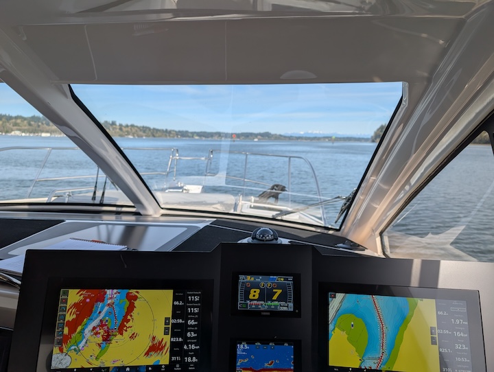

Does the 250 have the Yamaha display that includes the float-based fuel gauge? It's the blue bars in the top center display on our 310 here:
If so, what does that show as the fuel is backing up? One of our tanks needs a short "break" where I remove the pump after it gets about half full before we can continue filling it up at certain marinas based on fuel flow rates.
