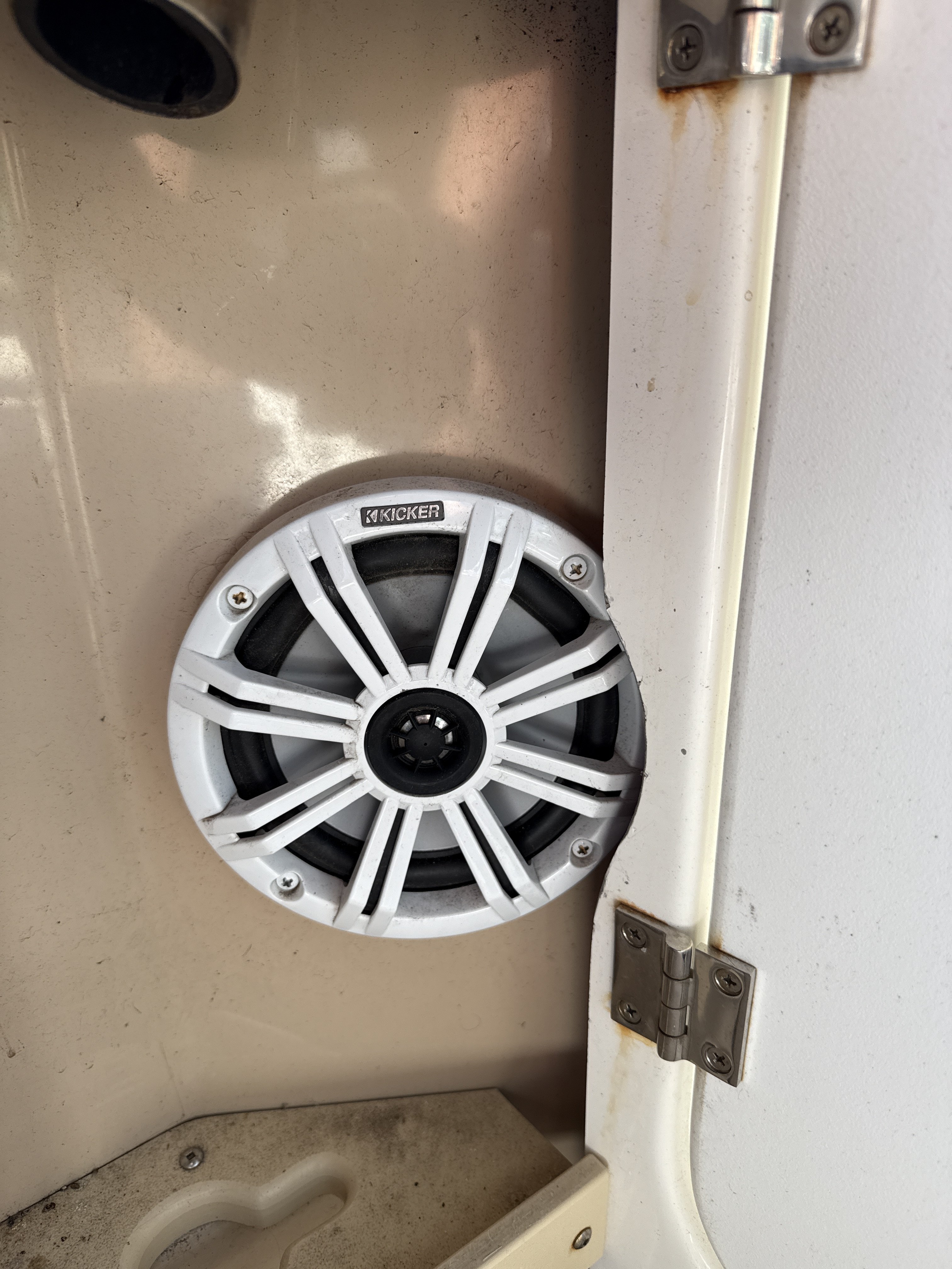

For the cockpit speakers, I went with some Kicker 45KM654 6.5” speakers. They sound great but the starboard side install was a bear! The area where these go is really, really shallow. The Kickers are too deep so you need a 1/2” spacer between the speaker and the boat fiberglass. You also need to enlarge the speaker opening a bit for the Kickers but that wasn’t difficult. If I were to do it again I’dimage.jpg get a super shallow speaker.

Not much base from the Kickers. If you want more base I think a 10” JL Audio M3 subwoofer would be the way to go. IF you can find a place for it! I had the JL Audio marine speakers in the R-25 Classic and really liked them. They are deep speakers and just wouldn’t fit in the C-28 spaces.
I just replaced my cockpit speakers with some kickers didn’t feel like cutting the holes out bigger. Now for subs Iv been really tempted, I think you could fit one under the port side cockpit step or under the helm seat on the c28
