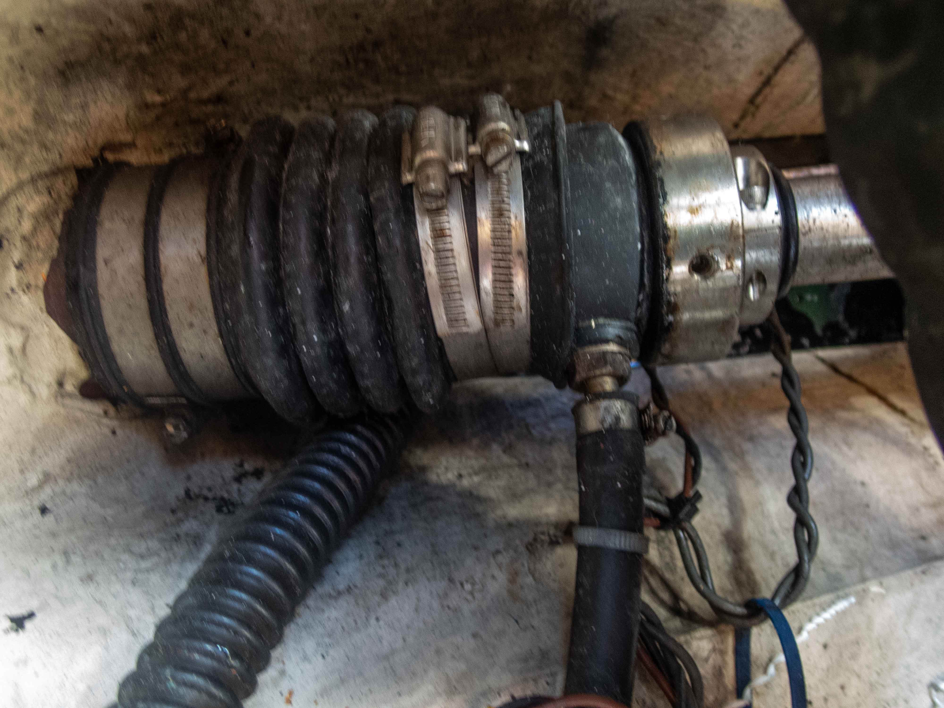

Early in our adoption of our Ranger, we developed a very slight leak in the shaft log, dripping just a bit faster than it should. Turns out, with about 400 hours, the packing needed renewal. We just could not get to the shaft to do the job.
We determined to have the conventional shaft log replaced with the dripless shaft seal the previous owner had purchased but never installed. The yard removed the shaft, tested it for true (it was) and replaced the shaft log, charging us about 2 labor hours and saving me hours of pain from the twisting needed to remove the old seal.
The unit, shown below, is about 6 inches long including the bellows that were reused in the installation. It has worked without a drip for about a drip for over 600 hours.
I struggled to post the image of the installed dripless shaft seal. It is at:
http://www.shearwater-sailing.com/wp-co ... r-IV-2.jpg
and can be see on the web site at:
http://www.shearwater-sailing.com/index ... rwater-iv/
