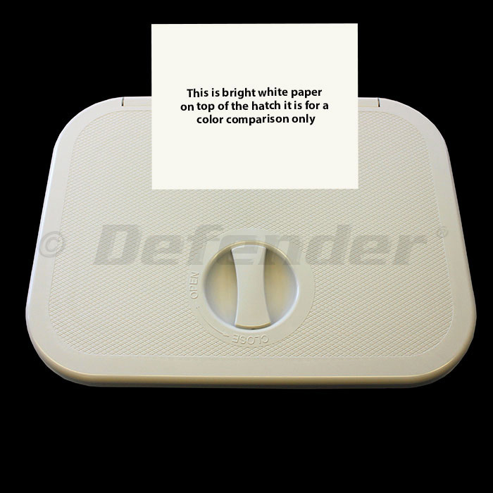

I wonder if installing a twist out deck plate in a strategic location for the stern thruster as a retro-fit in the swim platform may be an answer. Here is what I am talking about on the defender site. http://www.defender.com/product.jsp?path=-1|6880|48504&id=45449
Good thinking. A couple of 'pie plates' would work, one either side of the thruster, or you could use a single rectangular hatch mounted directly above it (this type):
