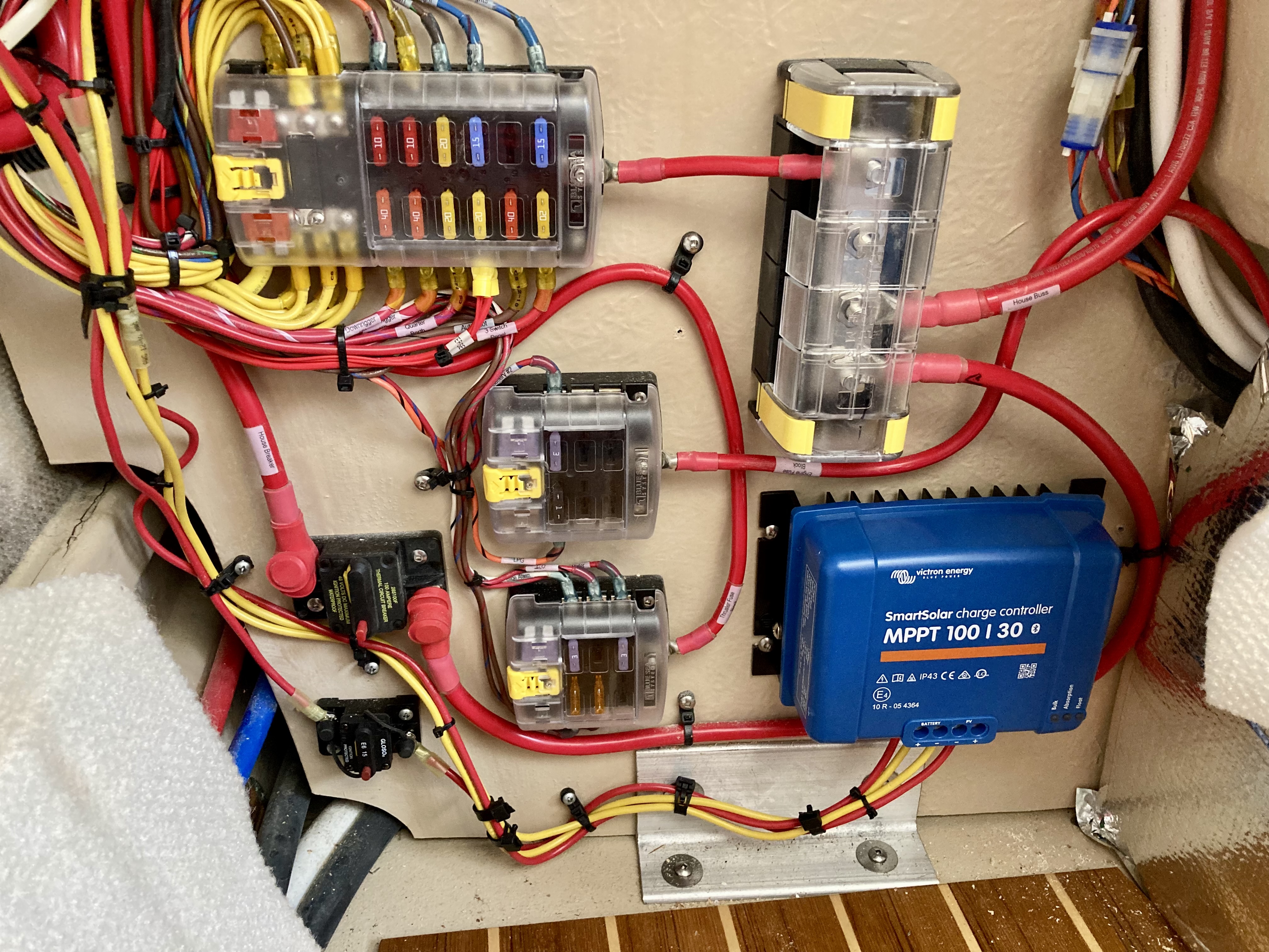

I gave up on my sunsaver controller on my R31 and bought a Victron SmartSolar MPPT controller instead. It's been great and the Bluetooth monitoring is beneficial.
Upgrading from the Sunsaver Duo, which is a PWM style solar controller… to an MPPT style controller, such as the Victron SmartSolar MPPT controller will capture 20% more sunshine from the panel you already have. Plus, the Victron will give you fantastic instrumentation on how much solar you’re getting. Just as an FYI.

At age 69 a few years back, I upgraded our new to us C-28 from the stock Sunsaver Duo to the VE 100/30 controller. The Sunsaver had 2 wires as inputs and 3 as outputs. Put a heavy blanket over the solar panel. Mounted the VE in the same space as the SSD was in, reconnected the 2 inputs and the + & - leads to the house battery and capped the 3rd output wire. Added the VE app to my phone and set the VE Controller up. Took an hour going slow. If all you are doing is replacing the solar controller it’s easy.
Beautiful installation.
