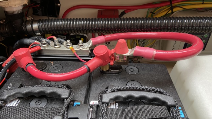

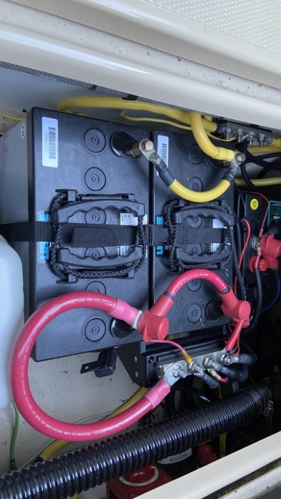

Installed two new Lifeline Group 27 batteries (100 amp hours each). Also took the opportunity to clean up my battery terminal wiring and move everything to a bus bar. I made a mount from some starboard and it turned out pretty nice. Also made sure the batteries were wired 'opposite' to hopefully keep the load evenly spread across them both.

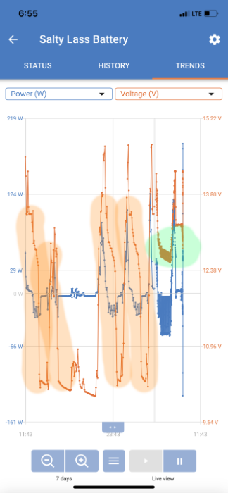

With the old batteries, the voltage would drop off a cliff each night down to below 10v, and then the solar panel would charge them back up the next day. With the new batteries, there is a nice flat line and voltage stays up above 12.4v all of the time.
You need to install a fuse between the positive post on your battery and the bus bar. The easiest is a Blue Sea battery terminal fuse block for MRBF fuses (Blue Sea part # 5191) since you can install it without changing the wires. The ABYC guidelines require a battery bank fuse within 7" of the batteries for house banks. The fuse holder and a couple of fuses will cost you $70-$80. Size the fuse for your biggest load (likely the microwave). I would probably go with a 200 amp fuse which would protect your wiring and not be at risk of nuisance blows. The install will take less than 5 minutes.
Thanks Todd - I knew an eagled-eyed Tugnutter would call this out. I have an ANL fuse & fuse block and was waiting on the additional battery cable to install it (boat is just sitting in my driveway at the moment waiting to go back in the water). I didnt know about the terminal mount style fuses though and I kind of like that approach (one less thing to mount/wire to route). Thanks for the tip!

I forgot to reply here, but lest anyone think we are boating around freewheelin' and fuse-less, I followed @Todd_D's advice and used the MRBF battery terminal fuse block - no additional battery cable required.
I didnt know this part existed, so thanks again Tugnuts for the info.
Good to see the Overcurrent protection on the battery cable -
But your bus bar also needs to have a cover of some sort to prevent accidental shorting (i.e. a dropped wrench or similar)
ABYC E-11 spec:
11.5.2.8 Continuously energized parts, such as positive battery terminals and both ends of all wires connected thereto, shall be physically protected to prevent accidental short circuits. Protection shall cover all energized surfaces (e.g., boots)
