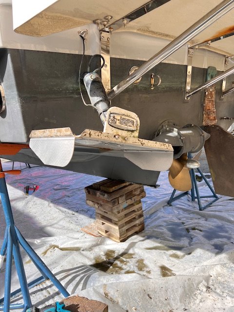

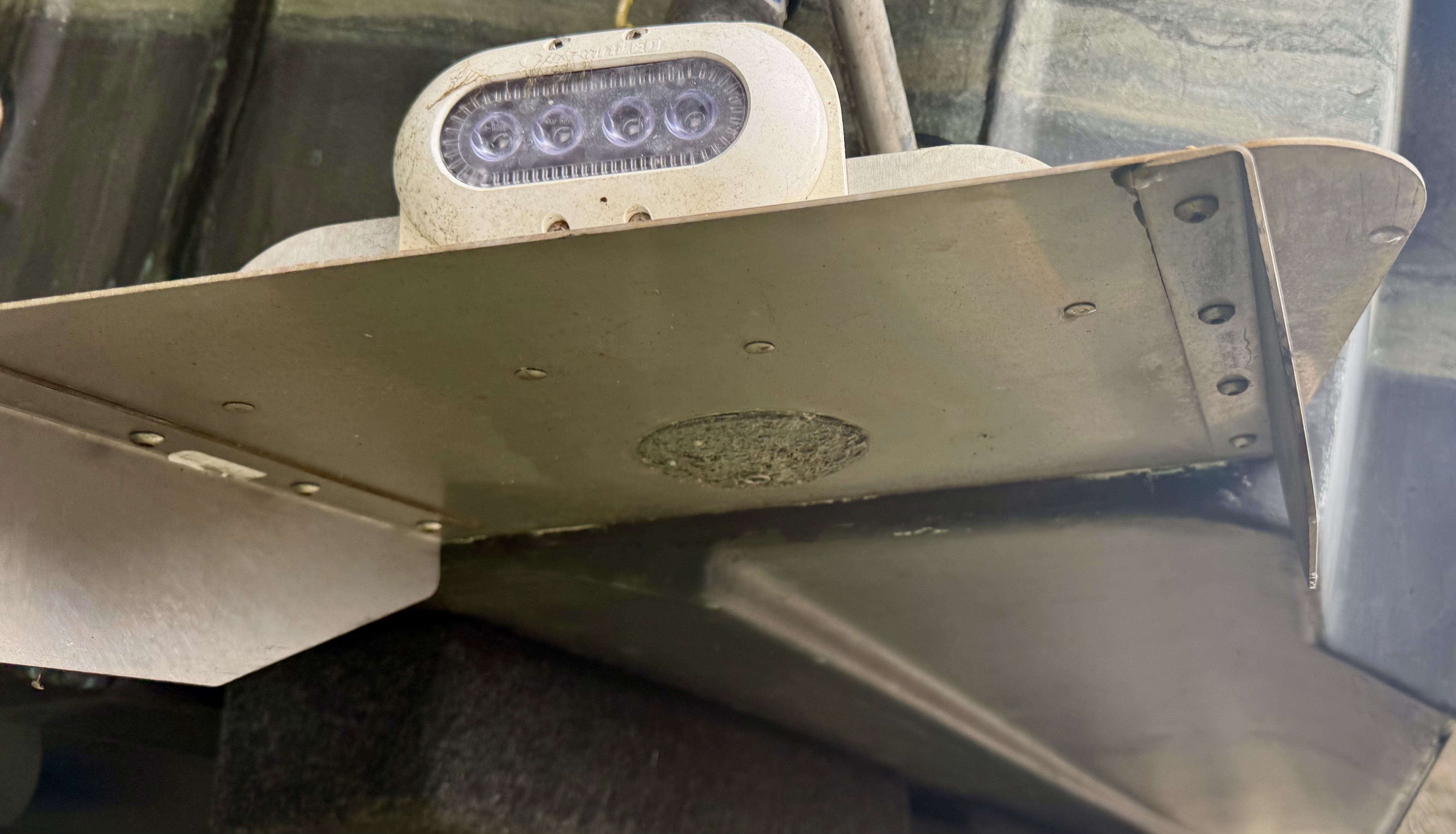

Adding drop fins sure helped my 2021 R31S
Like Steve says add drop fins.
You will be happy with the results.

First, make sure your trim tabs are the correct size for your boat. Search Bennett trim tab sizing on the web. You will see this:
Boat Length Tab Size Recommended
25’-31’ (7.6-9.1 m) 12”x24” or 9”x30” or 12”x30”
Then add drop fins parallel to the keel. Not parallel to the tabs themselves as mentioned above. FM has a history of providing undersized tabs on stern heavy boats. Not a good combo.
Also helps to move as much weight forward in the boat as you can.
Different boat (C-28) but drop fins helped a lot with trim. Easy to install. I just aligned mine to the edges of the tab but Brian Brown had a good post about installing them so they are inline with the water flow when the fins are down. https://www.tugnuts.com/threads/mod...-bennett-drop-fin-and-spacer.9262/#post-68056
Wow, super helpful. The boat I'm looking at already has spacers on the trim tabs, but neither the broker nor the surveyor knew why. Looks like they got started on fixing the issue, just need to finish it with down fins. Thanks for the help. Much appreciated.
