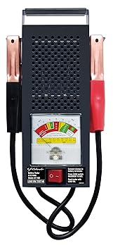

I first did a load test, with batteries disconnected from circuit, with a Schumacher Load Tester:
Both house batteries came up with same reading.
After replacement, I took both batteries home and did a load test as follows:
Hooked up a 2 amp DC load and battery one ran for about 40 hours; i think you could say this battery was good for 80 amp hours, and maybe could have had some more serviceable life in the boat.
Battery two ran for 4 hours, so i think this was rated at 8 amp hours. this battery went to the recycler.
