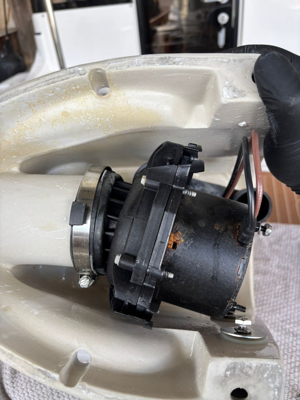

I just had this last fall fall. The motor bearing has has 1 seal between it and the salt water. Any leaking of the seal causes the bearings to fail and fuse to blow. Replacing the motor/pump assembly is the only answer since this particular toilet is now no longer sold.
Yep, motor froze and needed replacement,

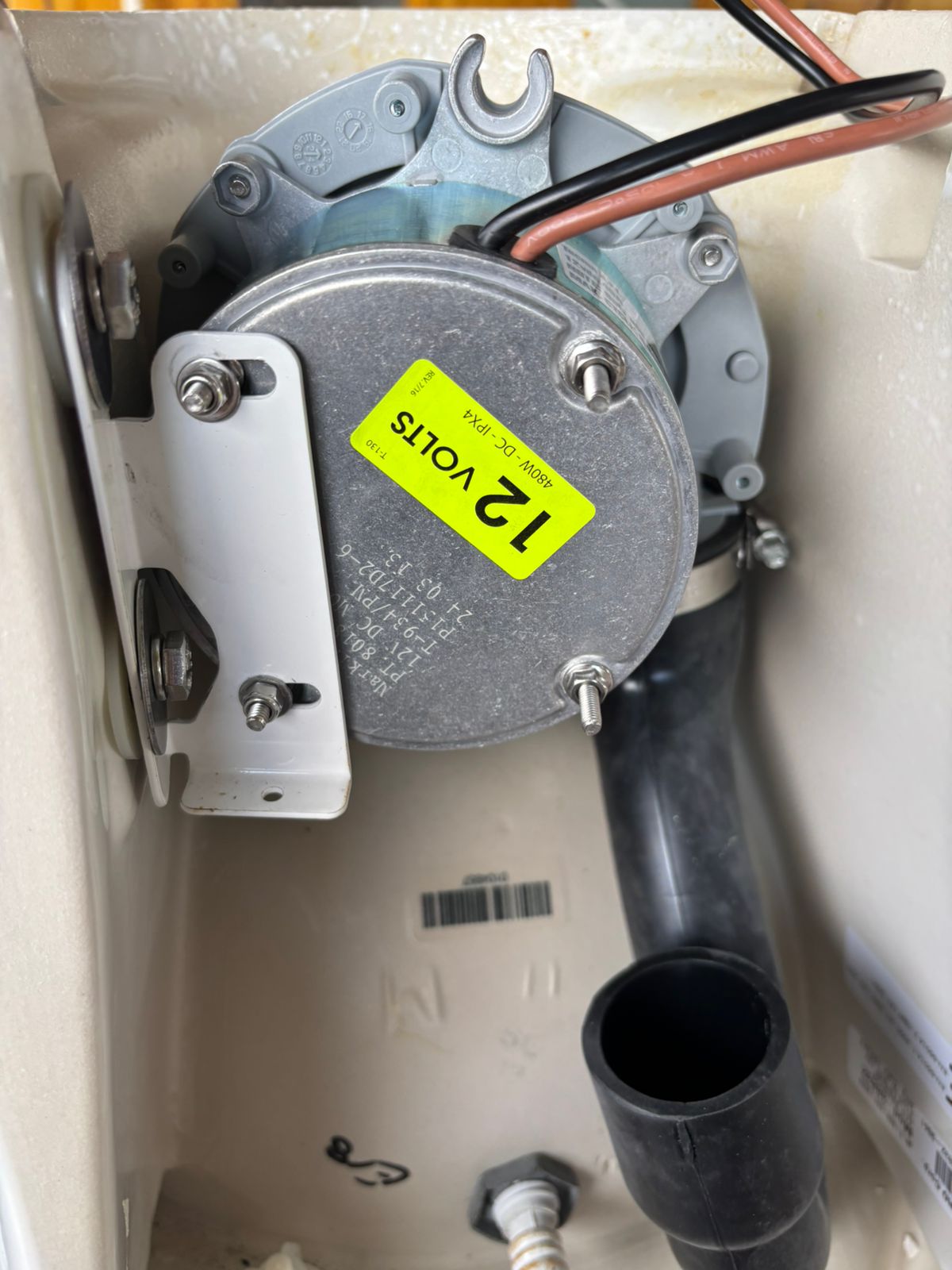

Following up on this thread. Thanks Rocky Lou and SKing. My toilet flush is working 100% now.
I received the Tecma pump last week and I replaced yesterday. I thought the job would be level hard (8 out of 10), but it was level easy (3-4). It took me less than 2 hours to disconnect the 2 hoses, take the toilet out of the head, replace the pump and install back!
