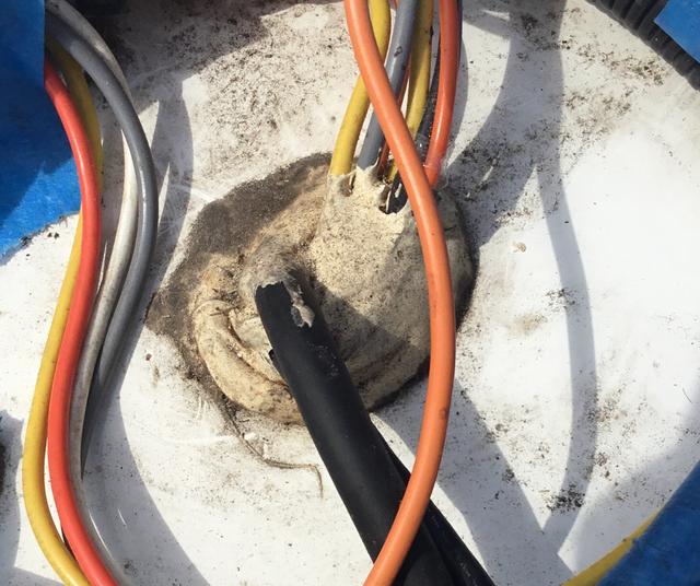

I was unclear in my original post. The sealant I’m talking about is more like putty and it is used to seal around wires and wire bundles coming through roof under the tunnel that runs from the mast back to the stack. The Sikaflex sealer, 3M 4200, and Life Seal is more for sealing and bedding fixtures and such. This photo shows the putty-like substance that encases the spotlight and radar wire bundles coming through roof just aft of the mast. The mast and tunnel are removed in this photo.

I figured out the sealant after I removed a gob of it. It’s caulk. Exactly what kind, I don’t know. I used DAP Dynaflex Ultra to replace it.
