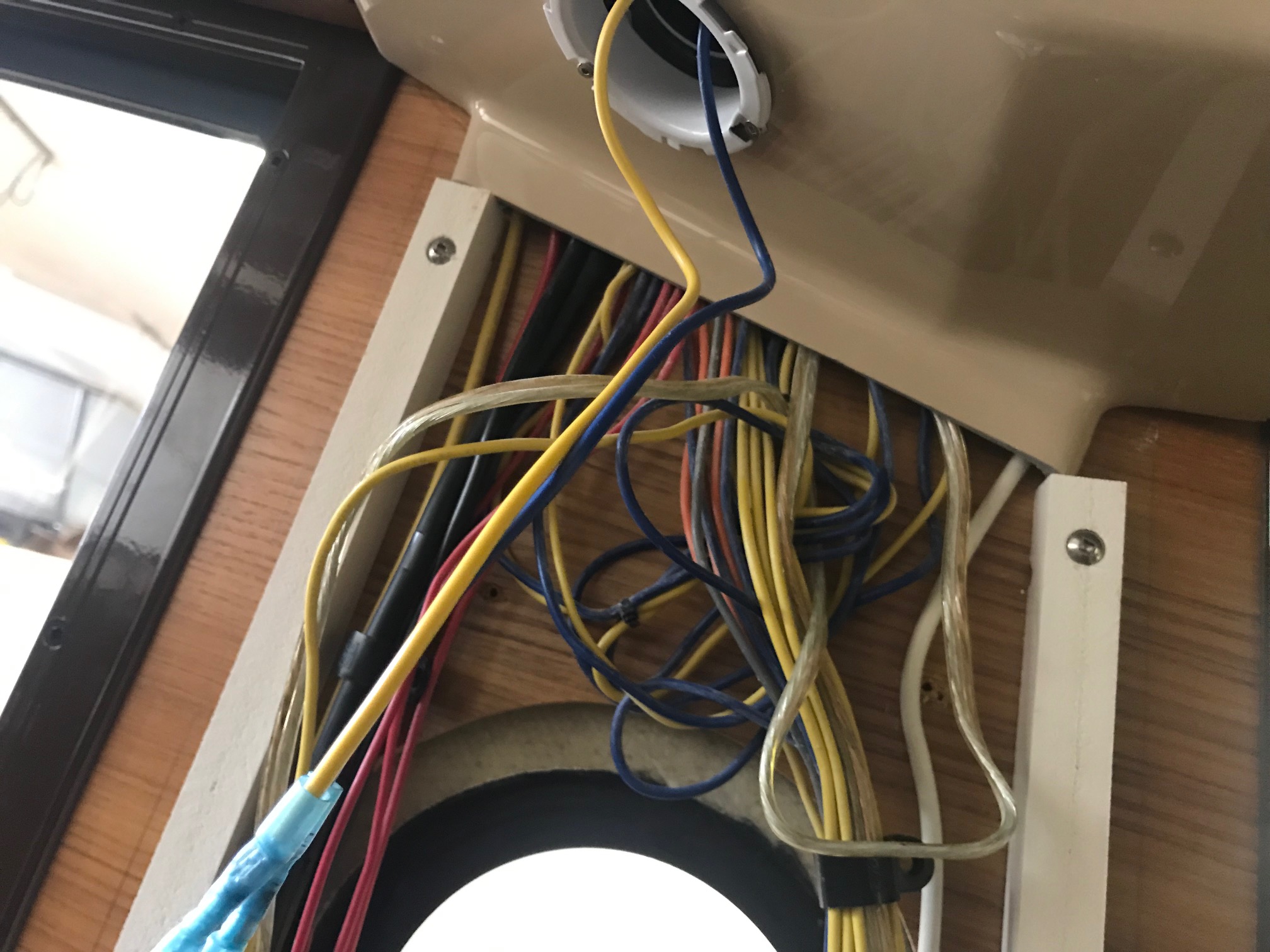

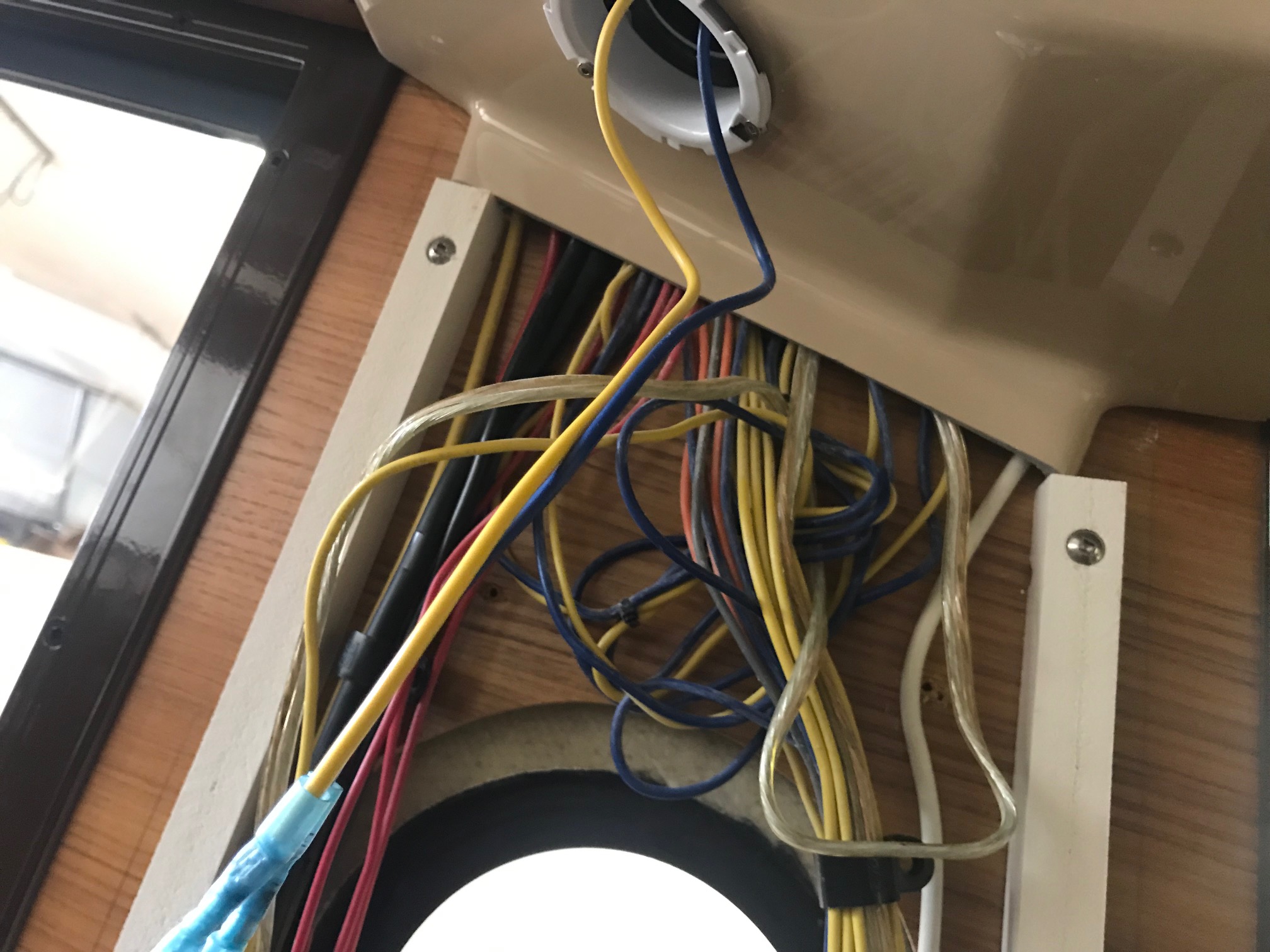

Starboard panel (wire-way):
  • No need to remove the porthole trim.
  • Loosen the base teak trim by removing the screws. You will not be able to remove the base trim yet.
First removal is the hardest. Yes, FM used brad staples...really... As best as you can pry the panel ripping the brads away from the star board behind. There is a solid teak edge trim attached to the teak plywood that is stapled through to the star board behind. Start at the top (this is why removing the recessed light is first step). If you're careful and methodical you can avoid damaging the teak trim and veneer plywood.
  • Once the top of the panel is clear of the light fixture, gently pull up and out.
  • Install four small stainless screws in the teak edge trim to engage the star board to replace the brads and make for easy removal in the future.
  • The technique for installation/removal is "hinge" out/in from the top by just clearing the recessed light fixture base.

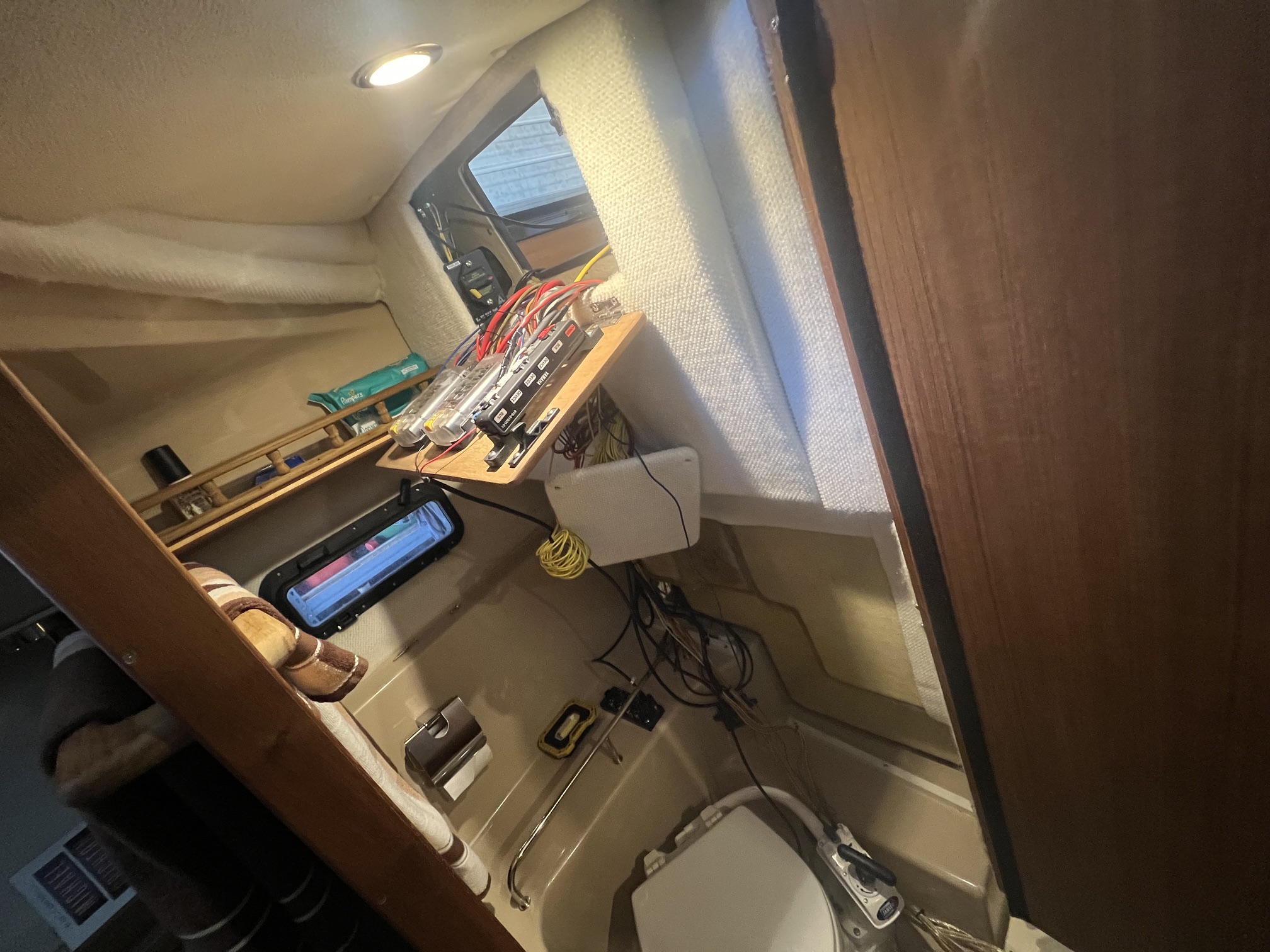

Head bulkhead:
  • Remove bottom shelf behind head by removing screws.
  • Remove bulkhead by removing screws.

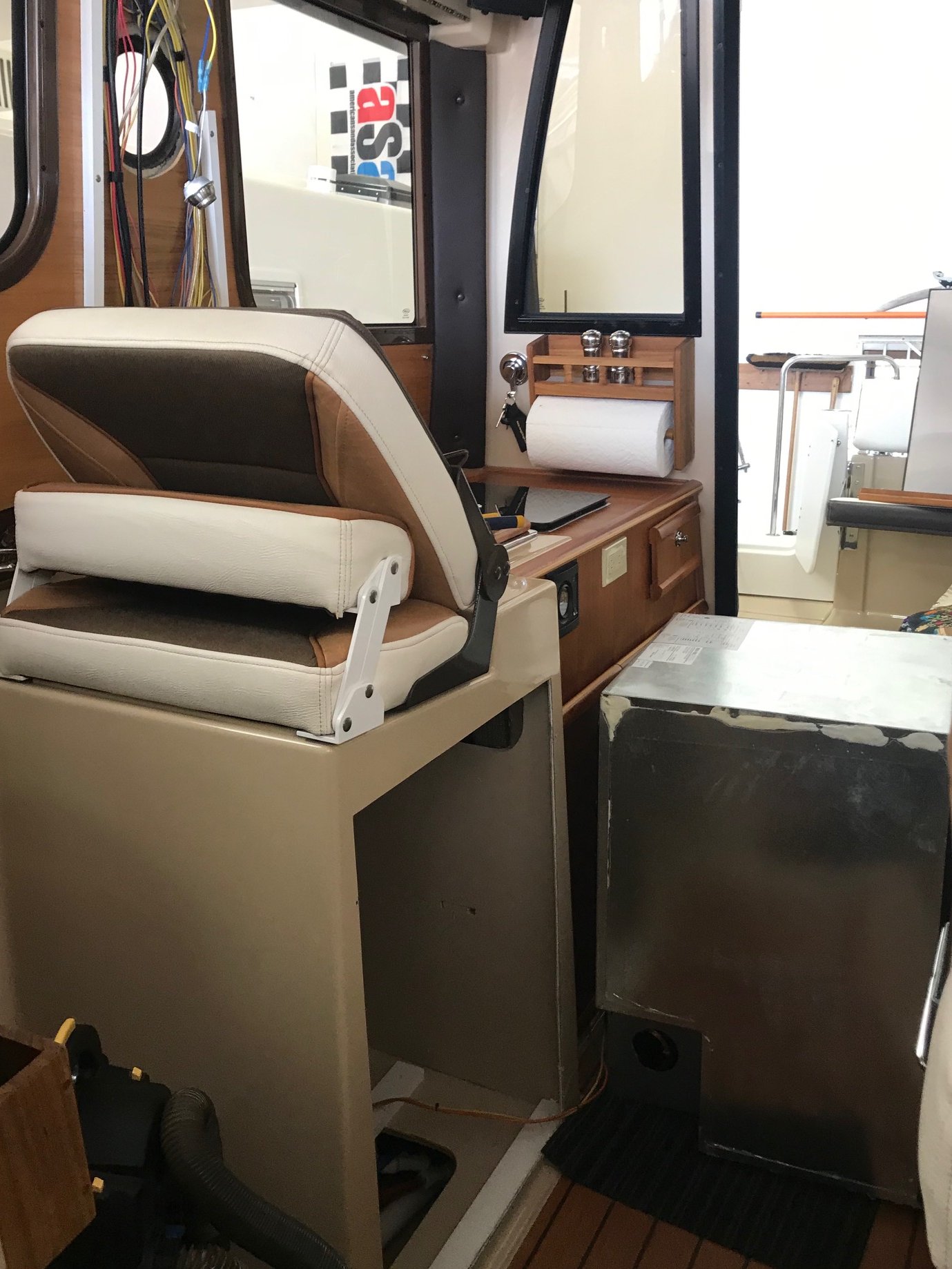

We installed easy access panels for subsequent ease of access:
1. Below the throttle in the helm area.
2. In the head bulkhead.
3. On the main power panel in the cave.

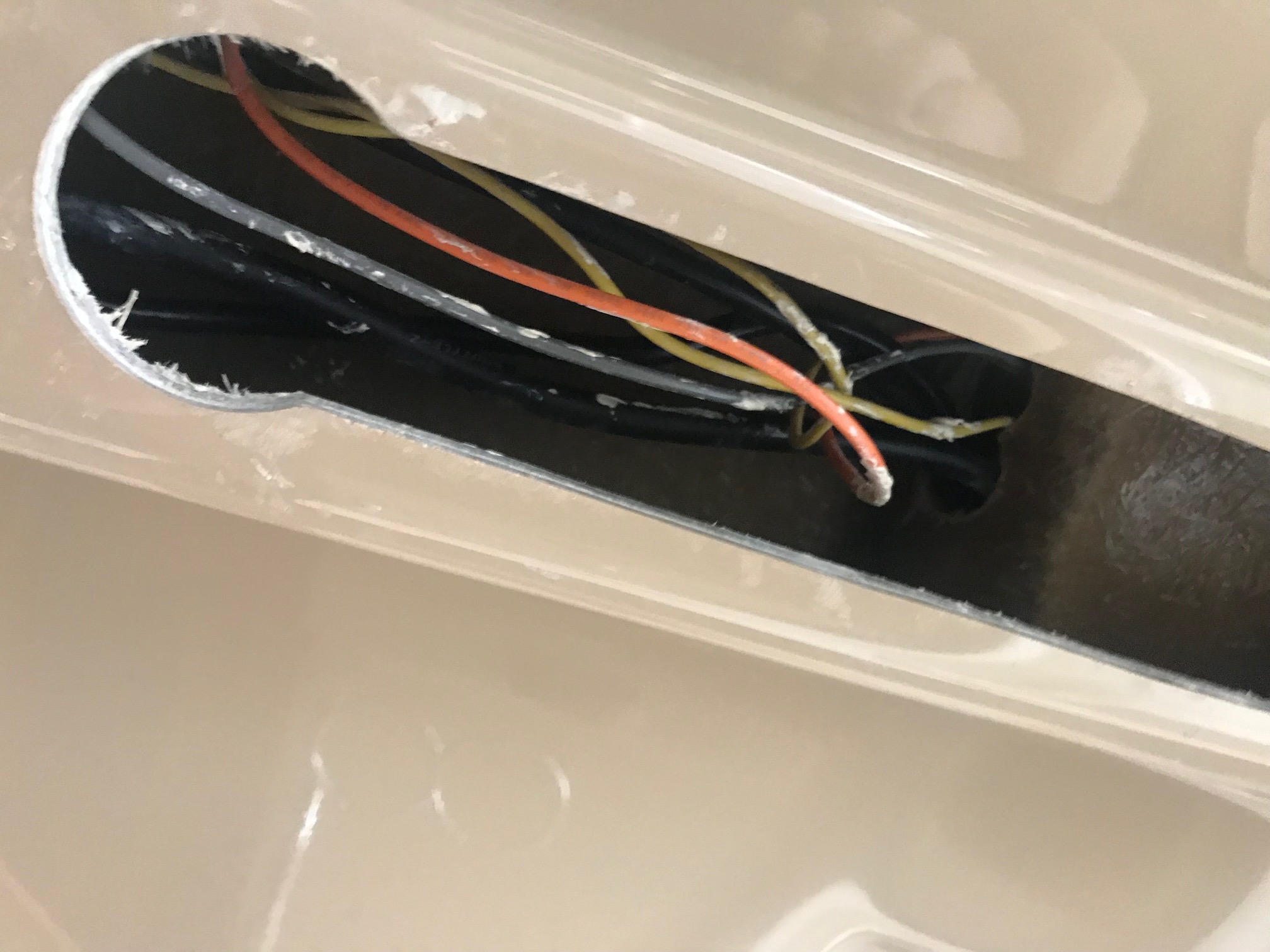

A couple of other points:
1. The wiring harnesses and electrical installation used by FM can only be described as DIRTY DIAPERS; hanging loose, nasty, and ugly.

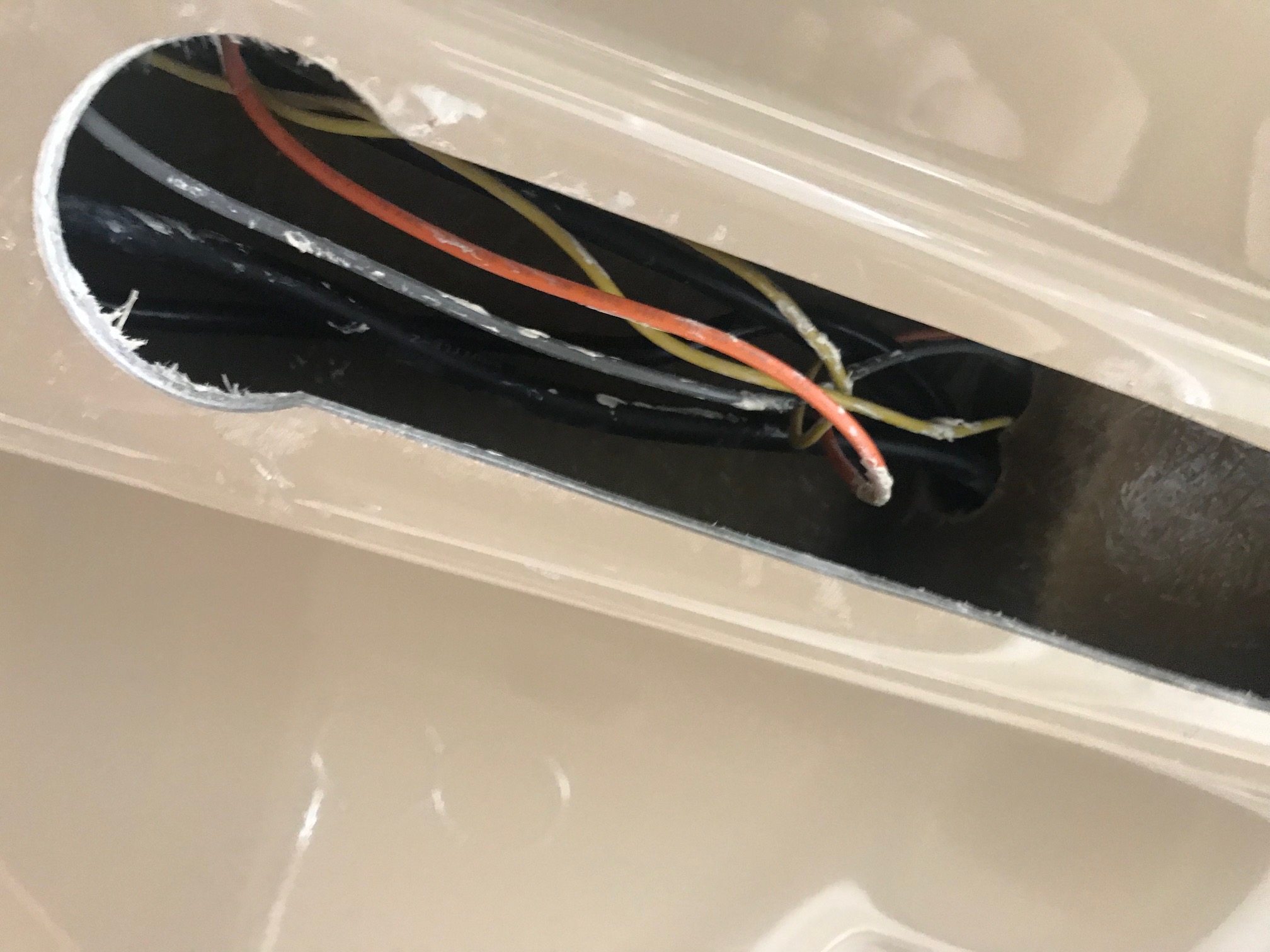

2. The NMNA 2000 bus is inaccessible, mounted in the worse possible place behind the helm station. We moved ours to the area behind the head bulkhead easily accessible through the access panel we installed.
3. Snaking wires between the cabin ceiling liner and the deck between the overhead access and the starboard wire-way is tricky and requires care not to damage existing wires. Removing the trim around the deck hatch can help if the snake gets wedged.

Head bulkhead:
