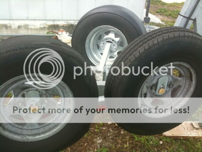

The truck is fine, but the engine will strain. I tow a very heavy R25 (generator, 2hp honda, gear-junk) plus three spare tires. I feel the same about spare tires
as CaptD used to feel about anchors (click on the photo and count them!):
I think one is hidden, he usually has five up front and ready to go. Anyway, I pull everything with an F350 with a V-8 6+ liter gas engine and it does strain at times. I may leave the Tow/Haul automatic under drive button pushed in until she's up to around 55. Then you can revert to standard drive. I would not advise going great distances (say over 5-10 hours) or into the mountains without a diesel engine. If you don't have an 8' bed, extended cab, 4x4 you'll be hauling a little less weight making it go better. I don't have any sway problems, nor does anyone I know with an F250 or 2500– which would be the ideal truck. Oh yeah, I run around 5 mpg. If you can afford the diesel...
