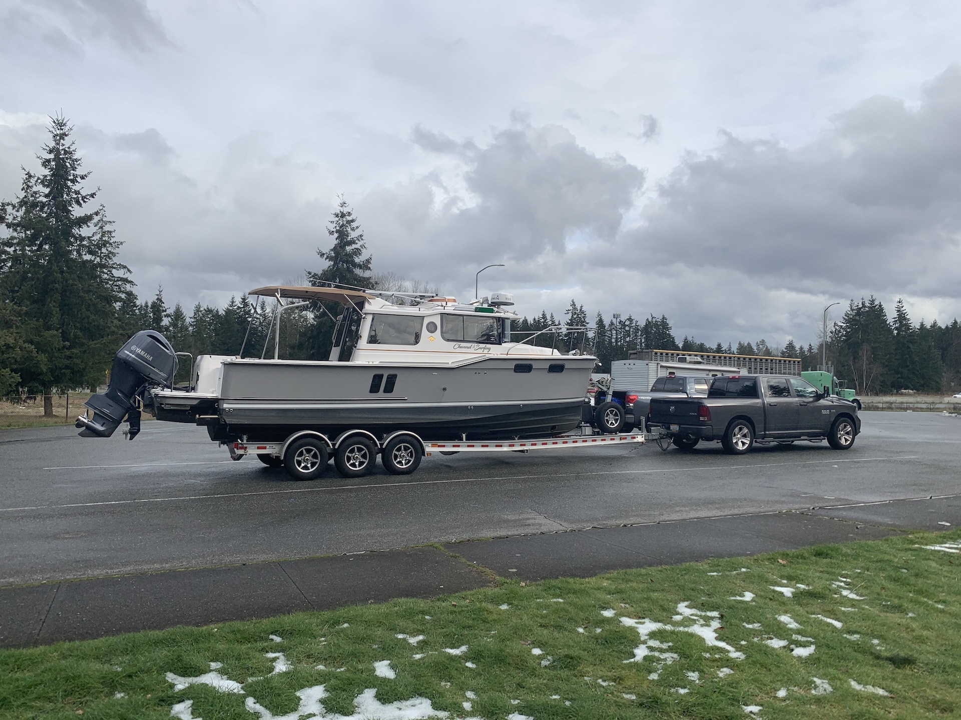

For context, our '21 R27OB on the EZ Loader triple-axle trailer weighs about 11,700 pounds. I have a weight gauge on my hitch that's probably not highly accurate but usually indicates the tongue weight is around 950-1050 pounds.
When we bought the boat, we owned a diesel 1996 Ram 2500. It's a capable tow vehicle but the boat tongue weight would have exceeded the Class 4 hitch's weight rating, GVWR of the truck (which is already heavily loaded), and the GCWR of the two combined. So, we paid the "truck tax" and bought a '19 diesel Ram 3500. It's a world of difference and we've never regretted that.
Martin seems to have made it work! I have the same boat and have towed it from California where I bought back to Wisconsin as well as two trips to Florida with a one ton diesel ram with tow package. No problems even when the brakes failed on my trailer last summer. I am surprised that Marin's bumper isn't dragging on the ground. One time I was just going to tow my boat across the parking lot with my 1/2 ton Ford 150 and gave up hitching up as the bumper kept getting lower and lower to the ground. I would recomend a minimium 3/4 ton and get the diesel if it is available. So much more power! With 1/2 ton you will have trouble stopping it and your front end will float all over the road.
