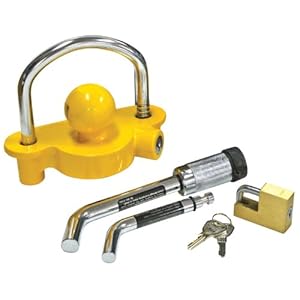

The Reese Towpower kit...
... gives you all you need to lock the trailer up - when hitched or unhitched. And all the locks are keyed alike (one key).

Have you tried the Reese Towpower 72783 Universal Coupler Lock on a UFP type coupler? I looked at these at Amazon and based on the photos was doubtful it's oval steel hoop it would fit around the square UFP coupler.
No, that won't work with a UFP coupler. This from eTrailer should do the job...

When you put the lock on the hitch I found out that it can go one either front side or back side and it looks locked, but if you tug it (sorry about the pun) and bang it hard it will come loose and fall off. Soooo....... false protection. Figure out which side is secure and paint that side so it shows as you look back to the trailer double checking your handy work

The Reese Towpower 7042100 works just fine, but it seems insubstantial. I'll be looking at some of the big full cover types some of you have shared. Thanks for all the input! Before I posted this query I spent a fair amount of time looking for a lock on the web without much luck. You all have opened up multiple possibilities, thanks.

Did reese towpower. Waste of money. U bolt can slip over front of tongue. Marina needed to move trailer. Rather than call they used a hammer on the yellow part. Pot metal broke. Trailer moved. Lock pieces left in trash
