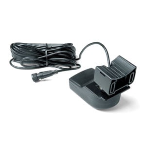

I think I have found it.
I think its a NMEA marineintelliducer
https://buy.garmin.com/en-US/US/p/26511#accessories
A better angle before being cleaned up.
y4mZbE4cyAKOMuraxtgyAHtfEw0FYt7MQ3X7K_17t5VC5pMgptB0repFDSkAEWyn2-Eupx-iY4vD8M5tuYCLHBDULEe7TyfNaCekW3Om2JQ-sRw1L57jz_EmN3r7lboRRibDwvBHa738jIxJljkgybKBlaEVXoEeGD0x_jZiL2B4VgFv_Q5OmuIjMfhZ8lN4ZKAKeDPNUp-XPoRpnl9Szm1TQ
the photo from the website doesnt look quite right
but the one in the installation manual looks spot on.
http://static.garmin.com/pumac/MarineIntelliducers_TransomMountInstallation.pdf
so if it is this device it should appear on my Garmin. which we know it does not.
looks like I need to ensure I have the latest software installed on the garmin gear and that the NMEA cabling is intact.
