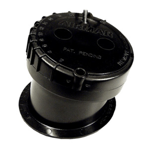

1. As the earlier post indicates, the transducer is mounted to the hull. The transducer may be directly attached to the hull using epoxy (the common method used by ranger/cutwater) but not recommended by the transducer manufacturer. Mine is now attached using the well filled with Propylene glycol. If yours is attached using this method, then you may need to fill the well as it does evaporate or sneak out over time...

5. You may have a defective transducer or GPS unit. My GPS unit has been sent back to Garmin once and now a second time due to these and related technical issues. My transducer was replaced by dealer/cutwater, as it popped off in the first months of ownership (this is the reason why the manufacturer of the transducer does not recommend epoxy, but for some it works).
