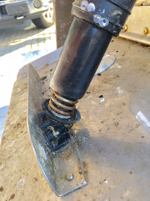

Can anyone tell me the model # of the trim tab on my 2015 R27?
Starboard housing has broken. Does the whole unit need replacing or just the plastic case?
Thanks - Brad
Hi Brad,
Richard at Ranger Tugs Parts should be able to give you the correct part number. You can reach him at parts@rangertugs.com
Please be sure to give him your hull identification number to ensure the correct part.
Thanks!
Bennett A1101. Readily available. Check with Bennett about warranty. 2 failed 3 years ago, Bennett exchanged, This year last 2 were out of warranty. Replaced all 4 on my 2014 31. No not repairable.
