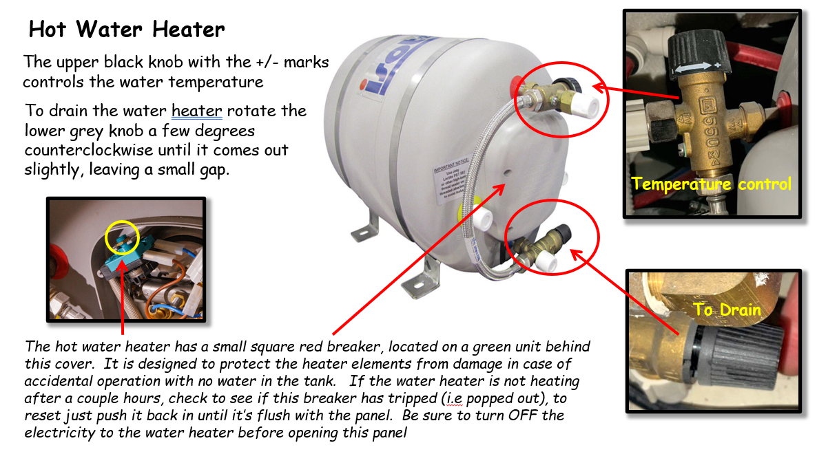

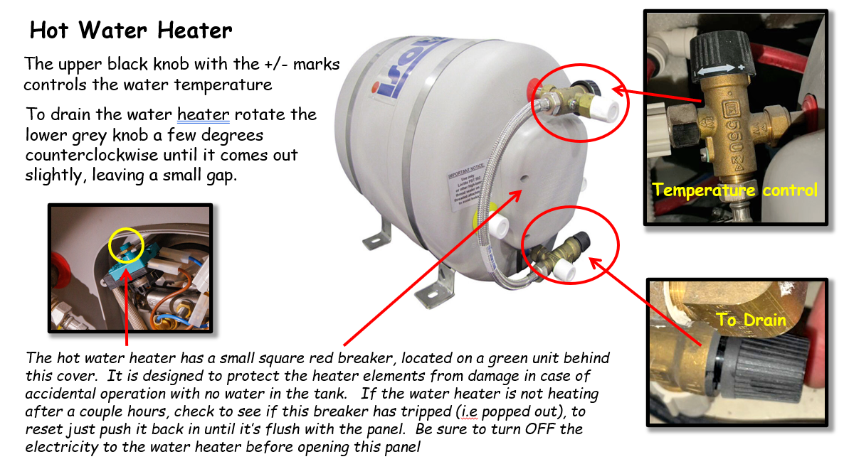

Full tank of water.
Flip breaker.
No power draw (3 hours observed).
No hot water.
Is this self service?
There is a breaker inside the gray panel on the heater that might be tripped
