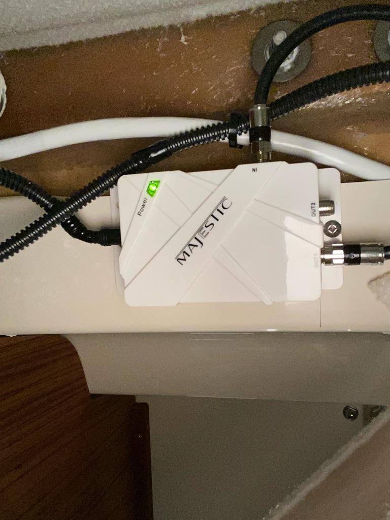

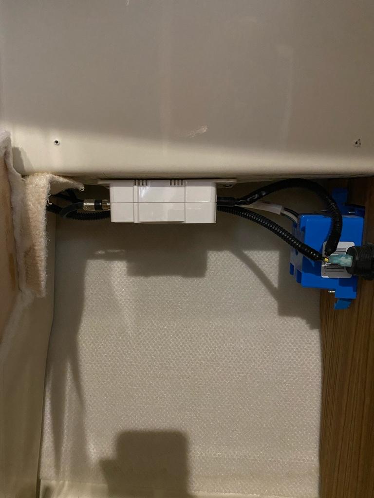

I took a few measurements this morning. The TV antenna amplifier is always on. It is wired into the 12v circuit for the V-berth just before the V-berth usb outlet near the TV. (The duplex usb jack here has an integral voltage regulator that reduces the voltage to 5 volts, like in a car adapter) The 5 amp fuse for this circuit is behind the wooden panel in the quarter berth. The bias tee for the antenna is in a small plastic box behind a small, carpeted panel at the back of the coat closet near the step.
The antenna draws a continuous 0.125 amperes even when the tv is not on. . That equates to 1.5 watts or 36 watt-hours per day. ( or 3 ampere-hours per day).
You could add a switch, or simply reach up in there and pull the power plug out of the bias tee box until you want to watch broadcast TV.

hi tuggers..i just got a used 2021 27 LE ranger ..i found the fuse that will kill the antenna pilot light but i can not find the bias tee...or carpeted panel at back of the closet..any ideas or updated comments. thanks! pat
