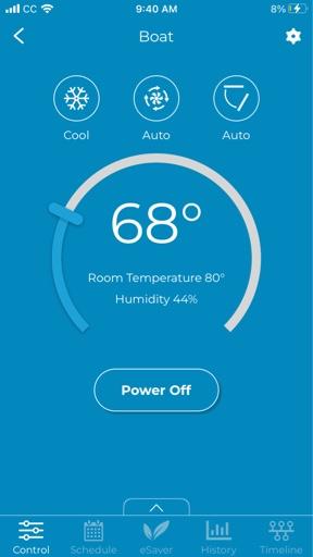

2020 R27 OB—I wanted to be able to turn on the AC remotely, with my phone. I couldn’t find any native Webasto options for adding Wi-Fi or Bluetooth to an air conditioner.
I’m pretty happy with this: https://cielowigle.com/cielo-breez-lite/
The app had a preprogrammed profile for my webasto fcf (screenshot below). The app also layers on a bunch of smart programming options using the controller’s temp and humidity sensors.
My installation was super easy and 100% reversible— I put a 12v socket to usb plug in the cave receptacle, plugged in the controller, and stuck it to the bottom of the panel beneath the AC receiver. I press the app, Wifi goes beep.
There are other options, including building your own w arduino etc, using bluetooth only, but sharing this one cuz it worked well for me and required no effort.
