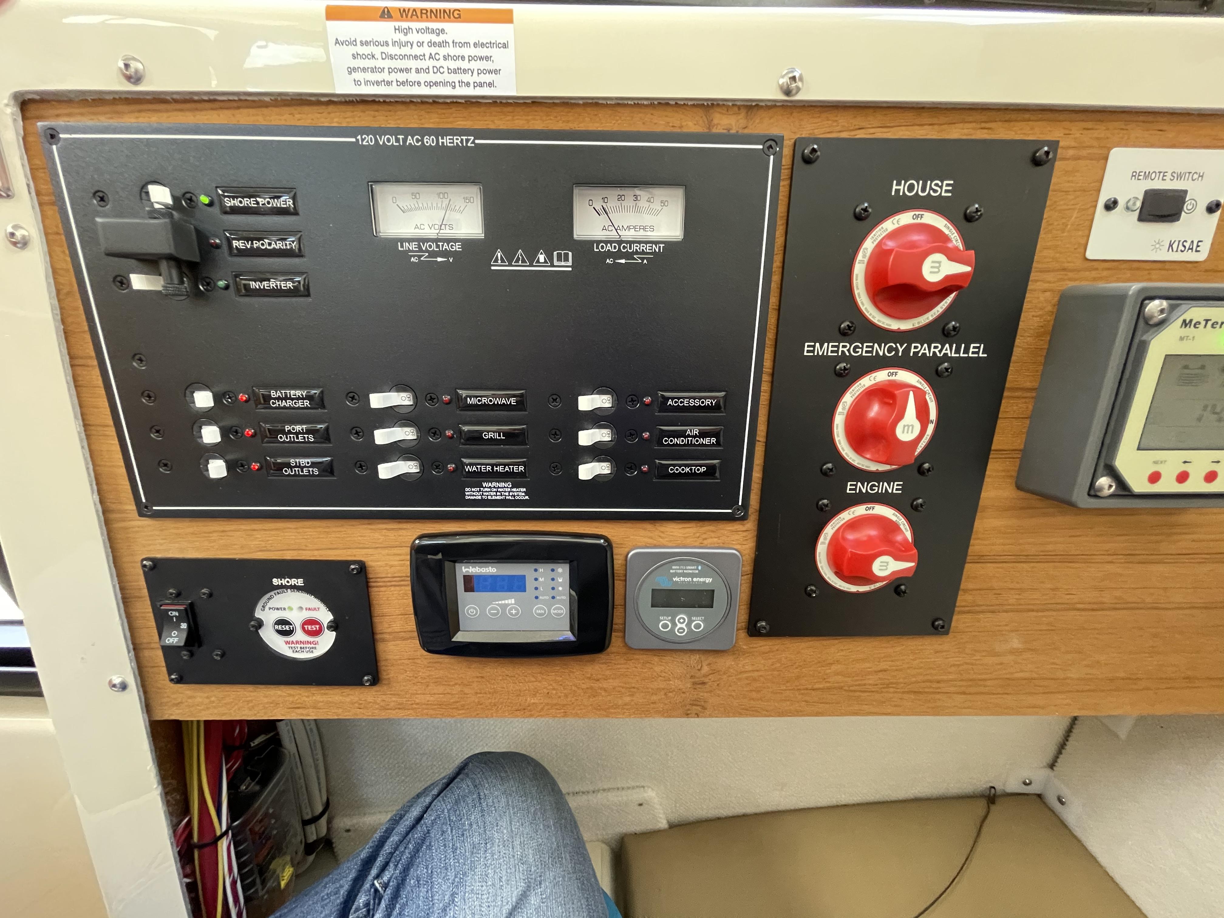

Can not help you with dash install info however we installed the same device on the R29S we sold recently. I mounted it on the cabinetry facing, below the counter top and to the stern of the cabinet drawers. I drilled the appropriate hole, ran the wires down into the cabinet cavity and then back into the port side locker where everything else was connected and mounted. Easy enough to read in this location and I think an easier install.
Jim
Since the battery monitor will only be monitoring house batteries you likely will not be checking it when at the helm. We check ours typically every morning. Any location visible when you are up and about the cabin is best. I chose a location in the aft of the cabin to make running the wires to the batteries and shunt easier. Rather than drilling a large hole in the boat I made a bezel out of teak to mount it in and then attached the bezel under a shelf. The specifics are different for us in our R27 but I sure there is another suitable location as Jim suggests.
Curt
Get the BMV-712 with Bluetooth. I put the gauge at the electrical panel in the mid-berth and have my phone at the helm to monitor while underway. Can check from the bed in the middle of the night. At home, I can check it from the couch (about 50 ft away)

I ordered an extra negative battery cable and added a negative bus. I’ll try to get a pic or video of that I the next day or two. I actually left the monitor next to the shunt for a few weeks while cruising to make sure it was working properly.
Install probably took 2-3 hours.
Hi Dave, great video. Did you add the additional bus because it was needed by the Victron or just while you were at it?
Good question. I needed to move the two connections that are on the new buss off of the negative battery terminal. They were on the same terminal as the bilge pump, and I had to get them on the other side of the shunt.

slightly different but when I mounted a balmar smart guage in the cave berth under the power switches on the cutwater, I was able to run a new cable to the batteries through the bulk head on the starboard side, out a gap into the engine bay and under the lip of the engine hatch with all the other cables around into the battery compartment. no holes were required to be cut.
since then I did add the bluetooth battery sense from victron which has a similar but subset of features as the BMV - love the bluetooth feature. for context my bluetooth battery sense works from the battery locker in the stern port to the helm with no issues.
