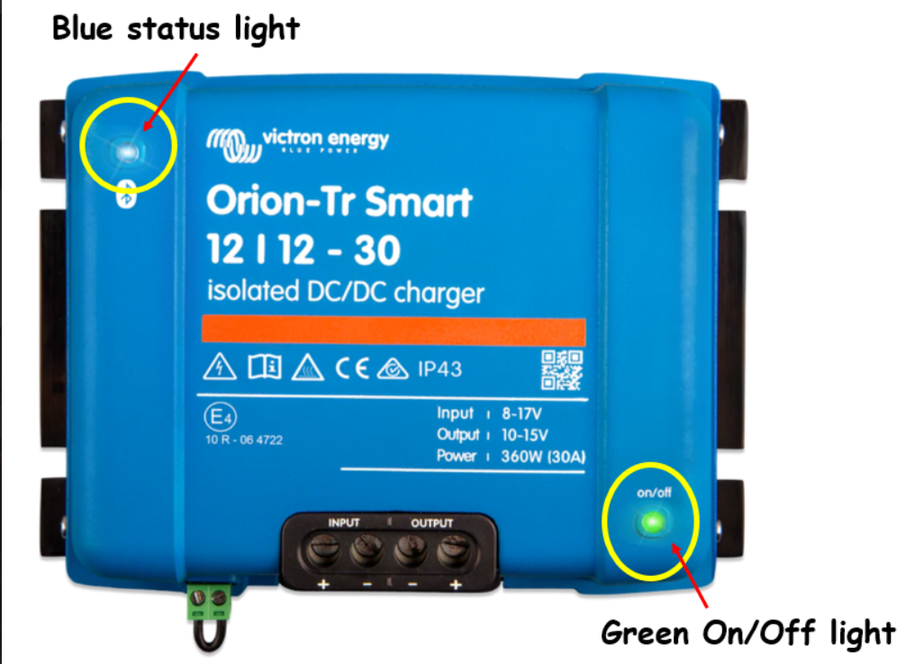

While on that trip we had a problem with the batteries not charging fully while underway. Our R43 has two VIctron TR-Smart DC-DC chargers, one for each engine. When operating normally they each put out 30 amps, for a combined charging capacity of 60 amps.
After being on the hook one day we had our battery state of charge decline to about 50%. We then ran for 6 hours and when we got to our next anchorage it was still at 50%. Hmmm, why didn't the engines recharge the batteries?
We found that the charger on the port engine was not working. The starboard engine charger however, was working and delivering 30 amps. This more or less balanced our normal battery drain due to refrigerators, Starlink, etc. So we were just breaking even.
The chargers have two LED lights, a blue status light and a green on/off light. On the port engine charger the status light was blinking and the on/off LED was not on. My Google search on this condition suggested a bluetooth connectivity problem. I thought, well sometimes smart devices can be reset by turning them on then off again. There is not a switch to do that but I figured I could detach the input and output wires to the charger and that would disconnect the power. I did this and after a minute or two the status light went off (maybe some capacitors needed to discharge?). After reconnecting the wires, the charger started working and on our next run we had the full 60 amps.
This is the charger. When operating correctly, with the engine running, the status light is a solid blue and the On/Off light is blinking green

The little wire loop at bottom left is the jumper that I mentioned above. No need to unscrew the terminal to remove the wire. The whole fitting is a plug that can simply be pulled out to shut the system down. No idea if that would cause a hard reset like pulling the power cable as you did. But it certainly kills the charger.
